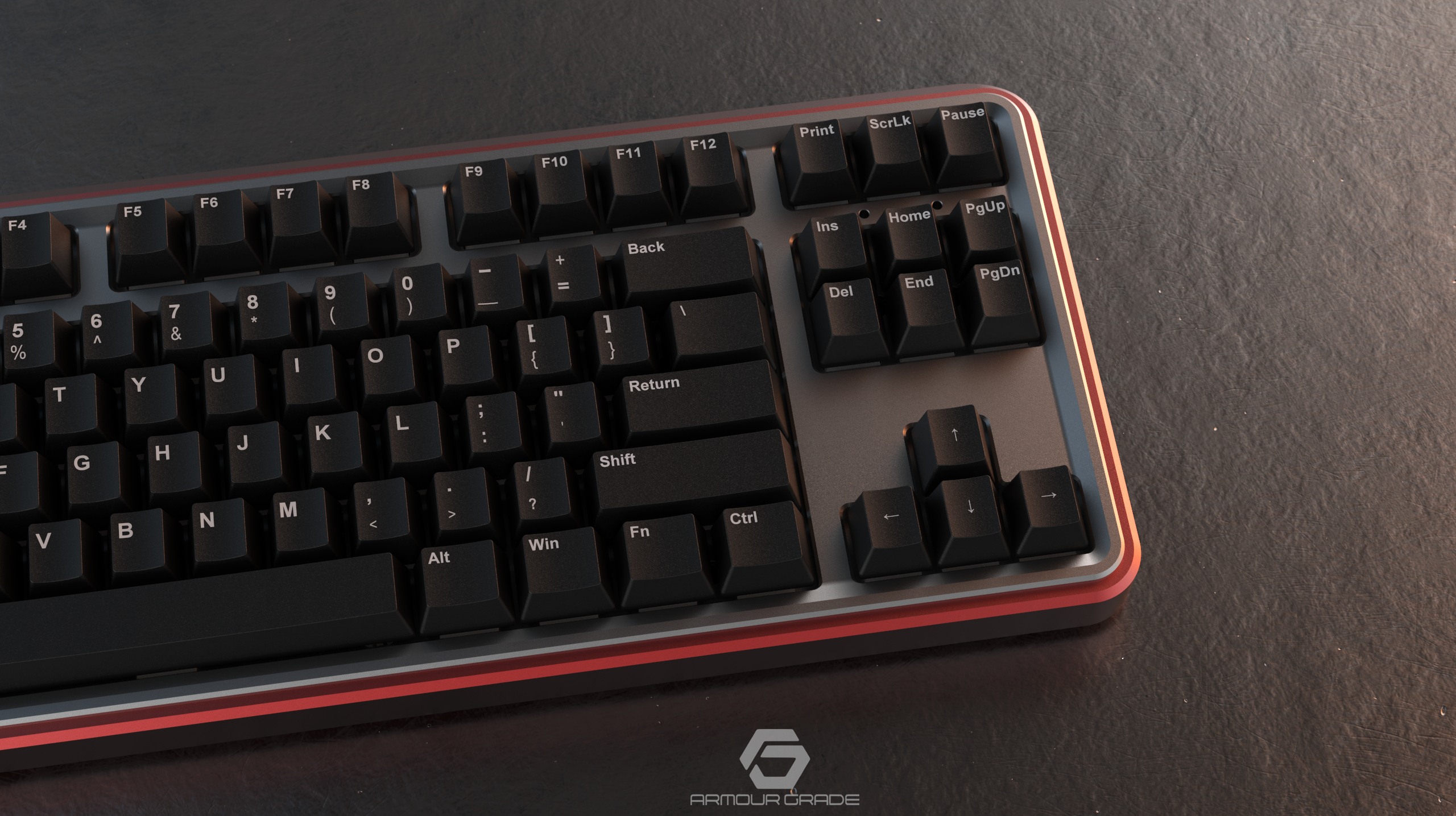

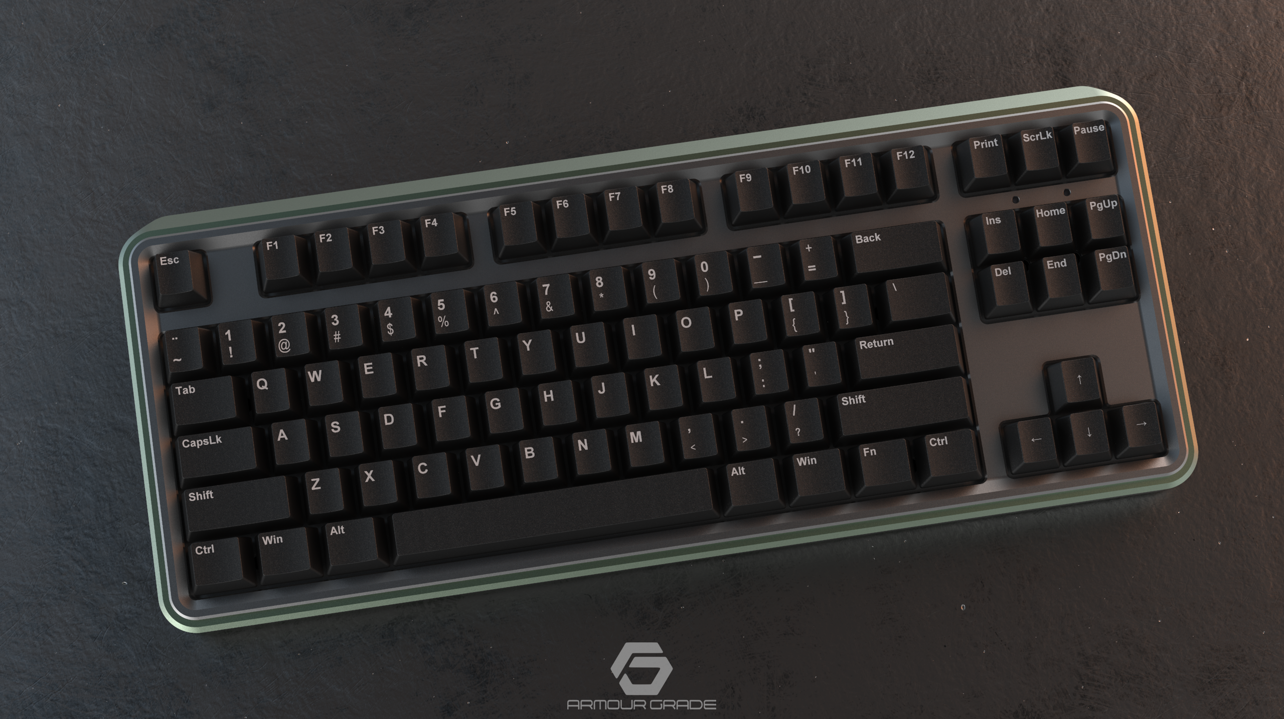

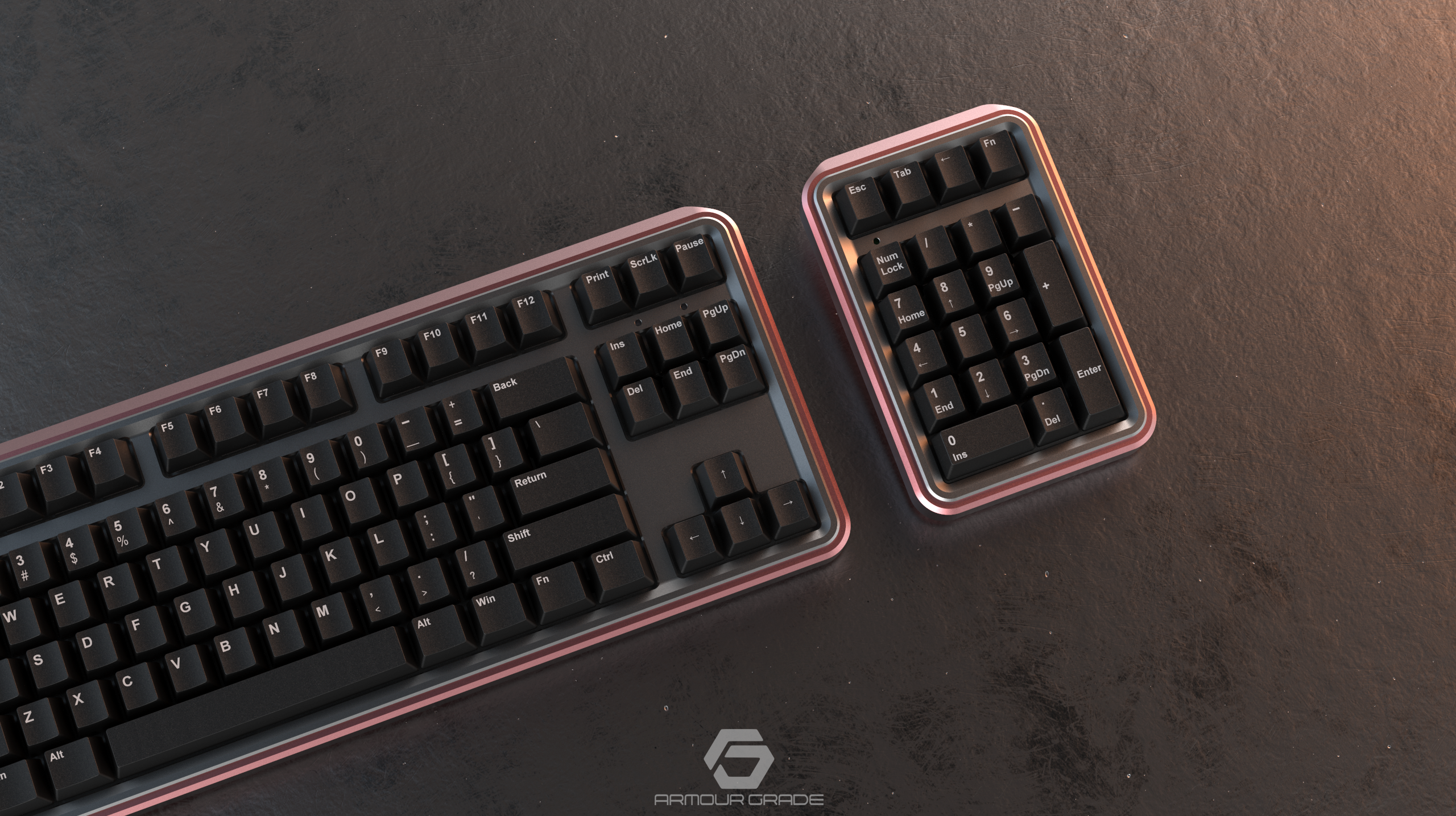

Hello guys I want to show you a project that we've been working on.
Its a tenkeyless keyboard and a numpad.
Key-features:
- tray mount backplate
- 4.5mm thick backplate
- industrial-grade USB type-C connector thats on a separate pcb.
- these are still renders but the alloy that we use on all of our projects is 6082 aluminium imported from Italy. We found out that it has a great finish.
The design is similar to  our 60% keyboards. This project has been in the works for the past 2 years, together with our 60%.
It took a lot of experimenting with ergonomy. We wanted to achieve sharp looking edges without them actually being sharp to the touch. This was done (on our previous projects) by additionally polishing the prototypes by hand and chemicaly treating them in a base liquid.
I'd love to hear your thoughts on the design, questions and suggestions.
If anyones interested we also post other projects on our instagram page: armourgrade

That looks great to me.  :thumb:

Love the design, and having the numpad separate seems like a great idea. I was thinking lately about a numpad which can quickly attach/detach from the main keyboard.
