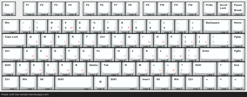

Hi all, let me introduice my layout (third version actually)
the main points is:
  • all Russian letters at their original places (not like at first attempt)
  • symmetrical as it can be done, considering point 1
  • as much covered by regular keyset as possible
the point is that if you don't care about some legends not in place or have all modifiers blank - you can cover this layout.
I appreciate any suggestions from your side about it. Especially from the guys who need EN/RU layout.
I made a prototype with 1st version of layout but I think all these PUP, PDN, INS keys in the middle is much better to use by index fingers.
zErgo version 1
zErgo version 2
zErgo version 3 green marked keys just not in place; yellow marked - not in place and with wrong legend (if you take them from standard keyset)

Since I've been down this particular rabbit hole, I'll offer some suggestions, if I may.
  • Unless you go for an unsculpted keycap set, you'll have a very hard time finding the 1.25u Fn and Tab and the 1.5u Enter keys in the correct profiles.
  • I think that the arrow cluster and the navigation keys work best when grouped together, either in the middle or the right side.
  • Some gaps between the Function row keys often help a lot.
  • The 0.5u symmetric stagger is probably too aggressive, especially for a flat keyboard. I'd consider a 0.25u or have a look at what I've done in the thread that nevin linked.
  • I think that the right shift is too small and too far away to be pressed accurately by a pinky. Same applies to the Bsp keys as well.
  • Well placed 1.5u thumb keys should be large enough for the thumbs, replacing those large stabilized keys in the bottom row and allowing for more and better placed thumb keys.
« Last Edit: Mon, 15 March 2021, 19:05:15 by Gorbon »

Since I've been down this particular rabbit hole, I'll offer some suggestions, if I may...
of course you can, that's my intention to have some feedback and discussion. By the way - did you see the previous versions? Some of your remarks done there separately.
I use now the prototype made with ver.1 layout - I have no issues with 1U shift, however I really use only left one and they done by row 4 keys, so it may helps that they are higher than neighbors
To expand a bit on what I mean with the 0.5u row stagger being a bit aggressive; it increases the distance between key centers to ~1.12u and gives an effective split angle of ~26.6°.
To give a visual example, you are effectively typing on a keyboard that looks something like this.
264519-0
Which on a flat keyboard makes it a bit worse, since in addition to increased finger distances, you also need to raise your elbows while you type, in order to keep your palms parallel to the keyboard and your fingers aligned with the keys.
That's more clear - thanks.
I read your topic. The finger lines you draw there - curved. So does it make sense to define a various step for separate rows? For example - 0.5u from R1 to R2, 0,25U from R2 to R3?
I think so, yes. Fingers have different lengths and curl upwards/downwards non-uniformly. Of course every keyboard design has its own limitations and restrictions, which need to be taken into account.
I think that putting your hands over the keyboard, at a tented and comfortable position (with straight wrists), and following the natural movement of your fingers, would set you on the right path.
obviously while declare your point of view you will push me directly to your solution ))
the important points for me is:
- stay with the rectangular case design, better if out lines will still be straight
- "backwards capability" with the guys who not familiar with a weird boards like wife or system administrator at job.
and i don't personally like those gaps which comes with the .25 shifting
PS: finally I can conclude that overall idea and/or layout not so interesting for the community.

« Reply #14 on: Wed, 24 March 2021, 08:11:23 »
Going deeper in the option of different shift between rows I have this version:

Yes, I like this one.
I think moving the right thumb-shift one key to the right, would probably make it better placed for the thumb.
Apart from that, I don't think you can do much better with just a 104 key set (it's a big constraint) and I still maintain that it would be best to use a single profile set. Mix and matching sculptured keys from different rows is often not optimal, especially placing bottom row keys on the the top row (e.g. that 1.25u key under Esc), would look and feel… wrong.

« Reply #16 on: Mon, 29 March 2021, 04:56:19 »
Actually this one done not at the base of standard 104 key set, but on this one from AE which is definitely wider one..
I am agree that it's easier with non sculptured keys. Of course.
I will try to make new with only 104 keys and see if that possible to make something similar.
Any other comments?
