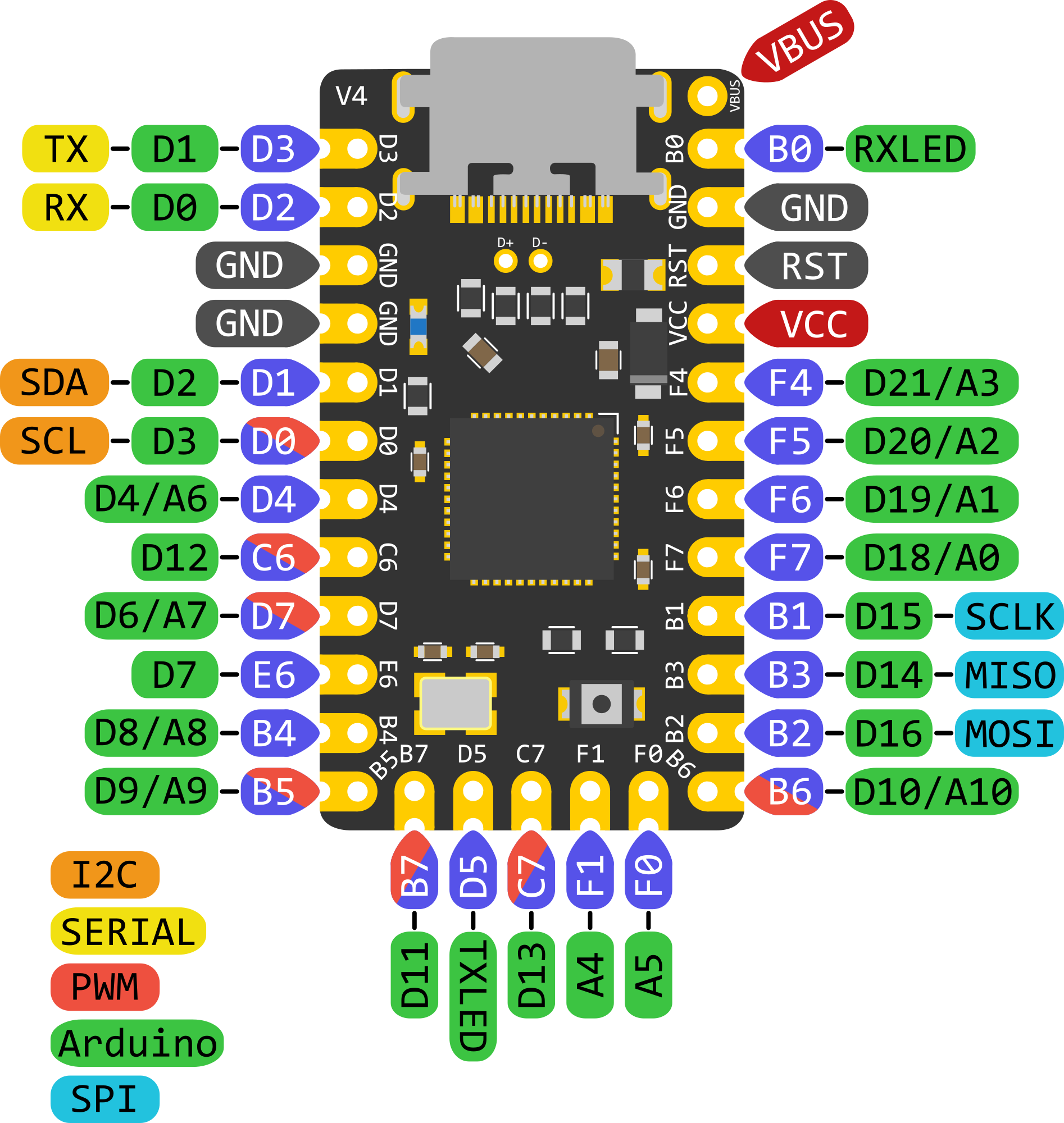

Thank you! Yes, the acoustics were surprising to say the least considering the jury rigging involved. Will try and see this weekend - chuck in the OLED and the RGB on a test board and go from there with QMK. At the moment I feel really lucky the layout was 12 rows + 9 columns and that left exactly 3 pins free out of the 24 digital I/O, exactly enough for the OLED and the WS2812. Unfortunately I did use D0 which is SCL, so I'll have to move that to D2, wire the OLED to SCL, SDA, GND and VCC and use D3 for the RGB control.
