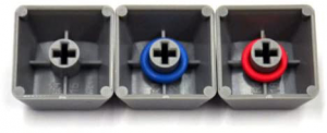

Would you pls elaborate more on how to limit the MX switch travel distance ?
the oldest and simplest method is just adding orings to the underside of the cap. which also makes them a little quieter when bottoming out. though it does nothing for the stem return sound (when the stem hits the top housing).
- depending on the cap you can add one or many. one is usually good for caps that have a decent "cross" connecting the cap to the stem (as pictured below). others that are totally smooth all the way down (signature plastics caps) i've used up to 3 before it starts impeding on the actuation (cap not letting the stem travel down far enough to actuate the switch).
- it's a simple, cheap, adjustable & reversible trick you can try. add orings till the switch won't activate anymore, then take one oring off.
- they also come in different hardnesses, so you can play with the feel of the bottom out (softer or stiffer)

some brands/models of switches are intentionally made with a higher activation point, so less travel before the switch activates. i know they exist but i don't remember which switches they were.
.... eh, i went back and searched, here's a couple to look at (and i'm sure there's many more)
the "speed" switches are the ones with the shorter travel distance until actuation
- cherry mx speed silver - Linear, 1.2 mm pre travel, 45 cN operating force

« Reply #15 on: Wed, 05 May 2021, 07:34:22 »
267772-0
