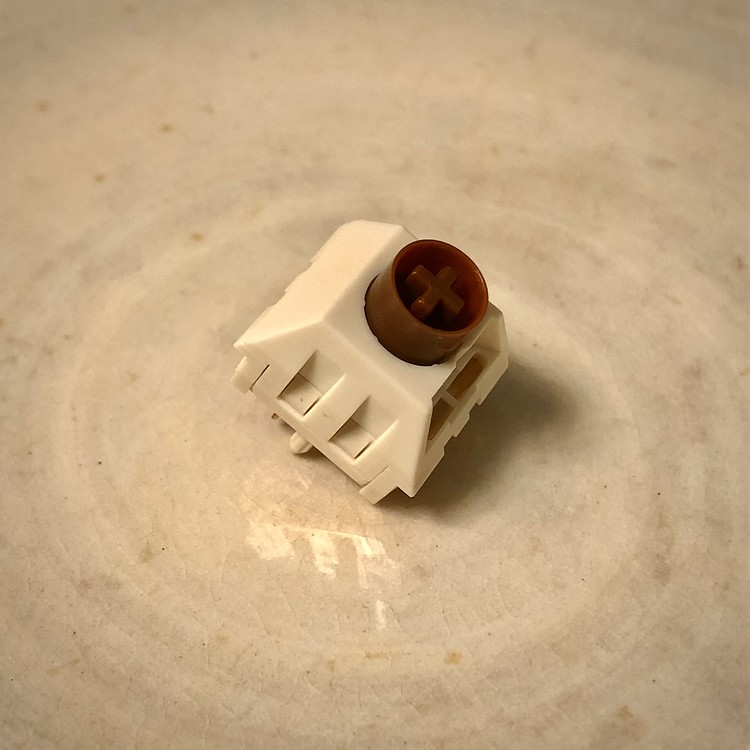

« on: Sat, 03 July 2021, 17:35:55 »
Overall I'm a huge fan of the Kailh switch lineup.  They are reasonable in cost, many have shorter travel distance and great tactility.  I've been looking for a new daily driver that would check off all of the boxes that I would desire in a board.  I've purchased about 6 or 7 different switches and have been trying them out in my hotswap board before I commit with hot lead.  Between de-soldering original switches, lubing new switches, and re-soldering;  although I didn't time it , I'm sure it was 7-8 hours total time.  The switches are mounted in a Leopold FC660M.  I did not lube the tactile nub on the switch housing.  The design is unique and when the stem makes contact with it, it actually slides away from it into the switch housing.  The nub rests against the metal leaf and this is what creates the tension for it.  It comes already lubed with a thick grease and I did not alter this.
I am kind of disappointed overall.  I like the shorter travel distance, the higher actuation point, and the sound profile, and the weight.  The upstroke as well as the down stroke is sileneced- and it's pretty darn quiet.  It's akin to the quietest rubber dome board I have ever used.  While it sounds a lot like a rubber dome board I used to own, it also feels like it (If I can find the model number I will post it).  The switches are silenced at the expense of tactility and the switches are really quite mushy.  They are really missing the sharp tactility that the original box browns have.  I also find that I am having a lot of typing errors because I am not getting the same feedback. I am going to force myself to use it for a while.  It may actually grow on me.
I had put about 10 switches in a hot swap board and used them for an evening and thought that I really liked them.  This goes to show how you truly need to use a switch on a full board in real-world conditions before coming to a conclusion about it.
I've attached a video so you can at least hear it. I would love to hear reviews and feedback from others who have used the switch.
EDIT- Unfortunately my internet is acting up and I cant post the video/sound, but I'm working on it.

One solution is called "Cookies and Cream." You take the BOX Silent Brown stem and put it in a BOX Cream housing, using the BOX Cream spring as well.
The reason for doing this is that BOX Creams use a linear leaf instead of tactile. So the tactility is less. And the spring weight is close to MX Brown. So you can get a switch that is closer in some respects more like original BOX Brown.
I have tried this, and the combination works from an operating standpoint. I found that they were lighter or less tactile, less likely to harsh bottom-out, while still being quiet. I didn't build more, it's expensive and I have better silent switch options. But that's seriously something you might want to try if you are 'almost there' with BOX Silent Brown.

Here, this is your saviour:
Cookies n’ Cream
    NK Box Cream housing & spring :icecream:
    Kailh Silent Box Brown stem :chocolate_bar:
    More quiet, deeper sound - virtually no ping :sound:
    More moderate tactility, like reg. Box Brown :brown_heart:
Like a mild Silent Box Brown, but better.
