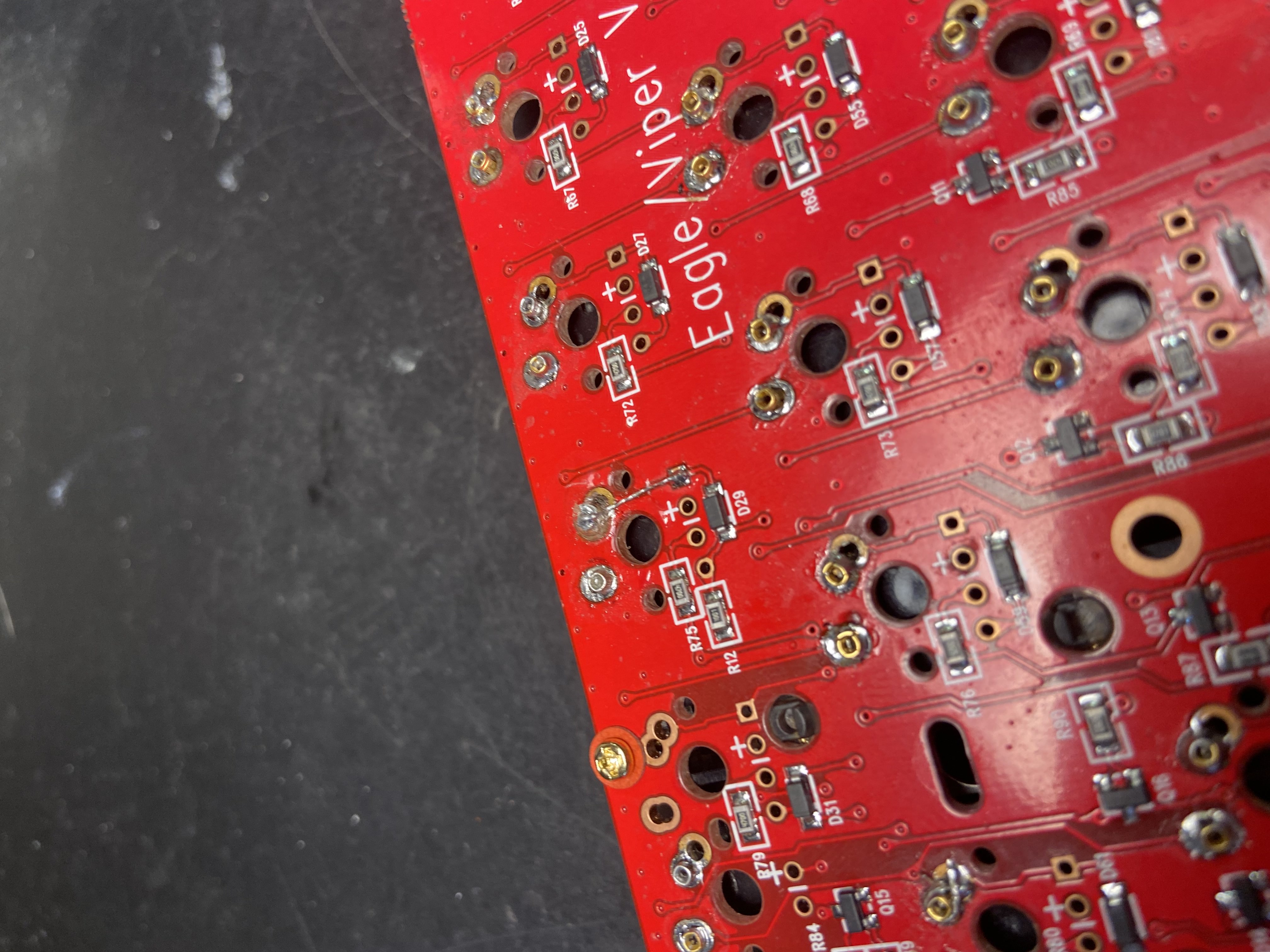

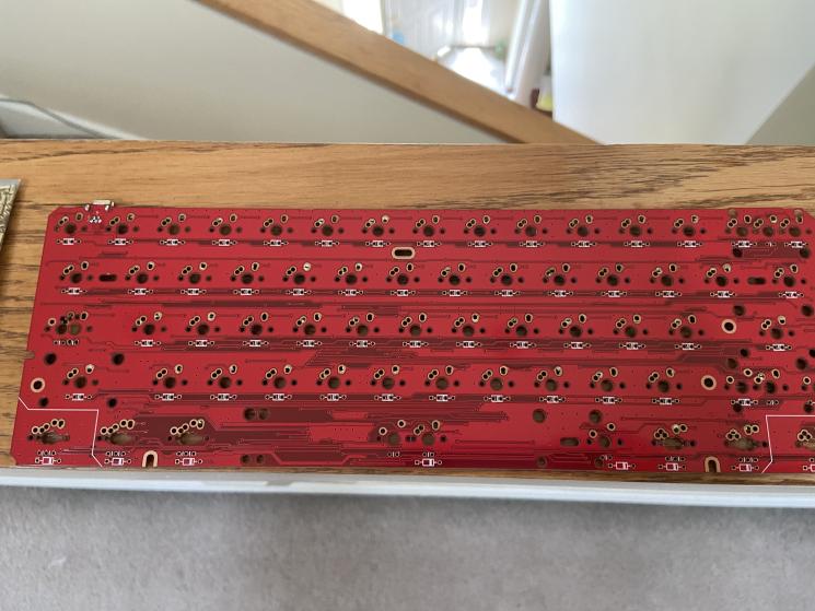

PCB: Duck Eagle/Viper V1?
* This PCB was sourced from an existing build.  Someone sent me it, and it didn't work.  I had to desolder the whole thing with lead-free solder.  This was a pain, and caused me to muck up many pads.  This, along with the already suspicious design of this PCB, it was not in good shape to start.  The micro-usb port was also wiggly, so that will also have to be fixed.
* This is the same kind of PCB E3Eves used, meaning it has the same layout limitations.  The alps holes are not 1:1 with the cherry holes, and the only supported layouts were those with a (sort of) 101W layout (1.5-1-1.5-7-1.5-1-1.5 bottom row) with two potential positions for the caps lock, and a split backspace key.  As to not disrupt traces and make more work for myself, I worked with the existing ALPS layout.  This will come in handy during the drilling step in a bit.
* So supposedly this PCB is the V2??? It even says so on the back.  However, 02D only works when I flash it with the V1 map, and I can't flash QMK because it only supports the V2 version.  I suspect this PCB is an imposter, but I could just be an idiot.

PLATE: Kprepublic's Stainless-Steel 60% ALPS PCB
* This plate arrived BENT and I had to muscle it back in.  It is a good plate though, and fits the switches well (but it doesn't fit them so tight that I can't remove them for hotswapping).
* The bottom of the board supports multiple layouts.  This will create wobble as the hotswap sockets aren't THAT tight.  If someone replicates this mod, I would highly recommend finding a plate with individual switch holes.

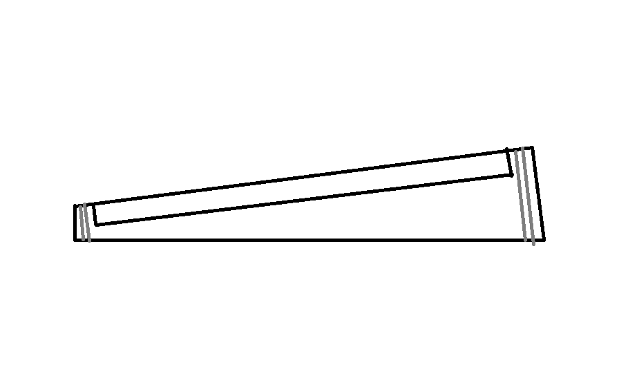

CASE: Duck Raven
* This thing is amazing.  It has Duck's clean design, without the shine through on the back.  It is basically a Tofu with a steep typing angle.  PERFECT!

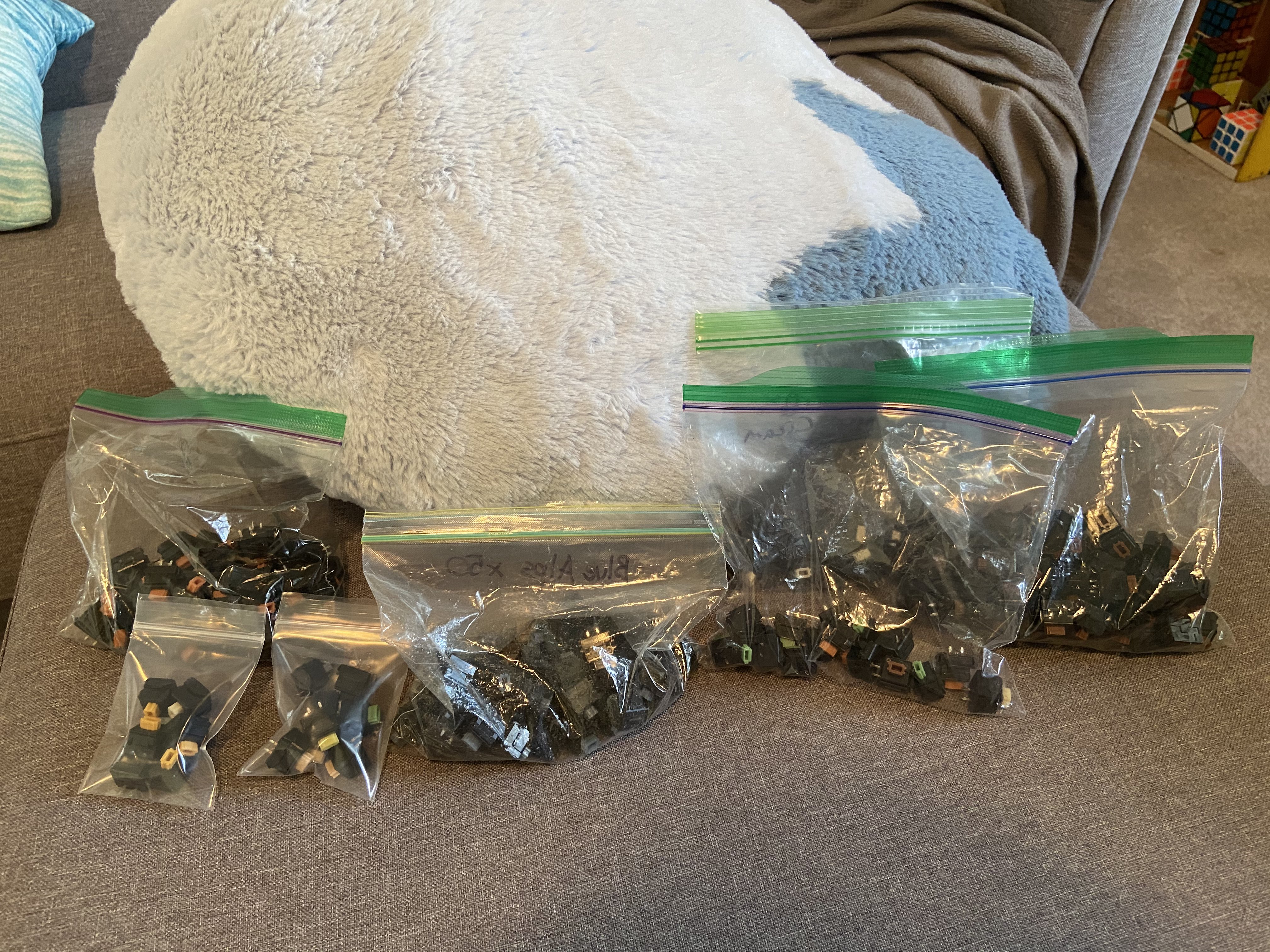

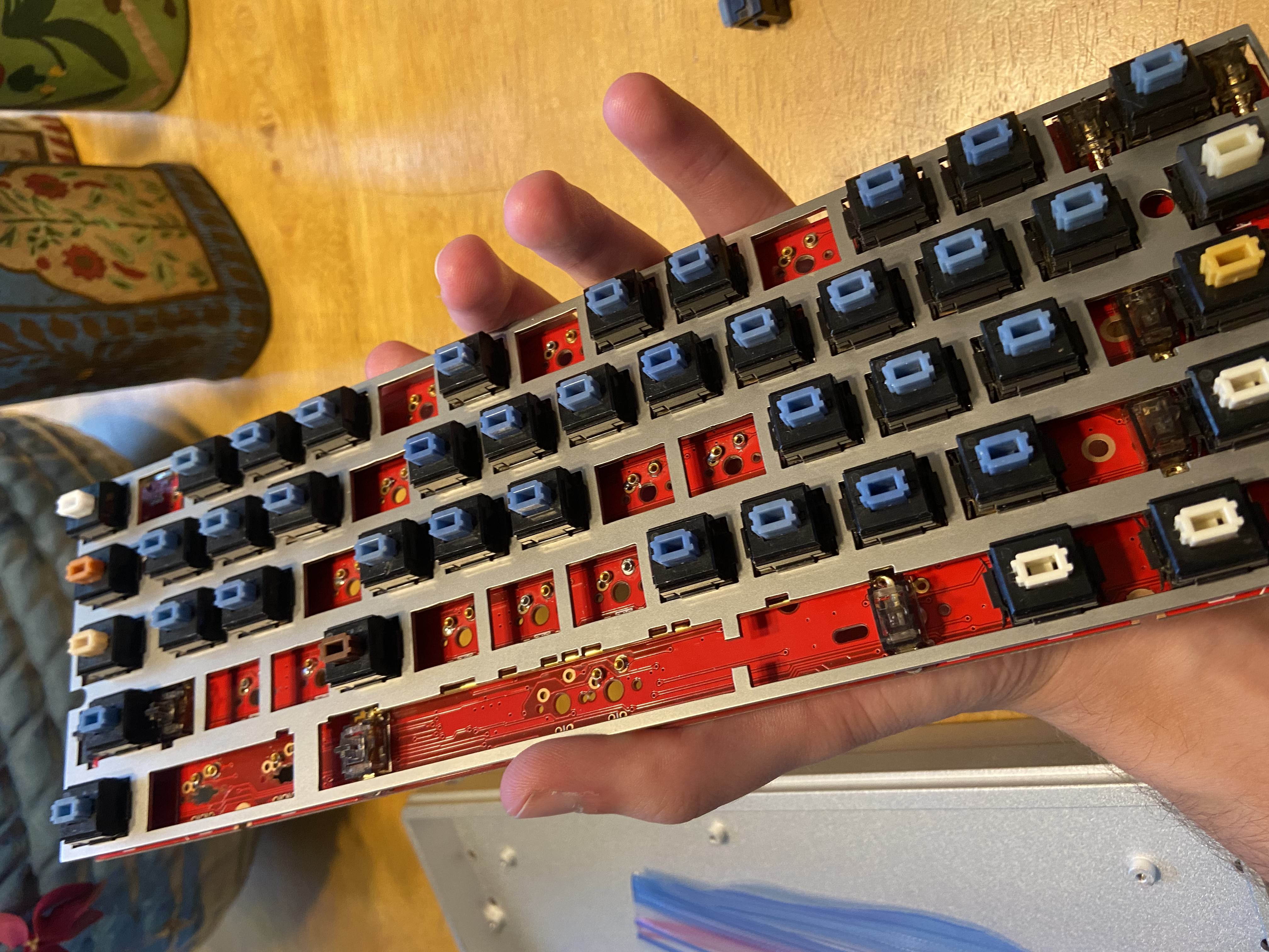

Switches: SKCM/SKCL ALPS
* After trying many different MX switches (around 40!) I decided I liked the feel of ALPS more.
* This isn't even my full collection.  The only missing switches I am currently looking for are neon green, SKCL amber, SKCL grey, and SKCL striped amber.  If anyone knows where to get individual switches of these so I can complete my collection, LET ME KNOW!!!
271982-5
* This was the layout I ended up going with.  The right control is undamped cream, the right OS is damped cream, and the escape is white damped.
* I can give you my opinion and recommendations on the ALPS variants if you ask, to the best of my ability.

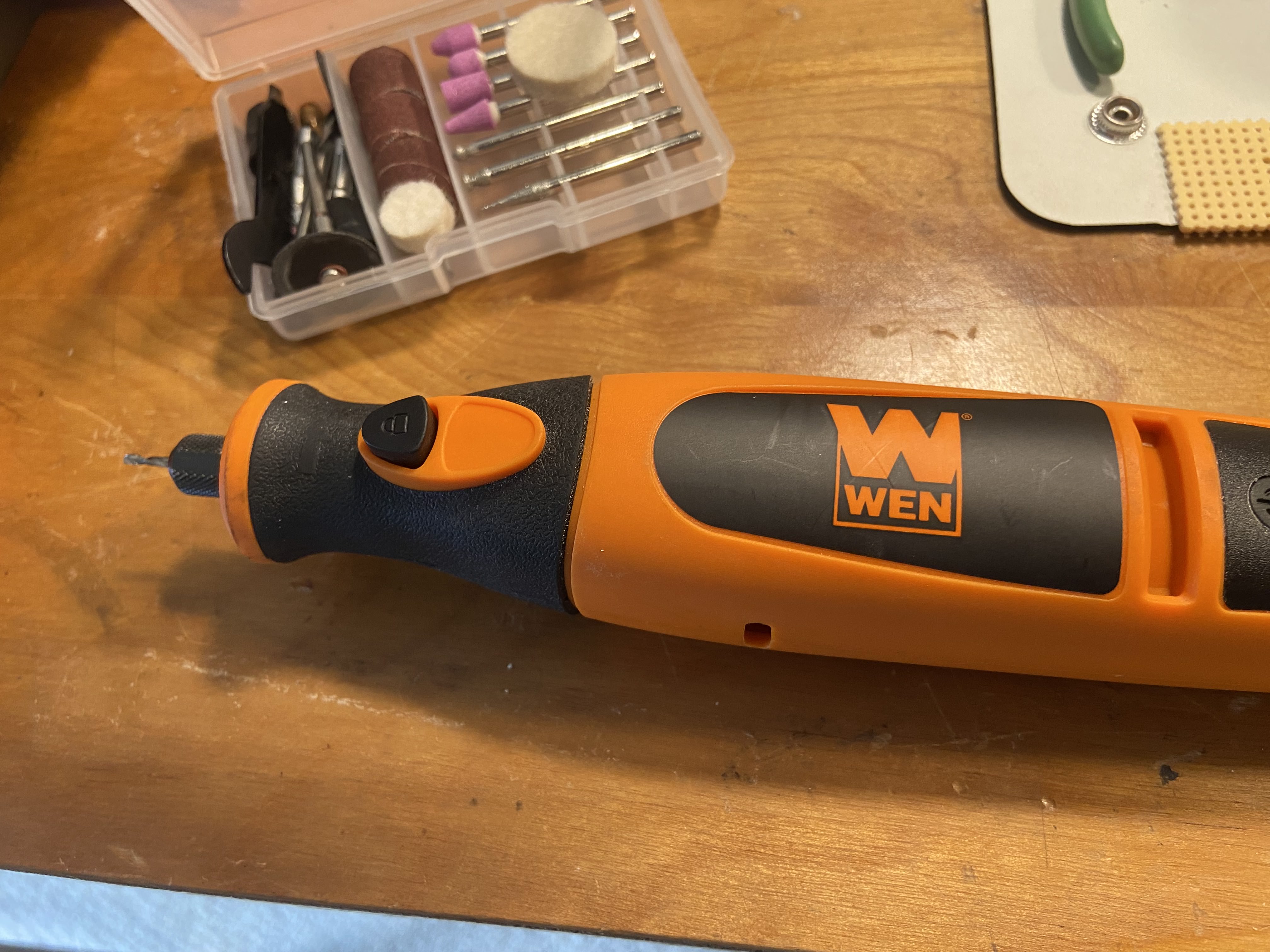

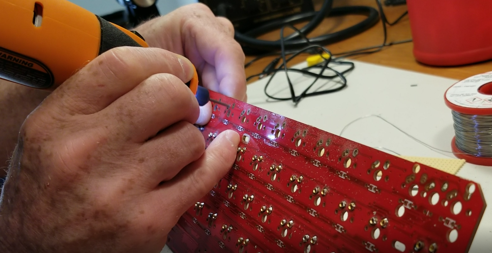

Making this damn board hotswappable
So, the pads on this board are too small to fit the sockets normally.  To normally install mx hotswap sockets, you just press them into the pads and add a little solder.  There are two alps pcb's I know of that have wide enough pads for such a process.  These are the filco replacement PCB from LFKeyboards, and the KingSaver PCB.  If you don't have one of these two, you need to break out the drill.
271988-8
This drill to be precise.  You can get it for less than 30 bucks on amazon.
So the pads need to be drilled out to a VERY specific diameter.  This has to friction fit the sockets, yet not be too big.  Although the sockets are rated for a 2.08 mm hole, this was measured on a stiffer material.  This PCB is much softer, and a smaller hole is required.  A 1.81 mm drillbit was used (a low tolerance 1.85 bit from amazon measured with a digital caliper).  The ideal range is 1.75 mm - 1.81 mm, but going as large as 1.83 can start to mess things up.
Given that the pad is being drilled out, there should be still some pad remaining after the drill runs through.  The drilling takes place entirely within the pad, and shouldn't interrupt any electrical connections (at least not on this PCB).  The exception to this is the caps lock, which I will get to.
271990-9
After friction fitting the sockets, a tiny bit of solder has to be applied to the outside of it to make it stable.  The real challenge is here: not getting solder in the socket.  The solder is very hard to extract, and there are slits in the side.  Even a small amount can mess up the switch fit, so buy extras if you are going to do this!

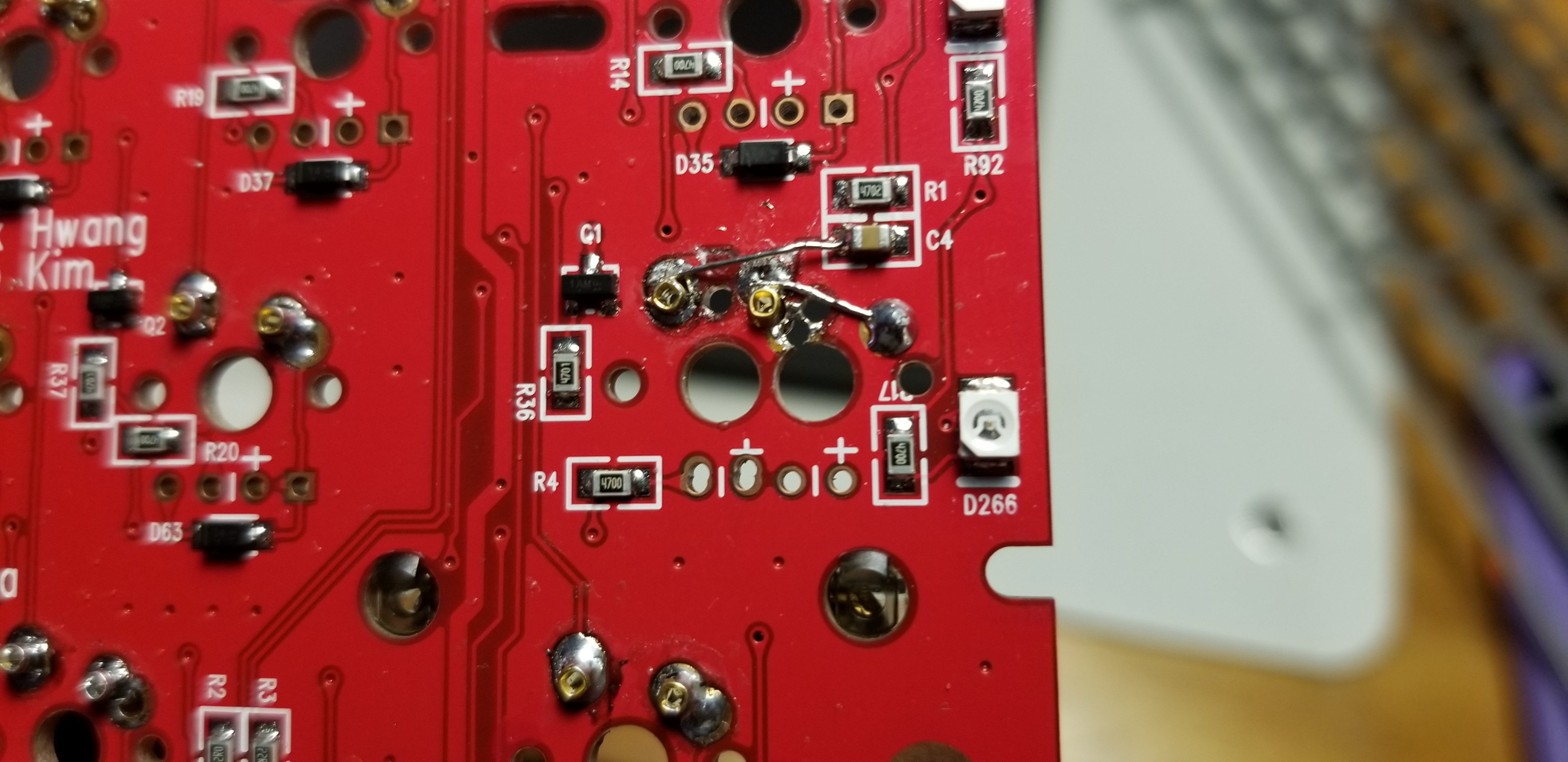

Here are some oddities:
One of the pads I screwed up when desoldering became an issue later.  When the socket was seated, the electrical connection had to be restored by wrapping around a little wire with solder:
271992-10

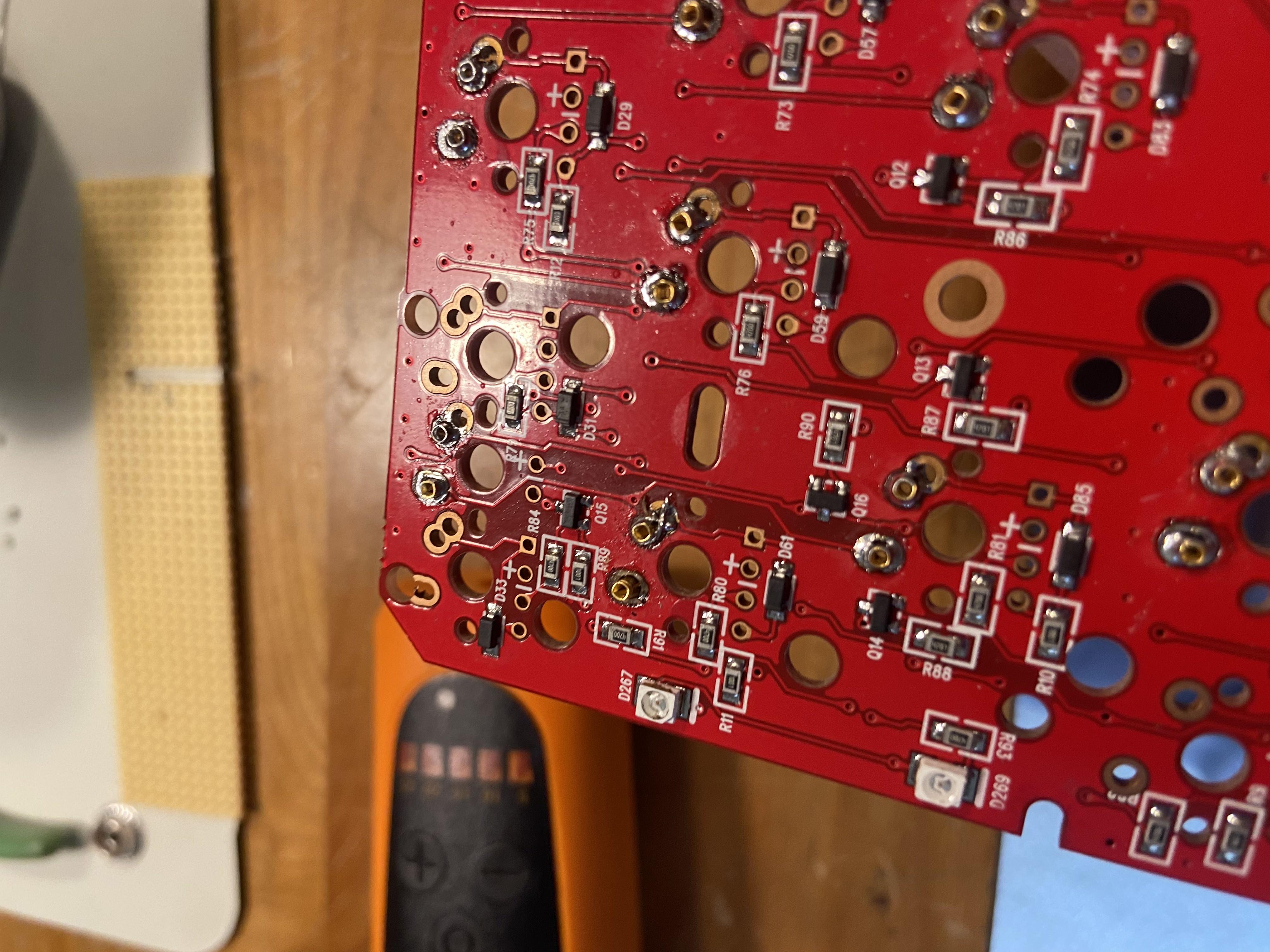

Another one required an electrical bridge:
271994-11
And the caps lock key was wack.  This is due to the multiple supported alps layouts in such a tight space.  Knowing what needs to be bridged to what, this modification can be made:

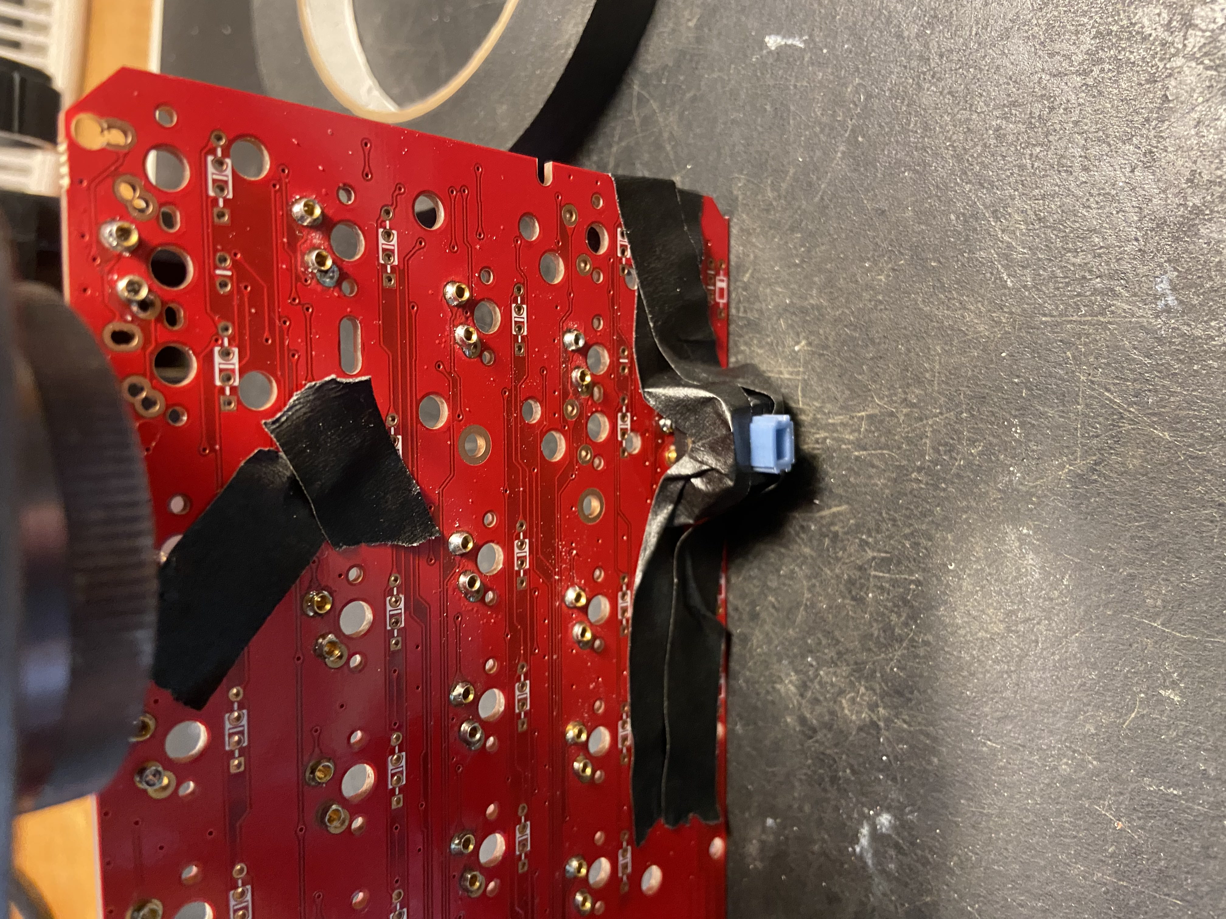

If the hole from the drill ends up being too wide to friction-fit the socket, tape, a switch, and epoxy can be used to position the socket so it can later be soldered.  Again, this is kind of a make-shift solution, as the epoxy will quickly melt.  There has to be a substance that holds up under high temperatures but can still leave the sockets in place.
REMOVE THE SWITCH BEFORE SOLDERING please.  If any amount of solder gets in the socket with a switch in, it will be stuck forever.

After everything is fit in place, you can stick switches in the sockets, plug it in, and test it.
After that, install stabs, plate, and then start popping in the switches!
272000-14
Just a little bit of force and the ALPS fit right in! They will float above the PCB a bit though, but this stainless steel plate keeps them perfectly stable.  Be careful to not snap off the wings! All it takes it a little wiggling and each switch will pop right out.  This does create a bit of wobble on the bottom row where the switches aren't touching metal on all sides.  I'll think of a solution some day.
