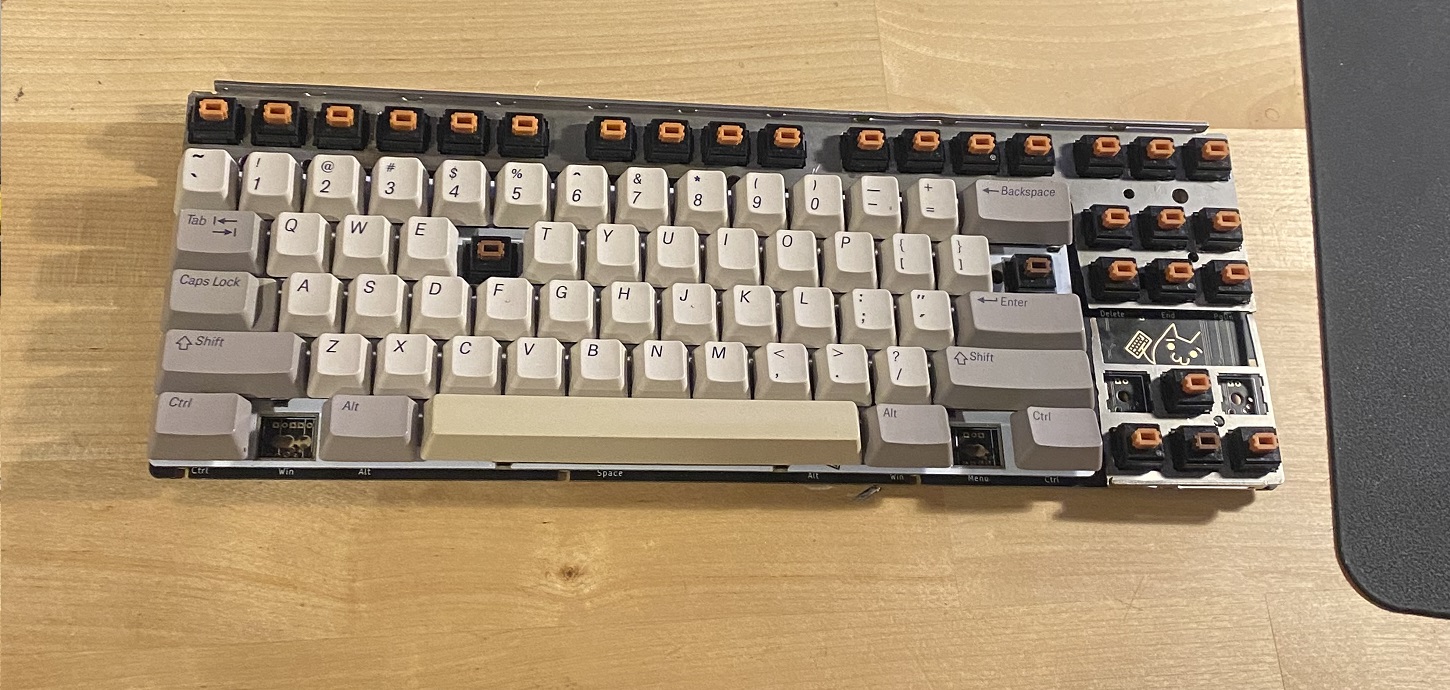

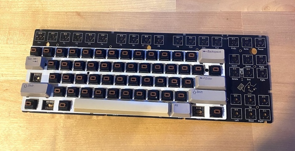

First I fitted the 60% Plate, soldered the SKCM Brown switches and made sure the stabilizers were working well

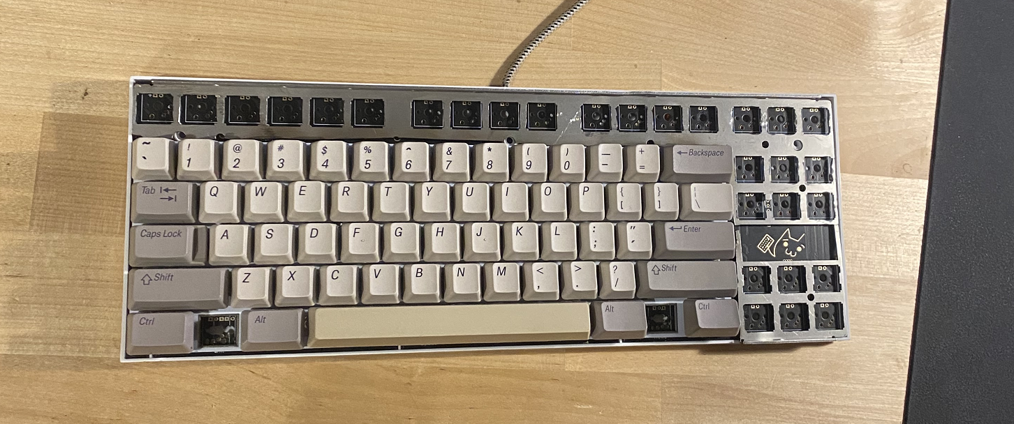

Second I cut out the 60% portion of the XD87 TKL  Plate and hand filed Cherry MX openings to be just the right size for Alps switches

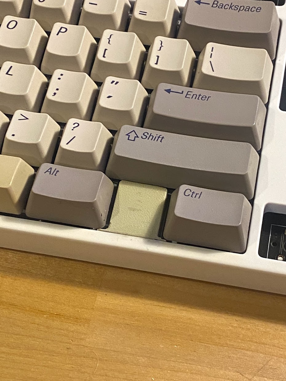

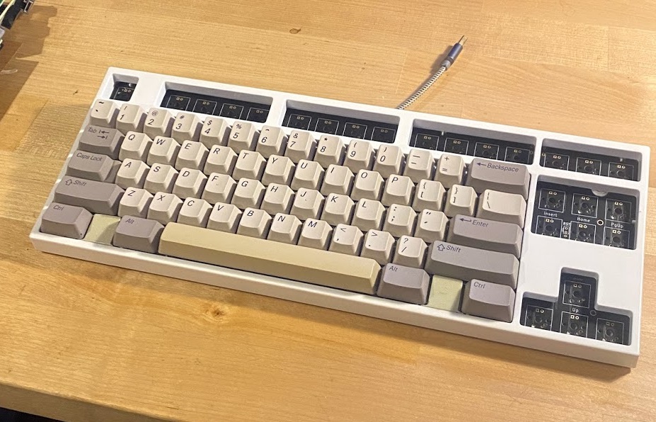

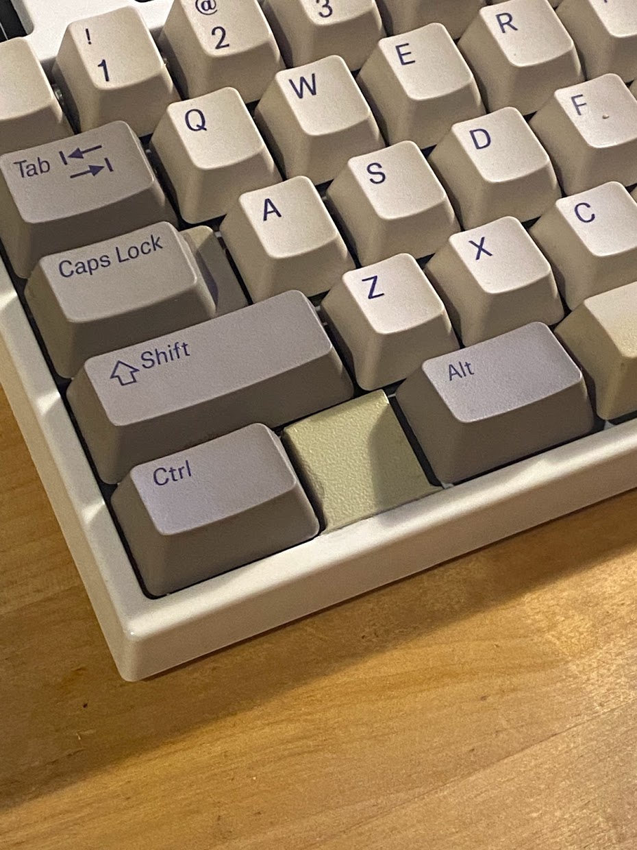

I really wanted to make this Winkeyless so I decided to add some home made blockers to the XD87 case
273906-3
273908-4
273910-5

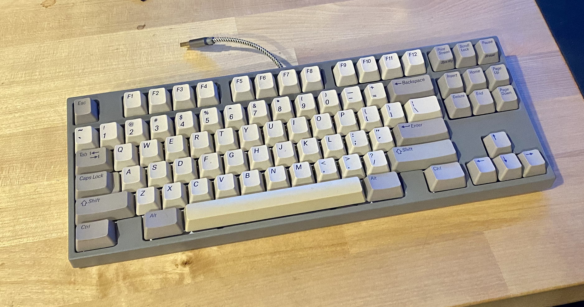

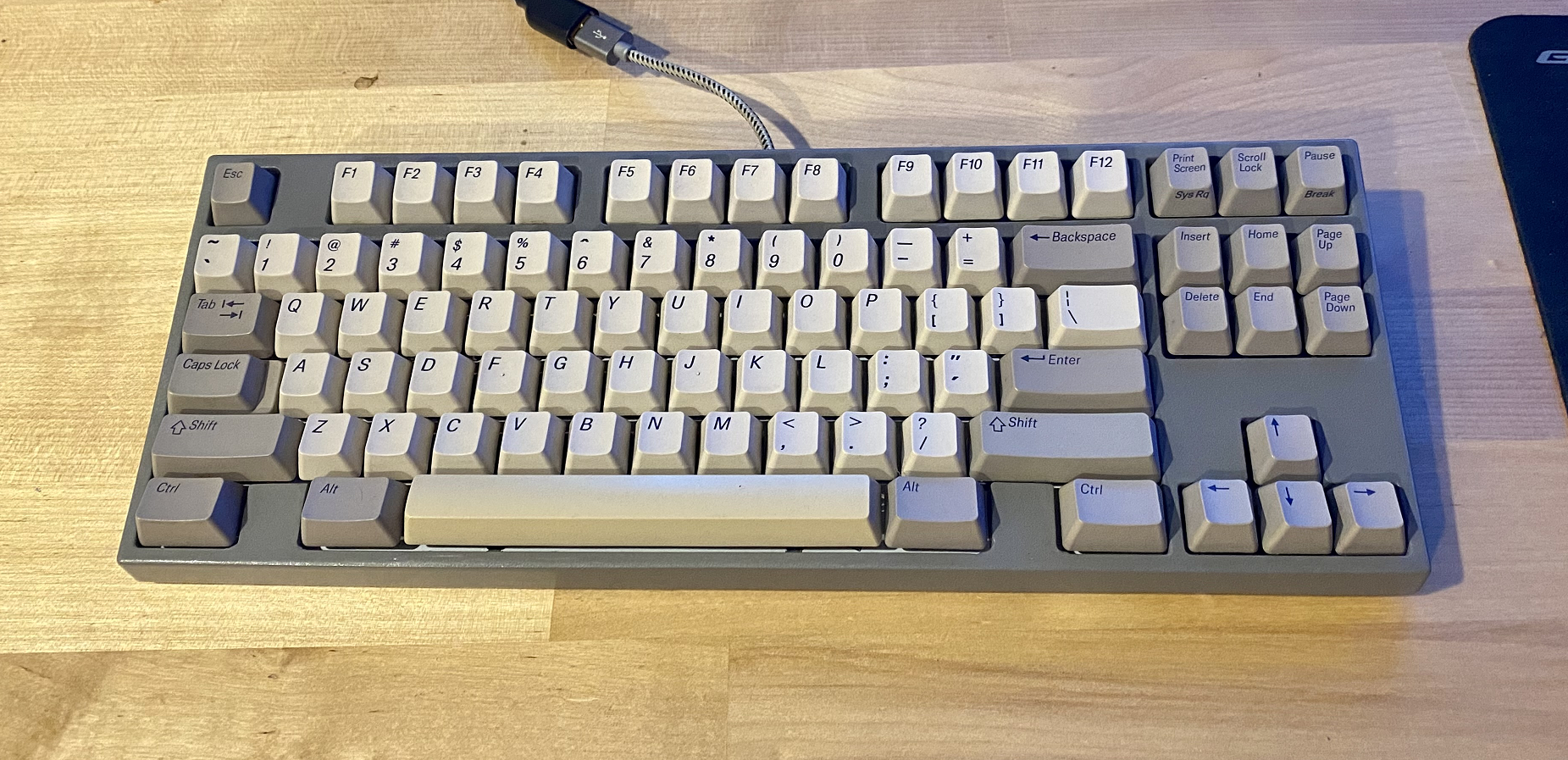

When at the store deciding what to paint the case, I saw a can of 'Granite' spray paint. So in order to compliment the SGI Granite keycaps I chose this color. Here is the finished project.
273902-6
273904-7
