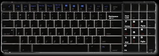

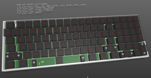

Hi, I'm considering building a keyboard from scratch.  I got bored over the weekend so I threw together a design.
I would use cherry mx black switches and an atmega32 in 44-tqfp with the aikon firmware.  I'd like to use some of the extra pins (I'm only using a 12*8 matrix for the 95 keys) on the atmega32 to control the backlight (lock keys implemented with dual-leds), but I'll have to get in contact with iornate for that.
I would like to use this layout :
Here is a render of the keyboard (altium designer is the design software):
I have some questions:
1) Where do I find keycaps?
2) Input on the layout/design?
Random question: What happens if water gets on a cherry switch?  Can it just be hosed off and left to dry?

Backspace and Enter need stabilizers. Have you got the spacings right? It does not look like much space in-between the switches.
Are you sure that there is no existing keyboard that has this layout, that it would be easier to get? An older MX1800 would be quite close, but with cursors keys and perhaps too much space to the function row. There is the gamer keyboard with MX1800 layout with NKRO and black Cherry switches, but with Windows keys in the bottom row. Then map the Fn-combinations in software.

« Reply #3 on: Tue, 31 August 2010, 09:12:27 »
Most of the motivation of it is for the sake of building it myself.
As for the spacings, I'm pretty sure I have them correct.  The switches look big in the 3d render because altium doesn't have an easy way of making a good 3d model. The 3d model is just made of a couple extruded rectangles based on the maximum dimensions, so they look larger than they really are.
I'm not sure if I can put a stabilizer on enter.  While stabilizers do fit under the key (.94" between the stabilizers center-center distance), the body of the stabilizers end up being fairly close to the adjacent keys and I'm not sure everything will fit.  I'll put holes on the board but may not be able to populate them.
Backspace is the same size as a standard tab key in my layout, so no stabilizer should be needed.
Thanks for the input

« Reply #7 on: Tue, 31 August 2010, 12:31:58 »
Quote from: cirthix;218501
Now I see it. The keys in that column are longer in the first picture than in the second.
