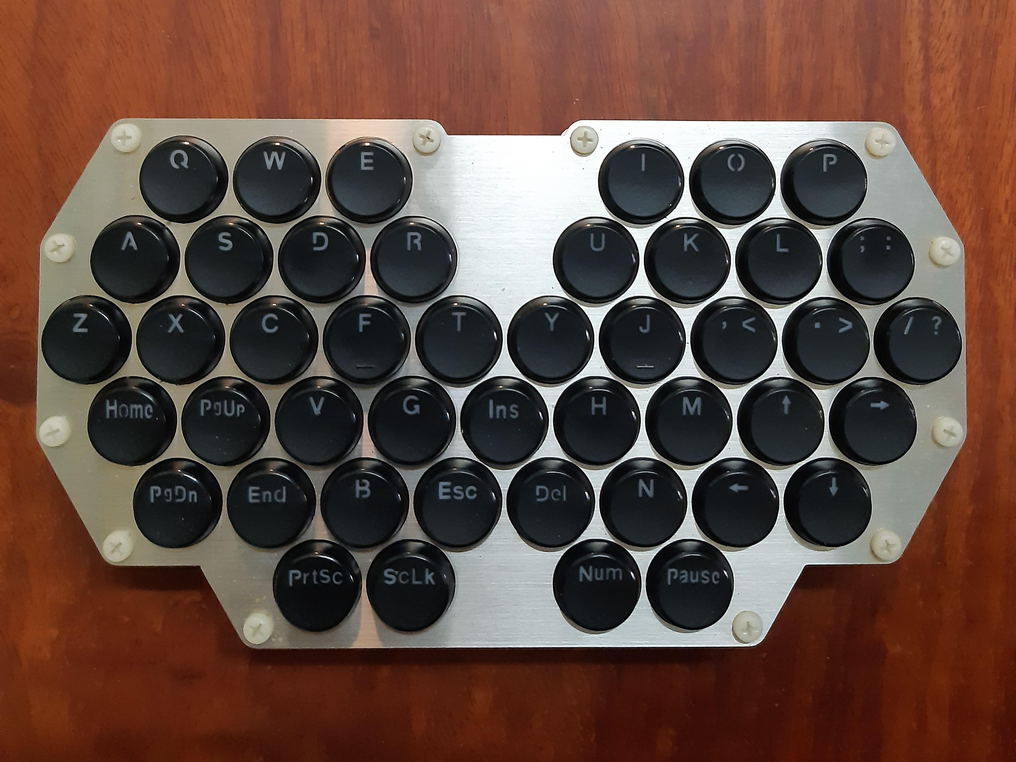

Last year, I ordered a 44-key Atreus (a keyboard initially funded by a Kickstarter project). While I was waiting for it, I came up with an improvement: the Forever Ambre.
279023-0
(A picture showing the two keyboards side by side is attached at the end of this post.)

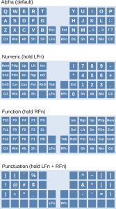

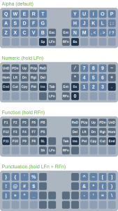

Keymap
The following keymap, conveying all keys of a standard keyboard except Menu, Caps and Num Locks, is for the Atreus which I'm using as the daily 'driver'. It can be translated into the Forever Ambre in an obvious way. Extensions, such as adding the Caps Lock and (sort of) Num Lock key or adding (up to 18) symbols are straightforward. The QWERTY version is presented for consistency with photos.  Actually, I use Dvorak simplified keybard layout.
EDIT 2025-9-22.  Actually, I use a light-weighted modification of the Dvorak layout, where the L, X and B keys occupy the usual position of the comma, the dot and the semicolon.  Layout diagram is attached at the end of this post.
313860-1
EDIT 2025-8-1.  Now I'm utilizing the 'tap-hold' dual-functionality of the firmware: the 'hold' keys Shift, Ctrl and Alt and some 'tap' keys overlap.  The current keymap uses only 36 keys (with only 2 thumb keys per thumb), the 8 bottom corner keys are unused.
313864-2
So, what is the difference?
  • Opening angle, i.e. angle between a left-hand column and a right-hand one, is 60°. On the Atreus it is 20°. For the standard keyboard, since columns are not straight, we can determine their orientation by a straight line through centers of the top key and the bottom key of a column (e.g. 1 and Z, or 6 and N) and, assuming it is symmetrically staggered (i.e. as if the left-hand keys were dropped, replaced by right-hand keys mirrored across the mid-perpendicular of the line segment FJ), the opening angle would be 2 * arctan ((0.5u + 0.25u + 0.5u)/(1u + 1u + 1u)) ~ 45°.
  • Column stagger. The middle finger column is shifted up by 0.5u. The little finger column and the extra index finger column are shifted down by 0.5u. On the Atreus the amount of shift is (approximately) 0.25u. Alternatively, the keyboard may be seen as kind of symmetrically (row-)staggered with 0.5u shift between adjacent rows. I said "kind of" because rows of keys, in particular the home row, is not linear w. r. t. the regular typing technique. Calling it 'row stagger' therefore would not be quite correct.
  • Column pitch and row pitch. The axis-to-axis distance between adjacent columns/rows is u * sin 60° ~ u * 13/15 ~ 0.87u. Note that key pitch, i.e. center-to-center distance between adjacent keys, is 1u. The column-key distance (e.g. DE, DC) is thus same as the Atreus, but the row-key distance (e.g. DS, DF) is not. It is same as the standard keyboard.
  • Hand separation. In comparison to the standard keyboard, the Atreus has added ~2u to the distance between the two halves (measured e.g. as distance between index finger home keys); the Forever Ambre has not.
  • Distribution of keys. A little finger column has one fewer key. A middle finger column has one more key. A key is added at the center of the keyboard.
  • Size. The Forever Ambre is compact. It is 2" shorter than the Atreus.
What is the benefit? In comparison to the Atreus, the Forever Ambre
  • reduces lateral movement (thereby, reduces risk of wrist injury), and
  • keeps fingers/thumb close together (thereby, reduces risk of finger/thumb injury).
For example, the center-to-center distance from the little finger home key (the A key) to the centermost thumb key (the Left Fn key) is u*sqrt(21) ~ 4.6u, versus u*sqrt(29) ~ 5.4u of the Atreus.  Note that position of the Atreus' center-most thumb key is known to be problematic. With the Forever Ambre, the problem's gone.

To document the work in progress (version 4), attached are photos of version 1a, the version that was used in the demo video in the first post. Version 1a, rather than 3a shown by photos in the first post, was selected for further development for being smaller, especially in the vertical dimension. The difference is clear from the following photo.
280571-0
Location of spacers are important to prevent mechanical damage caused by accidental wiring, as illustrated by the following movie scene. (It is horrific, you're WARNED.)
There is a non-negligible change from v1a to v4, but the abscissa (horizontal coordinate) of the rightmost spacers and the ordinate (vertical coordinate) of the topmost spacers are practically unchanged. Indeed, from drawings attached to the first post, the coordinates are only reduced by (178.4500 - 178.4227)/2 ~ 0.0137 mm and (72.9911 - 72.9639)/2 ~ 0.0136 mm respectively.
Photos show that there is no issue with location of spacers in v1a. And so is in v4.
« Last Edit: Tue, 02 July 2024, 10:09:39 by dusan »
