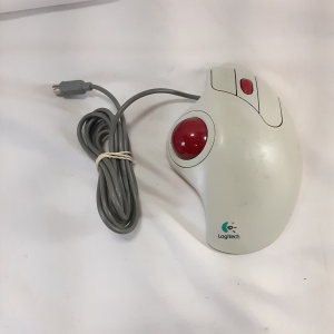

Last century, Logitech made a thumb-driven trackball called the Logitech Trackman:
290063-0
As you can see, it was designed for right hands, but it was also designed for large right hands.  I know this because my own hands are in the large-ish range and, being ambidextrous, I used one of these for years.
(This next bit is where the "far more trouble than it is worth" aspect comes in.)
Someone well-versed in CAD software and small-scale manufacturing might be able to pick up one of these, reverse the right-handed design, and make one (or have one made) for left hands.
Obviously, this is not something that could be done in an afternoon (to say the least), but considering what the offerings are in the way of left-handed trackballs, whoever does this might be able to sell a few (and, of course, they could always check the interest level for it on GH before they embark on the project).
The patent for this particular design ran out a few years ago (the first model of these came out in 1995), so anyone doing this may also be able to update the design a bit while they are at it.
(Now you see why I said it was probably more trouble that it was worth, don't you?)
