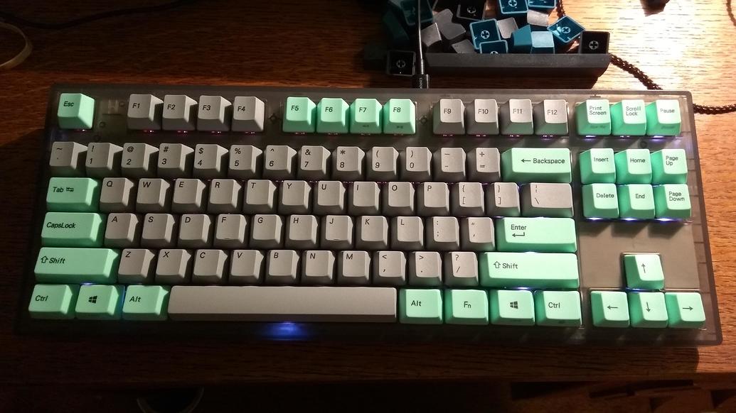

Larger: https://www.keebtalk.com/uploads/db8059/9ef92fa5ff8636fde2aa8099186cf34a3c2044c3
Making these changes is somewhat challenging, as you have to open the case using tabs, which is more cumbersome than if it were screws. So it's a more time-consuming and annoying operation, and shouldn't be done unless you are ready.
I think the MK870 is such great value that I am ordering another one for a relative, and will give it to them in stock, unmodified form. The stock keyboard is fine for most people. Please keep in mind that you will need to install Windows software from their website in order to control the LEDs.

Offline zangaby
  • Posts: 12
Re: TKL keyboard with south facing LED's
« Reply #11 on: Fri, 07 January 2022, 08:35:13 »
The build has been completed, this is how it looks.
Offline HungerMechanic
  • Posts: 1460
« Reply #12 on: Fri, 07 January 2022, 14:57:45 »
Looks like the south-facing LEDs were a success. Interestingly, I'm planning a similar build for a relative.
