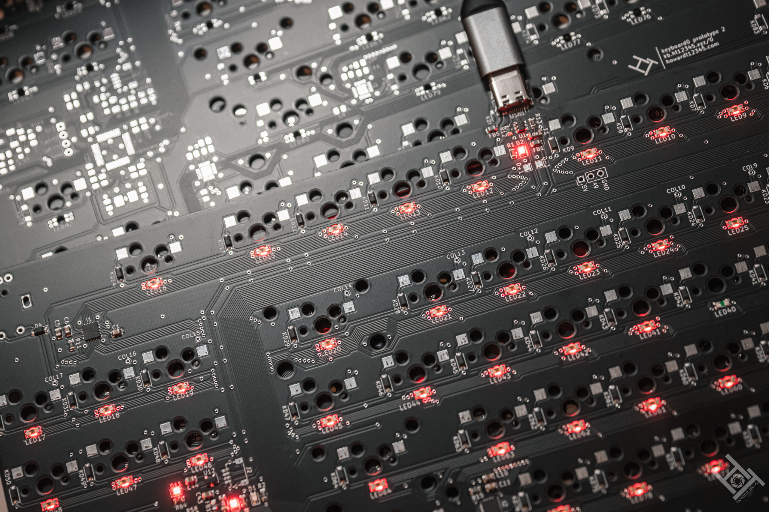

I tried integrating the USB hub into the actual keyboard design for my first prototype, in an attempt to have everything on one PCB. This unfortunately proved to be a horrible idea, as it created multiple points in the design where it could fail, and it ultimately did fail once I received the prototypes. More information on the first prototype can be found here.
Second prototype:

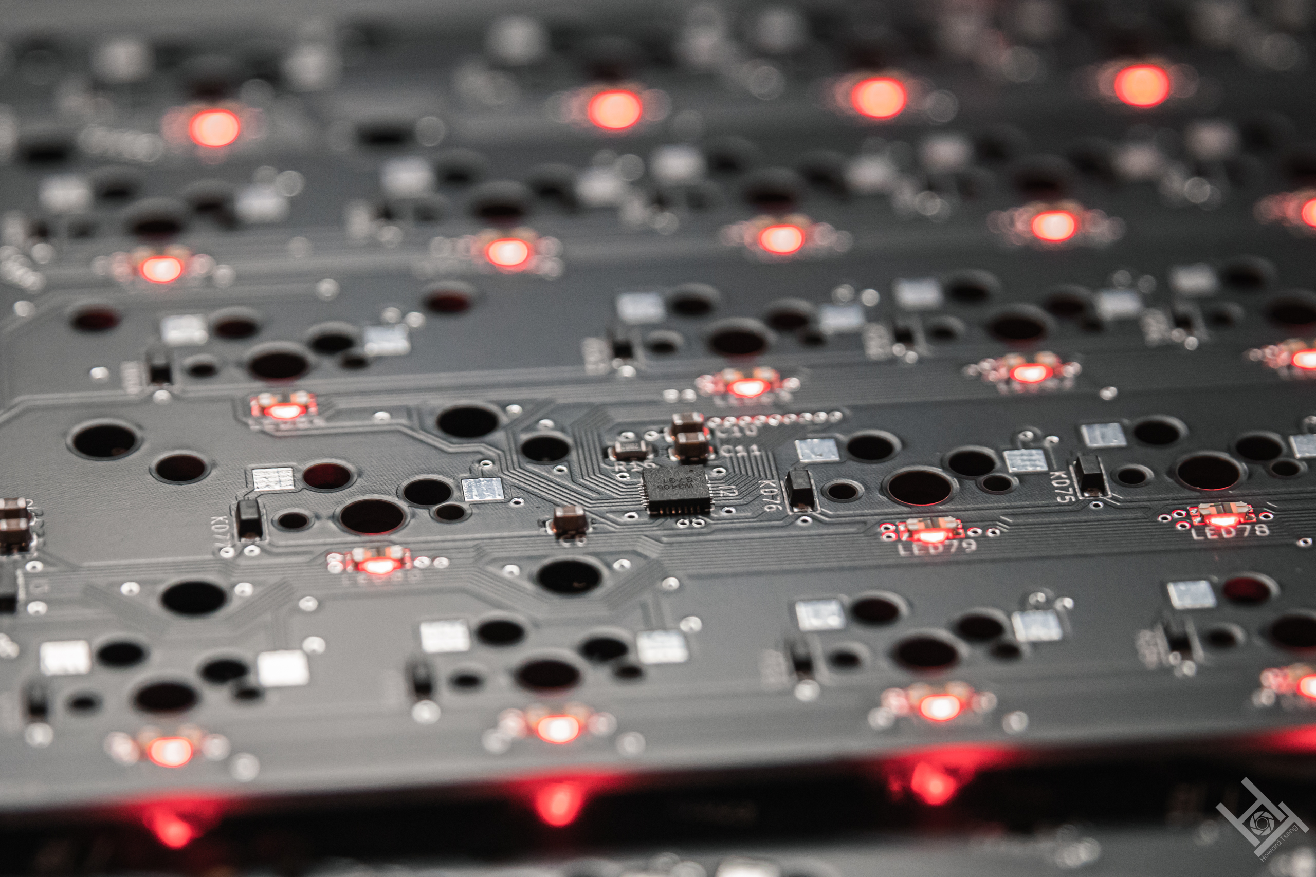

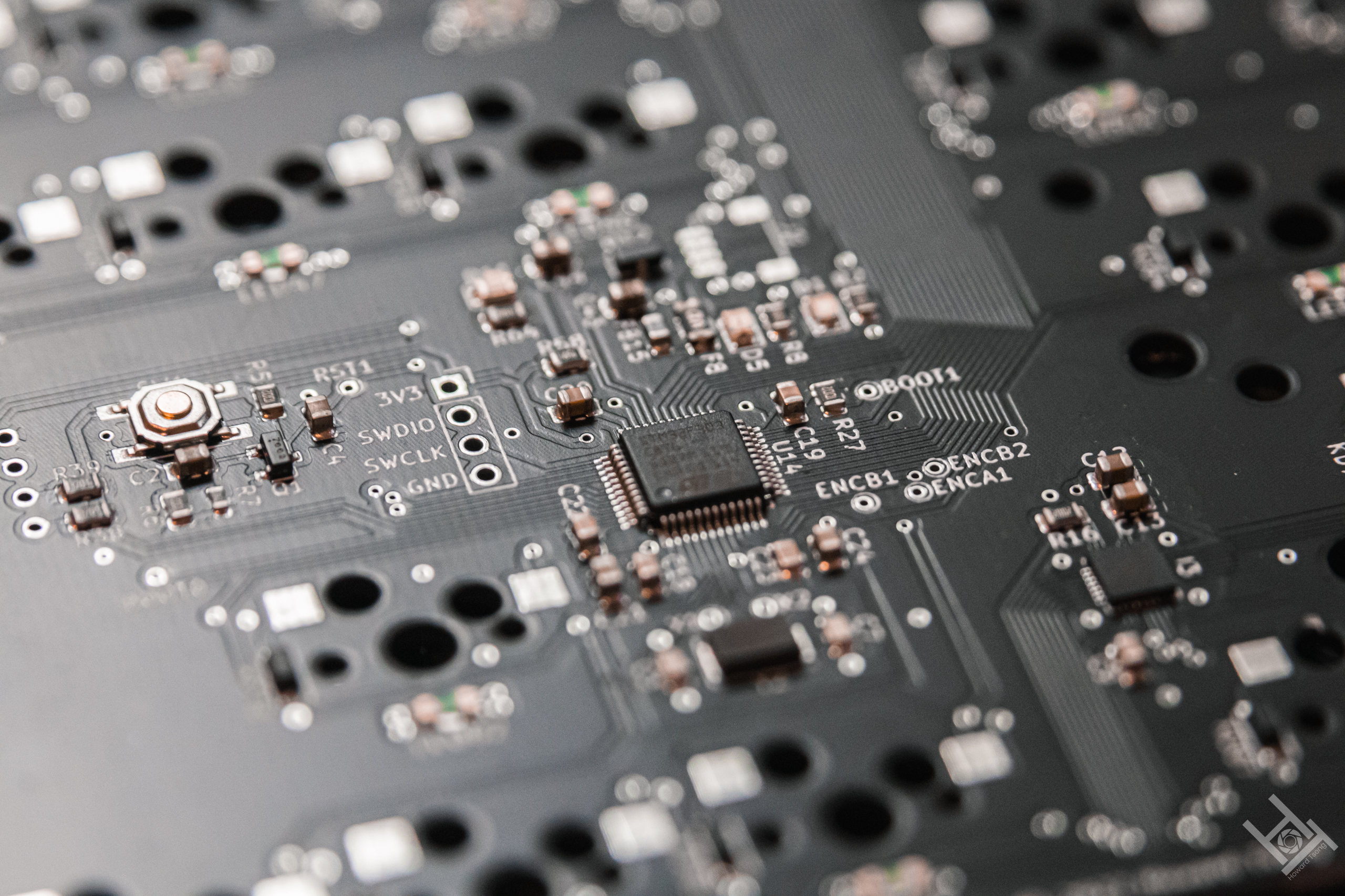

After the failure of the first prototype, I redesigned it addressing several issues. I decided to remove the USB hub, but kept a footprint for a JST connector so that it can be used with a daughterboard as well. I also switched from using SK6812's for RGB lighting to an RGB matrix with 3 IS31FL3731 drivers and MHT151RGBCT LEDs (they seem to be generic common anode LEDs).
The second prototype worked! One of the prototypes is fully functioning as expected, while the other one had some minor issues with the RGB.
Images of the prototypes:
280947-1
280949-2
280951-3
More images are on my Instagram!
