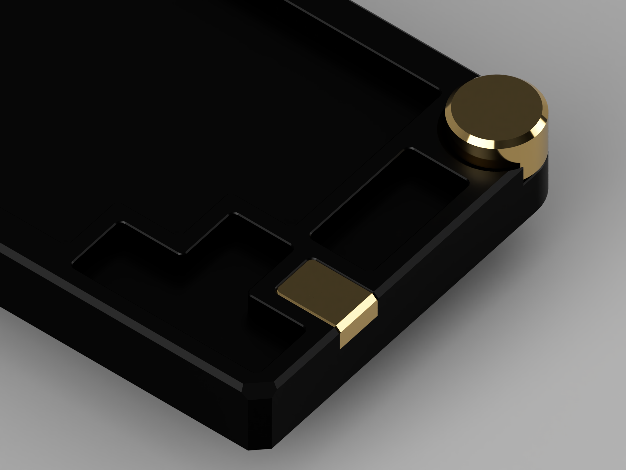

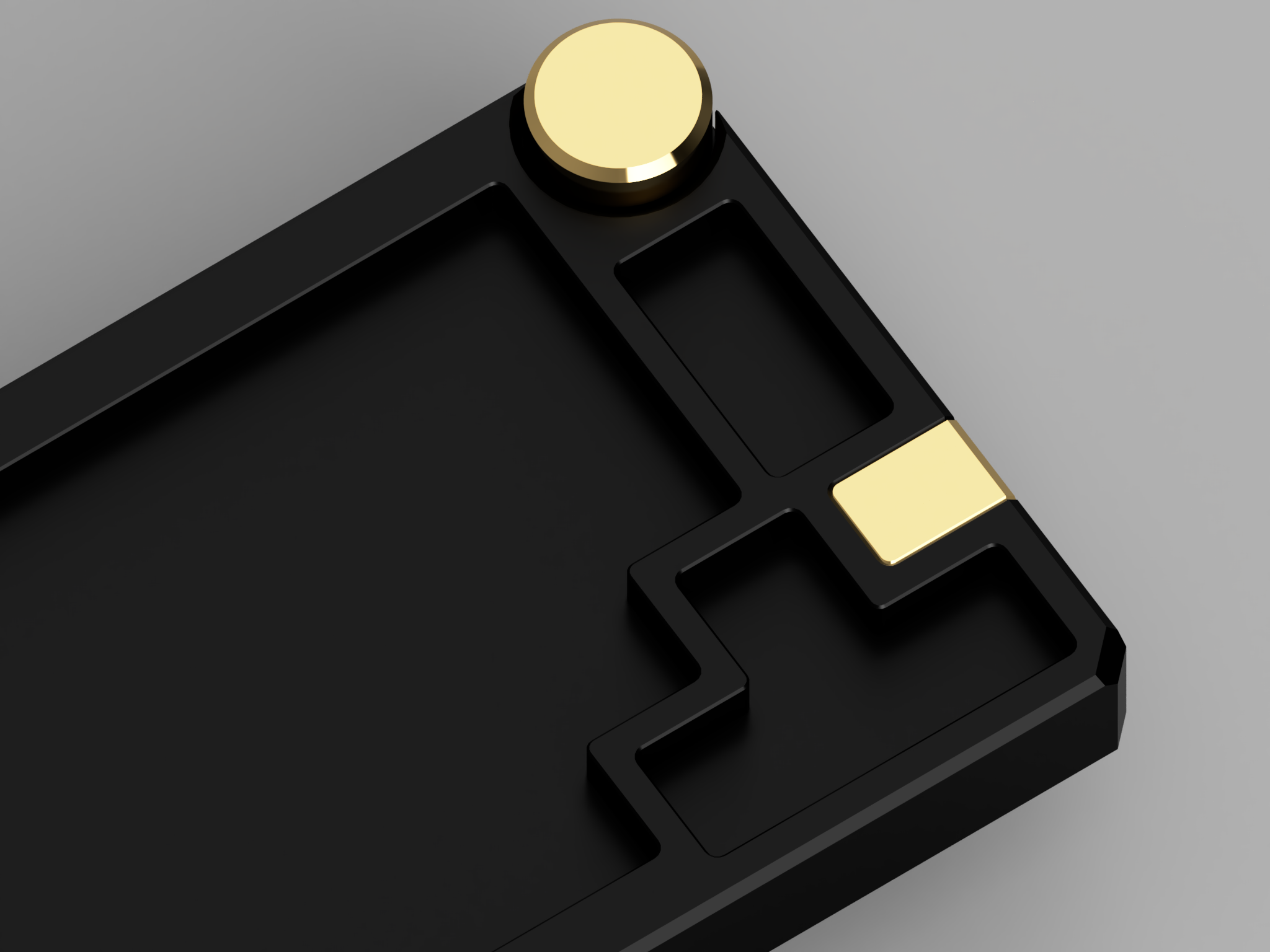

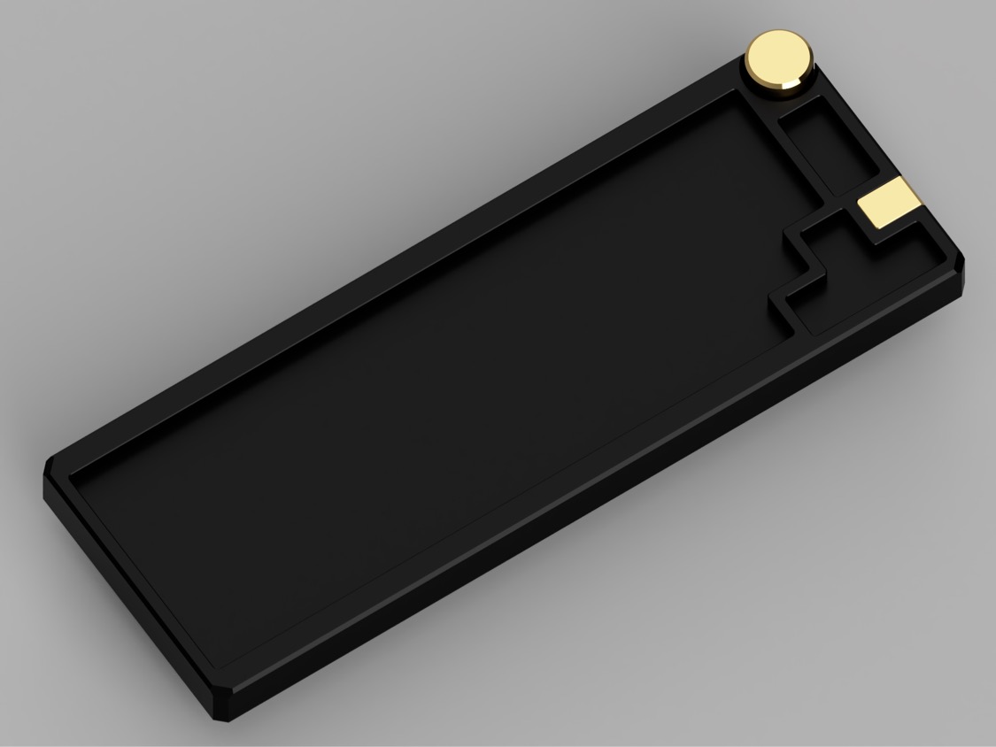

Those hotswaps are pressed in. My first intention was to use adhesive to locks them, but then i found out if i machined those pockets 0,025-0,03mm under, the plastic housing will be compressed and stay there beautifully. So no need for adhesive. But if the hotswaps fall apart after a while - but i don’t think that they will, you can always use adhesive like epoxy to glue them in.
My workshop that i’m working only and only machining brass, so other type of material is not allowed :(. But if i can, i would love to try to make a solid stainless steel one. I’ll pass on aluminum because everyone else is working on aluminum, and of course i can’t compete with that.
The 65% i estimate that it would need about 16kg of raw brass material, and it would be ~7kg when finished. This is just a quick sketch.
281769-0
