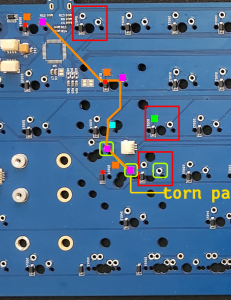

You can see that the rows are connected across the bottom of the diodes which are connected to the left pins of the switches, so connecting to the next column will get the next key as you've found.
On the other side of the PCB you will see traces connecting the right pins for the columns, and I suspect an extra trace from the damaged pad heading up to connect the column back to the chip - I would try and do it blind but maybe there's a surprise to be found so please take a pic of both sides of the PCB in the same size and and angle I'll have a look :)

Thank you so much for the reply, here is the front side of the board.

Slightly bigger than the first but close enough :thumb:
Interesting - I've added the orange trace as seen on the other side and it doesn't hit the switches in the red squares but it looks like it does hit the ones you named, assuming a normal keymap.  Surprisingly the only switch on the trace that works is \| which is the worst of many stupid design decisions I've seen on commercial PCBs - why is half of the most important pad in a stab hole?!  Whatever, we'll just assume everything is broken and test it.  I'm assuming you removed the green bridge that made the keys register wrong, if it was ever soldered...
291520-0
First confirm the cyan pin is connected to the controller chip by touching a wire between cyan and the green pin of the the known working switch next to it - it should type enter.
Next touch the wire between any of the dead key's orange pins and cyan - this should type the dead key.  If it doesn't touch the red end of the diode to cyan and that should.  If the diode works but the switch pin doesn't you need to solder a tiny bridge between orange and red to reconnect the diode.  Repeat for all three dead switches.
If you've soldered any bridges you can now test those keys - they might work.  If you didn't solder any bridges or the keys still don't work you need to reconnect the orange trace by soldering bridges to cyan.  Connect one of the magentas to cyan and connect the other magentas together to avoid damaging cyan.
I don't see an LED cluster that could be not working, feel free to mark it and I'll have a look.

« Reply #5 on: Sun, 18 September 2022, 16:11:06 »
You've now  put magenta boxes round ANSI and ISO enter and the \| key which you can't see with an ISO enter, as well as what I believe to be print screen (I've spent too long on an 1800!)  I'm going to assume the pic I've just added to the previous post (:-[) is still accurate and \| isn't registering because your computer is also set to some kind of ISO layout, though it may just be broken as it's so poorly designed.

Sorry for the late response. A big thanks to suicidal_orange, the matrixlabs discord, and anyone who dealt with me after I messed this guy up. My friend did all the bridging recommended and got the board back in working order.
So the culprit seemed to be the trace torn at the backslash key. I realize now how utterly confusing some of my pictures were, anyways here is my friend holding the finished work. All keys are in working order, unfortunately we havent been able to diagnose what is wrong with the LEDs  :( :(

Trace scraping required thanks to the bad design - as you've now seen it's not something you want to do but at least there was a section with nothing near it. Glad to hear it's working again :)
