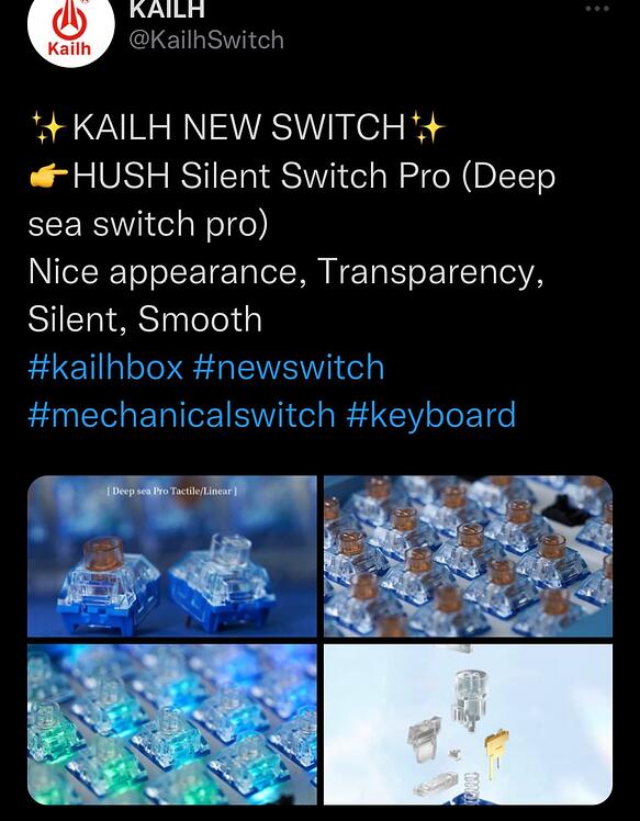

So something like these latter two, esp. Deep Sea, could meet your requirements. Deep Sea is pretty plug-and-play, it's fine enough without user intervention. There's also a new switch coming up:
but little is known about it.
