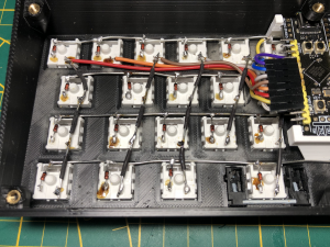

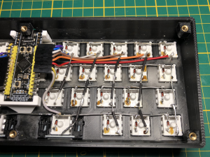

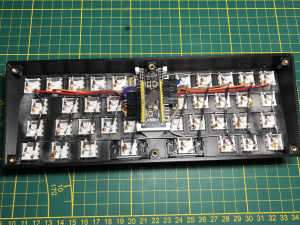

Hi,
So I'm finishing my first 3d printed, handwired keyboard and I'm almost finished and obviously I had to face some problems.
My keyboard is a 40% designed by me (took inspiration of other 40s but changed it a bit) so I had to make some changes to QMK despite having no experience with it.
I have my keyboard all wired up and connected to STM32 controller.
After some changes to firmware I was able to compile and flash it succesfully, however keyboard does not work at all. I assume it is a software problem because wiring seems to be conducting signal properly.
So, I'm posting jason.info file as well as my keymap file and qmk toolbox log for someone to check for me.
Also I'm adding link to pictures of keyboard wiring.
Lastly sorry for any mistakes as english is not my native language and big thanks in advance for any help!
