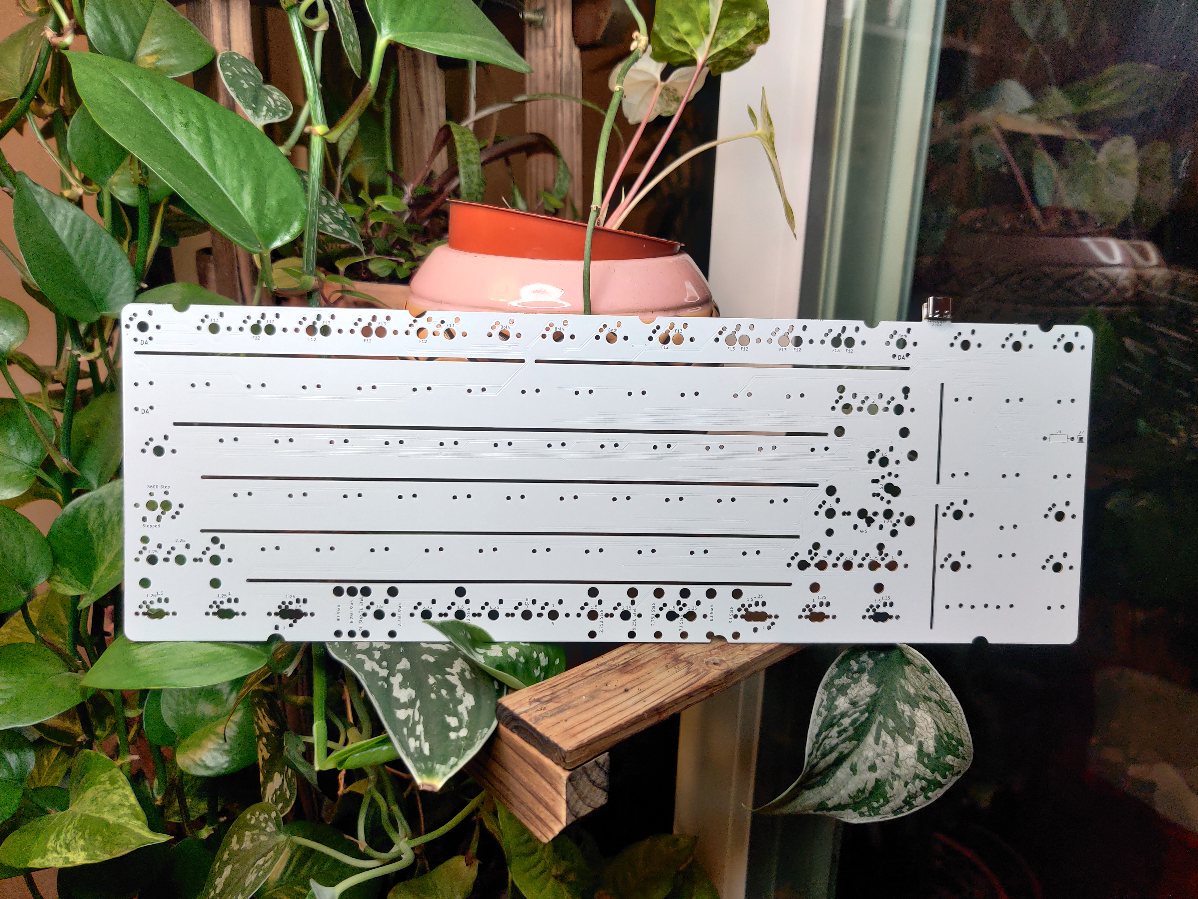

The PCB
For the PCB, I initially planned to use a Hiney h87c because Hiney PCBs are well-designed, easy to build with, and the holes for the switch pins aren’t too large, but at some point along the way I decided it simply had to be a thin PCB. It seems thin variants of the h87 are significantly harder to come by than the thin h88, but as I was planning the build the Alpine PCBs by Zykrah and NeonKnight were released. I chose the Alpine FL for this build for the obscene amount of flex cuts - I wanted near-meme levels of flex, or at least a very soft bottom-out.
300293-3
