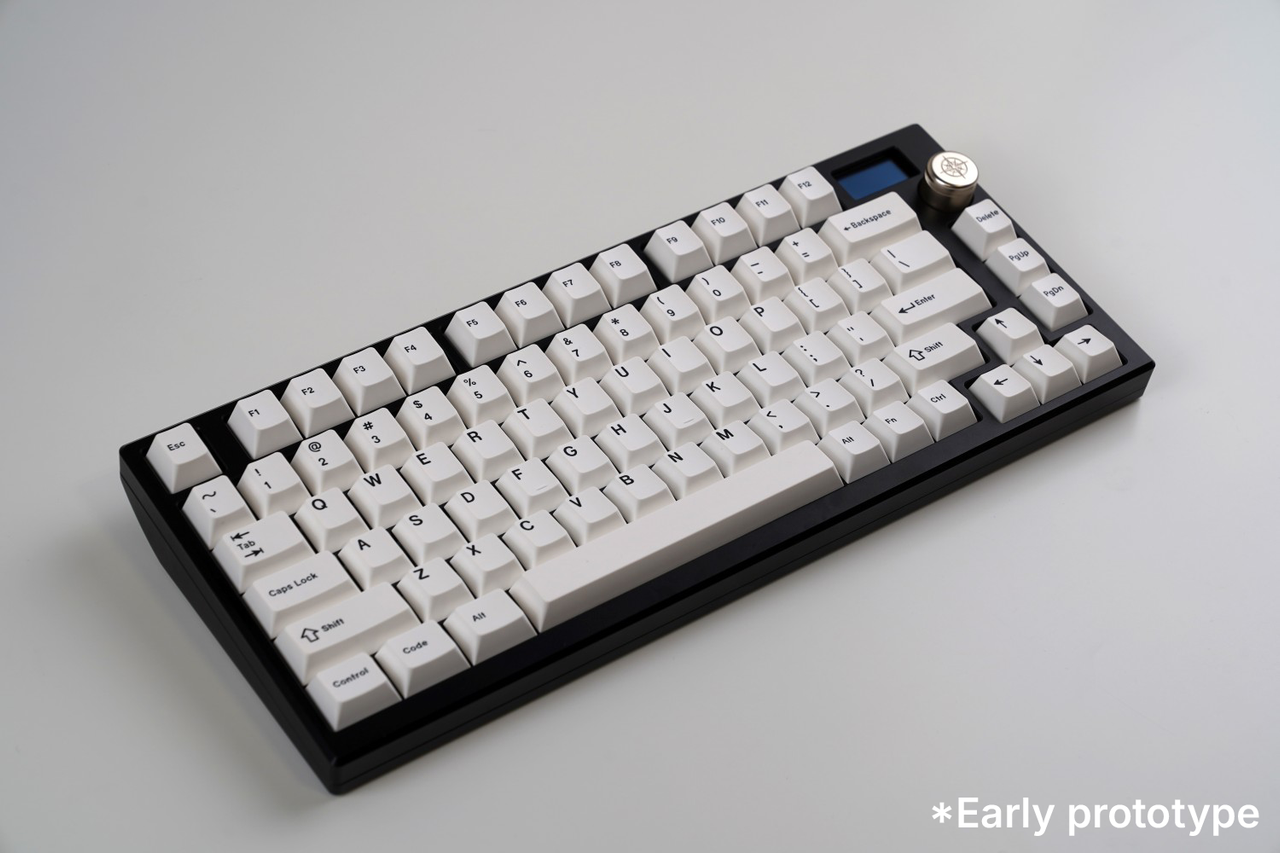

The Satisfaction75 v2 uses an asymmetric or single-sided gasket sandwich mount to provide a more modern typing sound and feel, versus the classic burger/top mount of the original. There are a total of 5 large plate tabs and 2 small plate tabs for gaskets.
The gaskets are asymmetric to provide a bit more of a bouncy feel to the board, with thinner gaskets above the plate and thicker gaskets under the plate. The mounting style is still a sandwich gasket, so it’s still quite stiff compared to some alternative mounting styles out there, but by having thicker gaskets under the plate, in the direction that typing force is applied, we do get some bounce.
The size and softness of the gaskets is also tuned to optimize acoustics and feel. I tried a bunch of different variants of gasket thicknesses and hardnesses and landed on the current final configuration. Some gasket combinations didn’t provide enough compression, and the plate/PCB assembly would shake in the case. I varied the size, thickness, and hardness of the gaskets before finally landing on the final configuration.
To ensure even compression on the gaskets across the board, keep the bezels slim, and maintain the curve across the back of the board, I did have to rely on 3 “internal” screws that go in between switches to secure the top case to the bottom case. To keep them hidden as much as possible, they will be black colored in production. The 8 other case screws still screw in from the bottom of the board, and have been upsized from M2 to M2.5. The increased screw size will help with longevity in assembly/disassembly, and are honestly just a little easier to work with.
There is a spot for a gasket underneath the spacebar - but the “spacebar meme cut” from the original Sat75 makes an appearance again to mitigate the potential negative impact of this gasket mounting point. In testing, adding and removing the gasket in that spot does change the sound of the spacebar a bit. I would encourage anyone who buys a Sat75 v2 to try it both ways, and pick their favorite.
I opted to forego alignment pins so that the isolation remains perfect from top to plate to bottom. There also wasn’t bezel space to implement a solution similar to what I used in the CK980C. This does mean that you’ll have to take some care when building to ensure your plate alignment.
The end result of this mounting style is a tunable, modern type feel and sound - that is still true to the original Sat75, but with a tad more bounce.

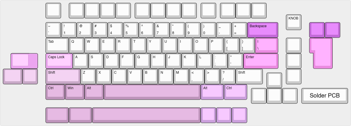

Another feature of the original Sat75 was a fixed plate. The mostly fixed plate comes back again this time around for my preferred layout - a 6.25U ANSI bottom row. This time around, stepped caps lock is also supported by the hotswap PCB.
We’ll also have a universal plate that supports ISO and 7U bottom row.
Two PCBs will be available - a hotswap PCB featuring all support except ISO, and a solderable one that adds support to ISO and is Mill-Maxable.

We’re waiting on a final Hongtu produced prototype before sending out the new Sat to content creators. (The current one was produced by JLCPCB, and we used a brass weight from Sat75 R2). Once we receive and validate the final prototype, we can move on to scheduling the group buy.
