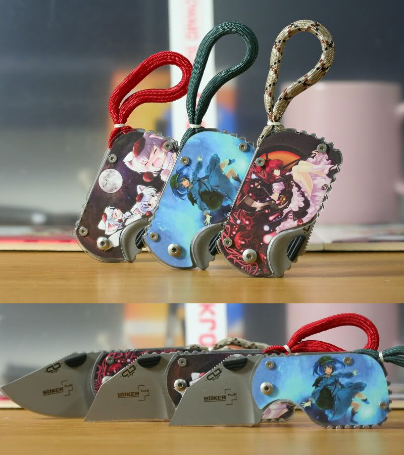

Nice Subcom! (I am also a member of a knife/multitool forum :P)

Thanks! I made a few custom polycarbonate scales.
