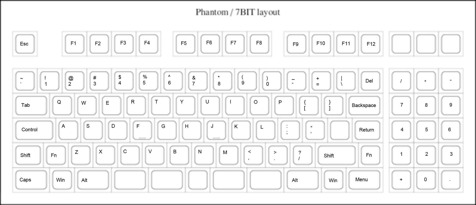

I am planning on building a Phantom keyboard with 7bit's switch layout but I am going to use my own custom key layout. I am trying a few different things but I ended up combining the layout that I designed for the DOX keyboard and the HHKB layout (because 7bit's layout already had that HHKB feel to me). I have finalized most of it but there are a few keys that I cannot decide on and was looking for some ideas mainly for the blank keys on the default layer (though if you do have additional ideas please post them). Below are some reference pictures so you dont have to go around looking everywhere.
Phantom layout Sample
Phantom 7bit layout
7bit's layout
Updated 7bit layout
7bit's Layout updated

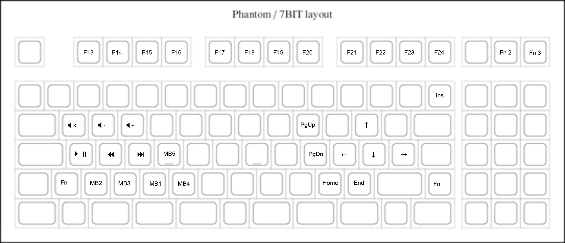

my 7bit Phantom Custom Keyboard Custom Layout - default layer
my 7bit Phantom Custom Keyboard Custom Layout - Fn layer 1 (MB = Mouse Button)
my 7bit Phantom Custom Keyboard Custom Layout - Fn layer 2
I have updated the layouts (layers 2 and 3 will be toggle able):
Default Layer
Layer 1
Layer 2
Layer 3
The black boxes are what I still need help figuring out a use for, all help is appreciated!

Hmm, that numpad embedded in the arrow keys was what I was thinking when i saw 7bit's layout.  I want keycaps that have the appropriate keys for each fn layer now :/  Probably too customizable.
I would have the numpad on the second layer and not the primary layer though. Thats what is so cool about the teensy though, you can just reflash it when you think of new layouts.

I have made the 3 middle buttons in the bottom row all space as it is the most common place that I have found that I and friends hit space. I am still looking for useful functions for the outer keys and the small key to the left of return. All suggestions are welcome.

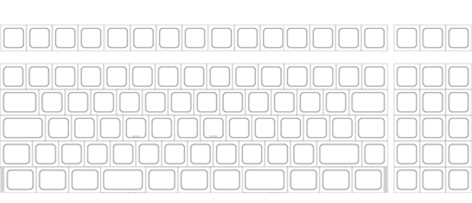

I have question about how you plan on getting the keycaps for your new keyboard layout. If you are going for all same profile keys then it should be very easy, but if you are going for sculpted keys I think you might run into a few problems with the right side 1.75 size shift key (same size as capslock, but different sculpted shape) and the bottom row 8x1.5 size keys (same as tab and \, but different sculpted shape) and lastly the 1.25 size enter key (same size as the win/ctrl/alt, but different sculpted shape.) That was the very thing that made me change my mind about changing the size of the right shift key for my design. Although for the bottom row you could change the 1.5 keys with 1.25 and get an extra 2 keys in there. 8x1.25 = 10 and 5x1 keys. Also it would be easier to find 1.25 size keys since that is the default win/ctrl/alt than a custom 1.5 sculpted key (just giving advice as it would save money and allow even more keys on the bottom row.) Remember every row has a total of 15x1 keys that can fit.
Default layout
Code: [Select]
 1 1 1 1 1 1 1 1 1 1 1 1 1 2
1.5 1 1 1 1 1 1 1 1 1 1 1 1 1.5
1.75 1 1 1 1 1 1 1 1 1 1 1 2.25
 2.25 1 1 1 1 1 1 1 1 1 1 2.75
1.25 1.25 1.25 6.25 1.25 1.25 1.25 1.25

7bit's layout is based on the Phantom PCB which main goal was to be able to use vintage Cherry double shot keycaps with 1.5u ctrl and alt.

I have updated the layouts:
Default Layer
Layer 1
Layer 2
Layer 3

Quote from: TheProfosist;449753
What about Super and Hyper modifiers.
I would put |\ down left of RETURN and use the |\-position for something else.
I use the DELETE key on the numpad, so I like to have DELETE in the bottom row.

I have had a sudden idea because I also use the (, ), and other symbols from the num row alot. On the default layer the num row will actually be the symbols not the numbers because the numpad is out. When you engage layer 2 it will switch it back to normal. Also I am going to put Esc, Tab, and = where PrtSc, ScrLk, and Pause are. PrtSc, ScrLk, and Pause will be added to layer 1. |\ will be moved next to return and PrtSc will go next to Del. I think this makes for a much more useful keyboard for myself. Though I sill can figure out what to do with those 2 outer spacebar buttons.

« Reply #20 on: Thu, 17 November 2011, 02:23:18 »
Since the layout has changed I converted the old one to the new one. I will update it again soon since there are additional keys open. I am still looking for suggestions for the spacebar keys.
Default Layer
Layer 1
Layer 2
Layer 3

updated once again and this time all keys are used
Default Layer
Layer 1
Layer 2
Layer 3
Yes, I know that layer 3 has nothing on it, it is currently just a play holder an may not be there in the or it may with a completely new layout.

« Reply #26 on: Mon, 21 November 2011, 21:05:35 »
Updated the layout slightly again and removed layer 3.
Default Layer
Layer 1
Layer 2

I modified the layout a bit so that I could use keycaps from WASD. The only down side is that there is a small gap on the right and left side of the bottom row and the Enter key has to be a R1 key. I personally can make these compromises because I want custom legends of my layout. A new revision of my layout is hopefully soon to follow along with a template for WASD.

Quote from: TheProfosist;454614
Quote from: TheProfosist;457387
What lengths were the keys on the bottom row before?  And won't the keys in the new layout shrink toward their centers, relative to the old layout?  (As opposed to how you have it here with the extra space on the ends.)
« Last Edit: Tue, 22 November 2011, 12:43:09 by hashbaz »

« Reply #31 on: Tue, 22 November 2011, 12:41:30 »
Quote from: hashbaz;457535
What lengths were keys on the bottom row before?
that is the old one this is the new one though you still have to use a R1 1x1.25 for enter

« Reply #34 on: Mon, 05 December 2011, 07:21:14 »
Revised layout after the change to the ISO like left shift:
Default Layer:
Layer 1:
Layer 2:
Offline TheProfosist
