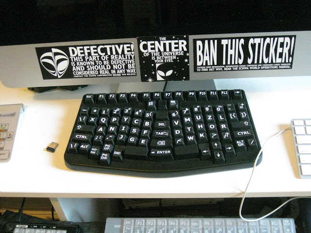

Offline batchout
Truly Ergonomic TE remappings
« Reply #25 on: Thu, 21 June 2012, 12:56:39 »
Using AutoHotKey for PC (for MALTRON remap & all special keys)
and KeyRemap4Macbook/PCKeyboardHack for Mac (to use the international 1-6 keys)
and Ukelele for Mac (to remap to a MALTRON keyboard layout)
until the vaporware remapping software actually exists.
I am a huge supporter of the Maltron Layout.
The X key and /? are reversed due to the moved apostrophe key (from QWERTY)
Shift & Control swapped back to match my Kinesis (and almost every other keyboard)
Slash keys on the bottom corners
Dedicated Underscore & Asterix keys on top left
parentheses moved to 5 & 6 keys
=+ key flipped to +=
Currently I'm using the Deck109 on a Mac. My PC relies on having num lock ON, and because this swaps in the 10keypad, it's currently a deal-breaker. Wish I could turn this dependence on the system numlock state OFF!
Vinyl Key Stickers from 4keyboard on eBay.

« Reply #27 on: Thu, 21 June 2012, 23:47:06 »
When typing, I rest the TE on a (lower) lap-level shelf with a Logitech Wireless trackball right next to it. Since my hands are at a neutral position, it all just fits. Been using for 3 weeks like this. Will post updated photos, link to my key maps.
I swapped Ctrl & Shift (but not in the photo) and used Cherry blues for a nice crisp click.
The vertical row stagger helps your hands stay in position, unlike a TypeMatrix, in a good way. No Stagger, no problem.
I use a thin rubber mat & the TE & Trackball are sturdy & reliable.
