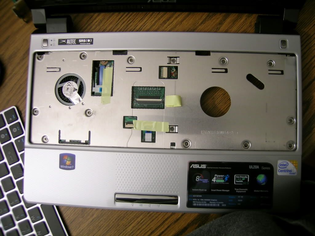

How do you plan on diagnosing the keyboard? Usually there's a little thin data cable that connects the keyboard to the motherboard, so you can't really just connect it to another computer to diagnose it. I don't have this particular notebook model, but I have a different Asus notebook I can post pictures of a complete disassemble later. It should be the same concept.

There are little tabs on the keyboard you can gently pry off. I think for your model though, the tabs are on the bottom instead. Once one side of the keyboard is loose, just slip off the other side. The data ribon cable is connected to the cut out square in the middle that has the exposed motherboard, so just unplug it after you get the keyboard off the main chasis.

OP, it looks like taking off the keyboard from yours is the same way you take off the keyboard on my Asus UL20A based on the youtube video that Internetlad just posted. Skip to the 6:00 minute mark where he takes off the keyboard.
