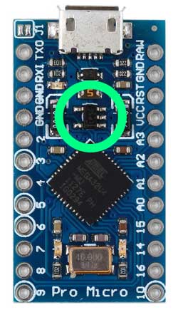

Ok, found the culprit. Unfortunately, the Pro Micro has pin 3 assigned to GND, where the Pro Mini uses that as a RST line. This causes the host shield to be held in reset. I really don't understand that design decision... really dumb move, if you ask me. The only answer is to disconnect pin 3 (the GND pin right next to TxI), and connect it to the RST pin on the other side of the board. Seriously, this design decision makes absolutely no sense to me. The Pro Micro is supposed to be pin-compatible with the Pro Mini... why, guys? :(
Anyway, that modification seems to work for me.
Something else to be aware of is that the cheap board that I bought I think is a 5V version, so I'll need to switch the regulator for a 3.3V one. Dammit it looks like I have to buy 5 minimum on ebay for $11. Anyone have any ideas on where to get a single suitable 3.3V regulator (need a MIC5219-3.3) cheap?

Yeah, I saw a lot of ones in that packaging on ebay, but unfortunately they're a lot bigger and the pins don't match up. It'd be really ugly if I used them. Pity though, LM1117's are available on ebay for about 16c each! Seems stupid that I need to pay 15x more and buy 5 at a time just to get the same thing in a different case with less current capacity. Oh well, that's how they get you, I'll have to buy them anyway.
The one I need will look like this:
