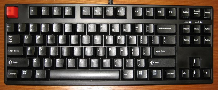

This may officially be the geekiest thing I've ever done.  I sort of like the "stepped" caps lock key.   Messed up a few before I got one right.
The spacebar has turned out to be more of a problem due to the different spacing on the stabilizer bar.   But I'm sure I figure something out ....

Very Nice! I have been planning on trying this for a while. How did you remove the stem? I am guessing pliers?

Quote from: sixty;166360
I actually cut the stem off of another key cap.  Then I milled the stem down till it would fit exactly in the center of the cap.   I used a microscope to align things.   Didn't take that long.   The stem is part of the cap, so I don't think they will pry off.

Quote from: salcan;166364
Is that the same 2 part epoxy ripster recommended a few days ago? (sry, not sure the thread)
I used Gorilla glue.  But only cuz I had it handy.  Gorilla glue expands when it sets, so I sandblasted both parts, primed the plastic, glued the two pieces and used a tongue depressor and rubber bands to clamp the parts overnight.
Probably much more trouble than it's worth.   But I couldn't settle for a shift key in the caps lock position.

Okay.   Spacebar blue switch swapped out and new DS keys installed.   Brand new keys courtesy of Didjamatic.   All keys from that set were used except for the rt. shift key which came from a different board and the space bar which is the Filco for now.
The lower row isn't a great swap.  The correct sized DS keys have off center stems and this smaller set leaves unattractive gaps btwn the keys.   Oh well.....close enough for now.    Keys feel a little different.  More solid and damped.   I like it.   Well worth the effort imho.    Next up with be the full DS swap on a 104 keyboard.

I bought a Filco tenkeyless with Cherry browns for the office and found a couple Cherry 'boards on eBay that provided the necessary double-shot replacement keys:
I apologize for my lousy photography skills, but in person this thing looks and feels great. Filco with double-shots is definitely a winning combination.

The caps lock and front row keys came from a Cherry MX-8100:
http://geekhack.org/showpost.php?p=156685&postcount=67
The rest of the keys are from an MY-7000, except the spacebar which is the original Filco.

Just some updated pics on my DS Filco.  Used pretty much everyday for the last month with no distinguishable wear/shine to the keys.
and some outdoor shots:

Smallest to biggest keyboards in inches (Length X Height) - Length is most important for a midline mouse position
KBC Poker: 11.6 x 3.9 - HHKB: 11.6 x 4.3 - Siig Minitouch (Geekhack Space Saver): 11.6 x 6 - Deck/Tg3 82: 12 x 6 - Noppoo Choc Mini 12.4 x 5.3 - Compaq "MX 84u": 13.1 x 7.5 - Filco Tenkeyless: 14 x 5.3 - Cherry "ricercar spos" G86-62410EUAGSA: 14 x 7.75 - Topre Realforce 86u: 14.4 x 6.65 - Desko "elbowglue spos" MOS 5023 UP: 14.5 x 8.4 - IBM Model M Spacesaver: 15.3 x 7 - G80-1800: 15.9 x 7.1 - Adesso MKB-125B: 16 x 7.3 - Compaq Mx11800, Cherry G80-11900: 16.25 x 7.5 - Filco Standard: 17.3 x 5.4 - Unicomp Endurapro: 17.9 x 7.1 - Adesso MKB-135B: 18.3 x 6.0 - Cherry G80-3000: 18.5 x 7.6 - IBM Model M, Unicomp Customizer: 19.3 x 8.27
