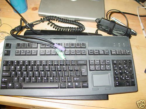

Here's my anti-otaku effort, albeit using laser-etched keys from a Cherry, and its keypad's stems transplanted onto winkeys and the spacebar from a Gateway rubberdome.
The imperfection of the stabilizer arms is that the slots are too wide vertically, so it increases rattle with the wirebar, unless amply greased—I could probably graft more plastic, or redo them.

« Reply #31 on: Mon, 26 October 2009, 16:39:41 »
Woot.  I bought an 87 key filco otaku blue cherry from another member of geekhack, but I think I may mod it when it comes in to have printed letters too!  (I think I'll buy some nikon gear and some legos too so I can really be like ripster lol)
You guys think these keycaps would work?
G81-7000HPBUS-2
http://cgi.ebay.com/New-Cherry-Keyboard-G81-7000HPBUS-2_W0QQitemZ260494351772QQcmdZViewItemQQptZPCA_Mice_Trackballs?hash=item3ca6ac5d9c
Thanks.  I've been bit buy the bug.  But not so badly that I think I need a topre yet :P
My keyboards: Filco Cherry Blue Tenkeyless(daily home), Compaq MX11800 (modded to blacks), Compaq "MX 84u",  Wellington\'s Dampened Endurapro, Pinkalicious Filco Blue Cherry, Chicony KB-5191, Chicony KB-5181, Desko MOS 5023 UP "elbowglue" spos (modded to blues), Siig Minitouch (monterey blue), SMK-88 (blue cherries), Ricercar SPOS
Smallest to biggest keyboards in inches (Length X Height) - Length is most important for a midline mouse position
KBC Poker: 11.6 x 3.9 - HHKB: 11.6 x 4.3 - Siig Minitouch (Geekhack Space Saver): 11.6 x 6 - Deck/Tg3 82: 12 x 6 - Noppoo Choc Mini 12.4 x 5.3 - Compaq "MX 84u": 13.1 x 7.5 - Filco Tenkeyless: 14 x 5.3 - Cherry "ricercar spos" G86-62410EUAGSA: 14 x 7.75 - Topre Realforce 86u: 14.4 x 6.65 - Desko "elbowglue spos" MOS 5023 UP: 14.5 x 8.4 - IBM Model M Spacesaver: 15.3 x 7 - G80-1800: 15.9 x 7.1 - Adesso MKB-125B: 16 x 7.3 - Compaq Mx11800, Cherry G80-11900: 16.25 x 7.5 - Filco Standard: 17.3 x 5.4 - Unicomp Endurapro: 17.9 x 7.1 - Adesso MKB-135B: 18.3 x 6.0 - Cherry G80-3000: 18.5 x 7.6 - IBM Model M, Unicomp Customizer: 19.3 x 8.27
Offline itlnstln
  • Posts: 7048
Using Cherry Corp DoubleShot Keys on Your Filco/Wasd/Rosewill etc...
« Reply #32 on: Mon, 26 October 2009, 16:41:47 »
These will be fine.  The larger keys might not work, but the majority will.

« Reply #45 on: Fri, 05 February 2010, 20:26:40 »
Quote from: ripster;113972
Yaaaay - the R-SHIFT key is a 1:1 replacement.  Finally.  Now for the front row.  Whaaa.... A DOUBLE insult.  No double shot and offcenter posts.  What was Cherry Corp thinking.  Dumbkopfs.  Sheisskopfs.  Das ist nicht gut.
The front row keys on this Cherry MX8100 fit the Filco:
The Control and Alt keys are double-shot, the Windows keys aren't.
Offline cchan
  • Posts: 223
  • Location: Michigan
« Reply #46 on: Sun, 07 February 2010, 23:09:10 »
Quote from: pfink;156685
and so does the capslock - the stem is centred on this board.

Quote from: cchan;156995
Are the keys on this board (Cherry MX8100) double shot?   And if they aren't, do they match the height/look of the double shot keys on the G80 and G81 boards?
thanks,
skc
Offline sixty
  • Posts: 984
    • http://deskthority.net
« Reply #49 on: Sun, 14 March 2010, 22:09:09 »
Quote from: skcheng;164054
thanks,
skc
They are doubleshot on the auction (and pictures) linked earlier in this topic. However, there are also lasered versions. Keep looking for the H** in the serial, which indicates double shot keys.
