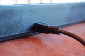

The header fits nicely!
3200-6

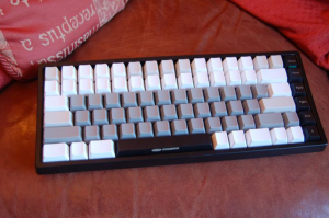

And there we go! Done! Here are the final photos.
3202-7
3204-8
There we go! This is a much better looking board without the bulky cable on the end! I hope this helps any of you looking to do the same thing, as it can be adapted for almost any other board!
