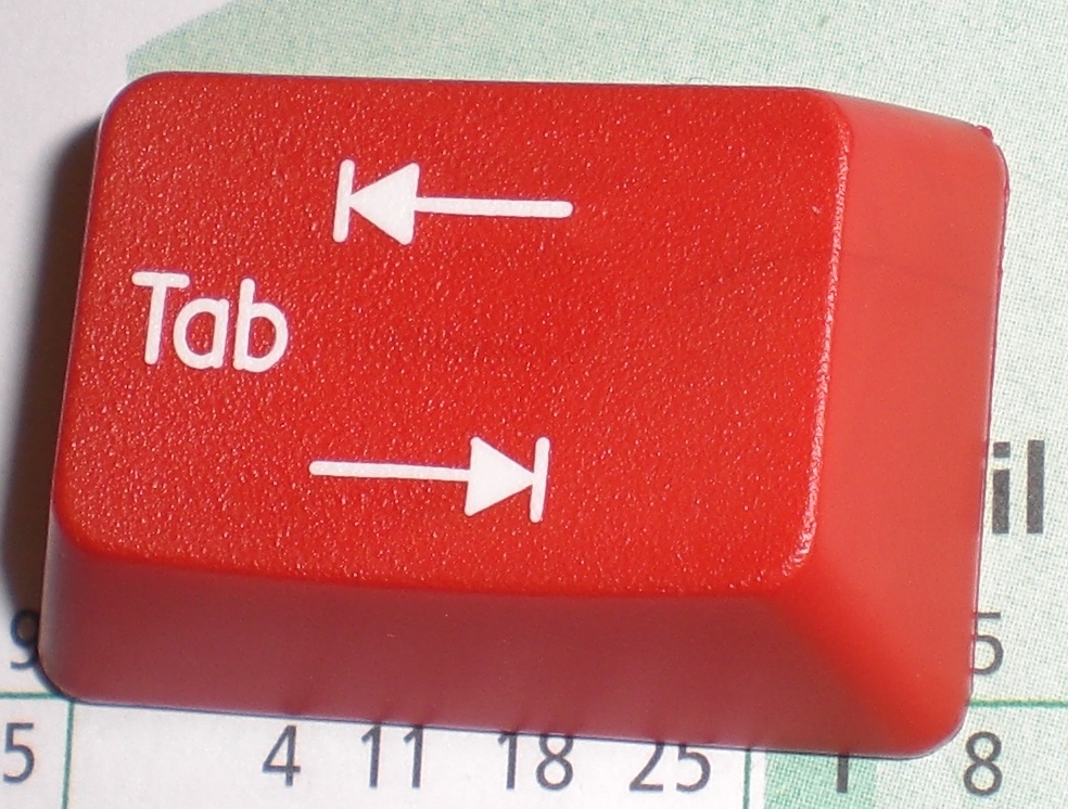

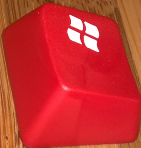

Thanks to customs, i received my set yesterday. when i wanted to mount the caps, i realized this (sry for crappy pics, i'm poor):
5034-0  (crack-like-looking darkish line on the right side, hard to see on pics)
another one: 5036-1
all caps have these lines, the bigger ones on top and right side, 1unit keys on the back and some on top. they are clearly visible at daylight. anyone else got this, too?
i wrote to melissa, but she says its due to the color and it happens during production. all they "can do is to suggest using another color next time."  :rolleyes:
(Attachment Link)   (crack-like-looking darkish line on the right side, hard to see on pics)
another one: (Attachment Link)
I had this exact issue with mine and I was told almost all of them have this lattice style pattern, and it results from the doubleshot process.

Yep, that was a known issue with them. The white part of the doubleshot, aka the first shot, has to be a lattice to let the red flow through and around, and if the color combo is a certain way the lattice can sometimes be subtly noticeable in the finished product. Depends on the combo obviously, but it would have happened with any of the reds... and we wanted red mods.
