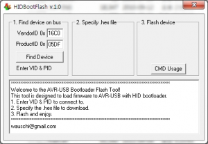

1: After you have assembled The Cheat, set the dipswitches to ON for USB mode.  Hold down the Pause key while inserting the USB cable to your PC to start the bootloader.

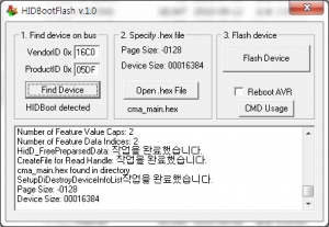

2: run HIDBOOTFLASH
    - Click the Find Device button to detect your The Cheat
10220-0

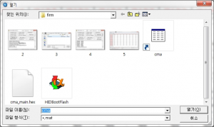

3: Click Open Hex File button

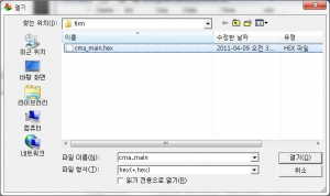

10222-1
4: From the FileOpen dialog, select cma_main.hex.  This is the firmware file
10224-2

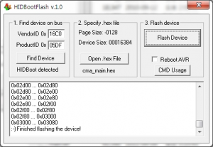

5: Click Flash Device button to download the firmware cma_main.hex file to The Cheat
10226-3

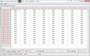

6: Once the firmware is loaded, disconnect and reconnect the USB cable.  Start the Aikon client, it should find your keyboard, you need the filter driver installed for the client to work.  (Note: The Cheat has no keyboard map by default)
10228-4

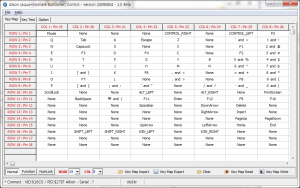

7: Click the Import button to import the cma.mat map in to the Aikon client.
10230-5

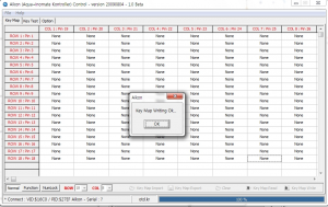

8: Click the Key Map Write button to download keymap onto The Cheat.
10232-6
