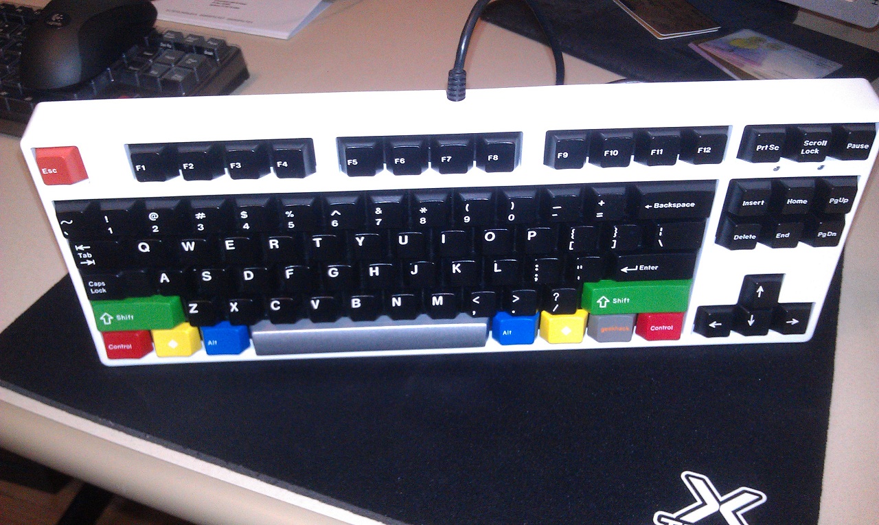

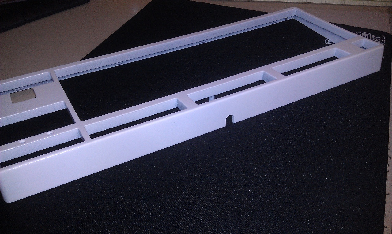

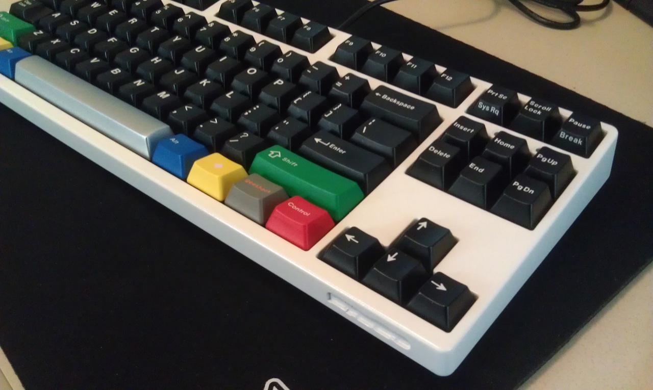

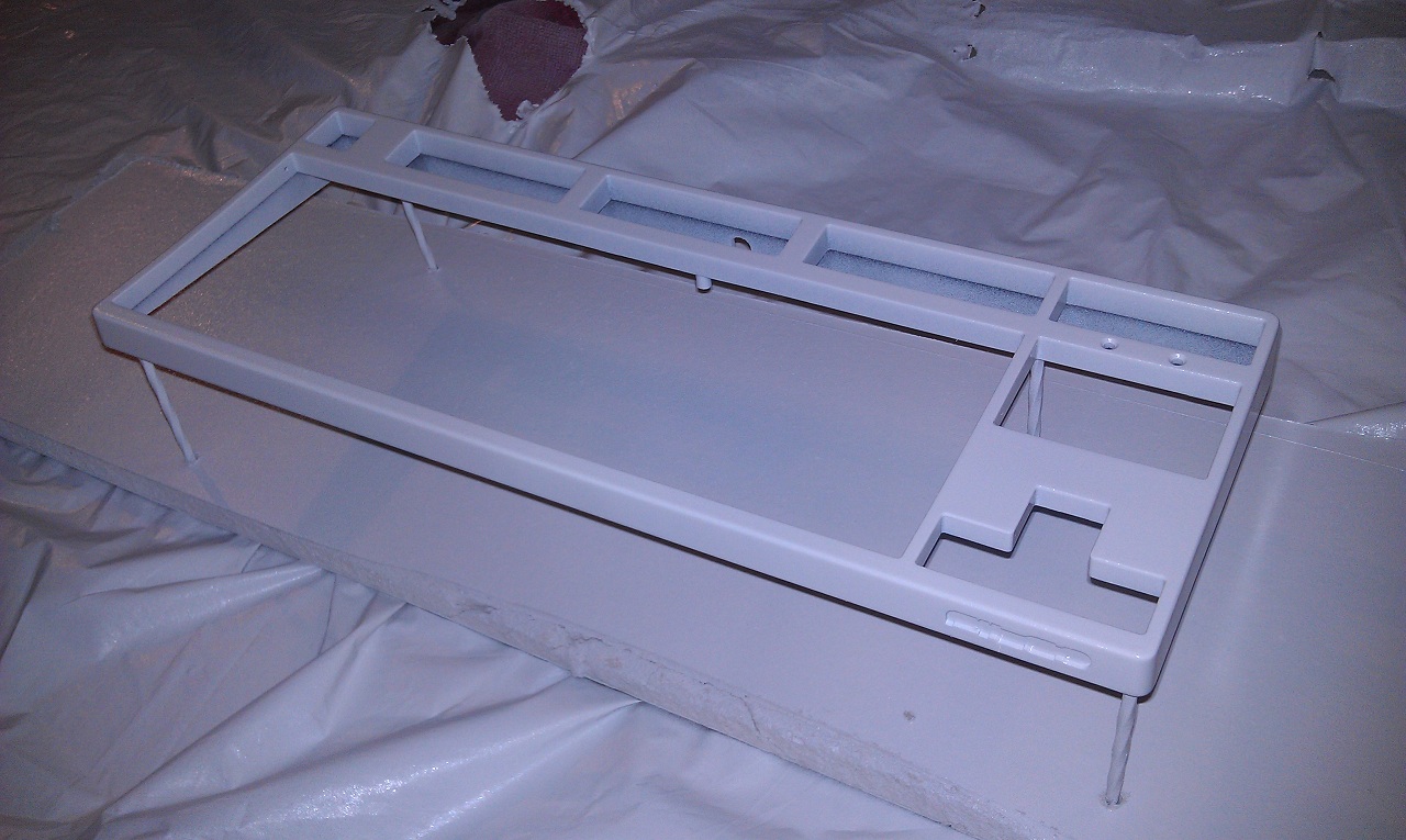

I wish I had taken some photos of the case after sanding. :( Anyway, here is a photo of the case just after I applied the last coat.
10285-0
I cheated a little bit and took a picture after it had only been drying for 5 days...
10578-1
Isn't that classy?  I love it.  If only the Alu space bar came in black :)

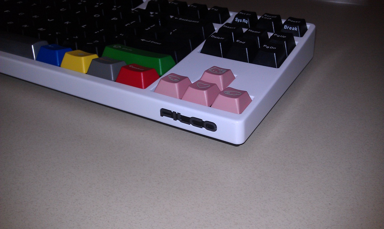

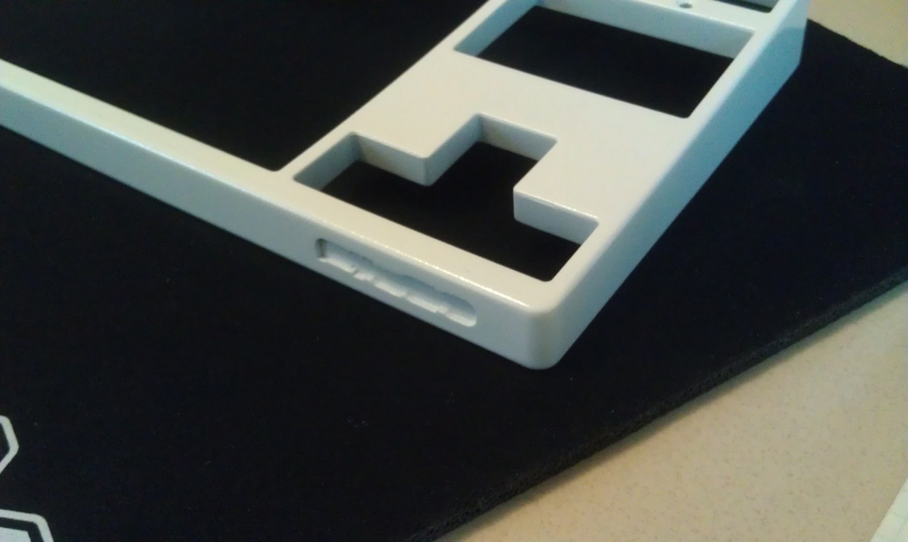

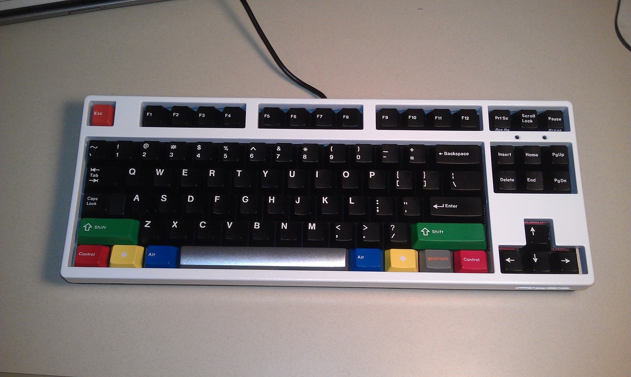

Okay done drying, here are the pics...
10673-2
10675-3

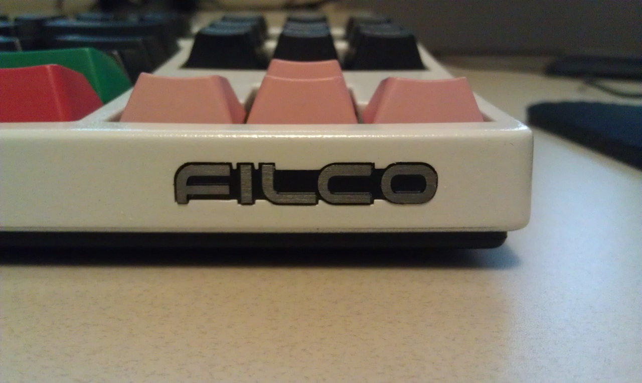

Such a potato I know.  I'll mount the logo after a little more time.
10677-4

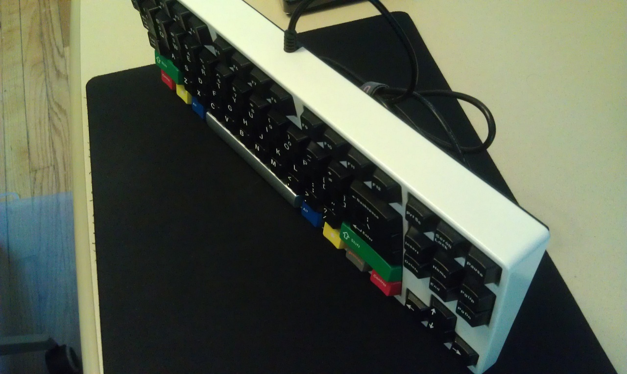

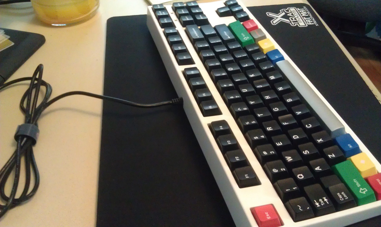

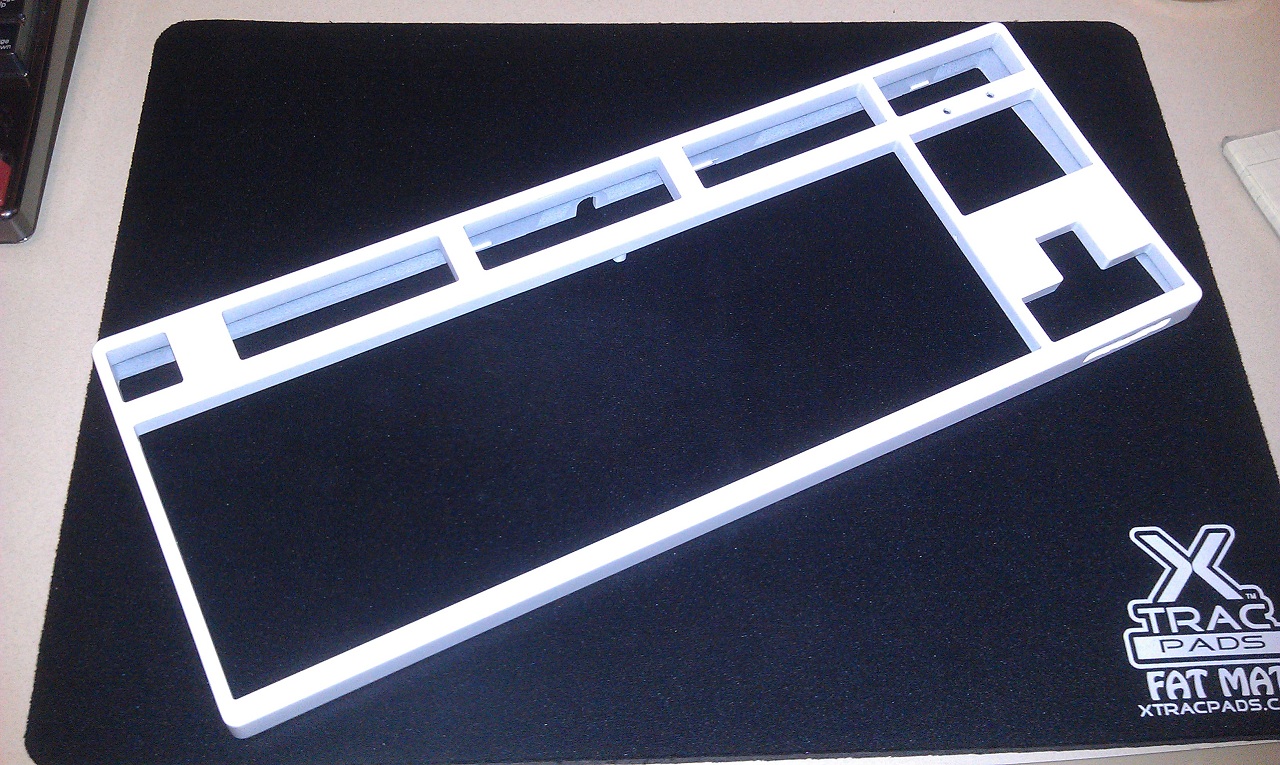

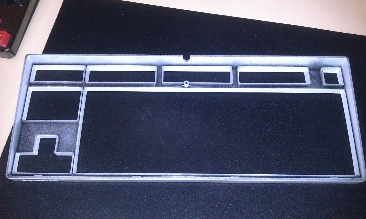

Here is the bottom.  An awful lot of paint managed to get up there, even though I was always spraying from the top.
10679-5
10681-6

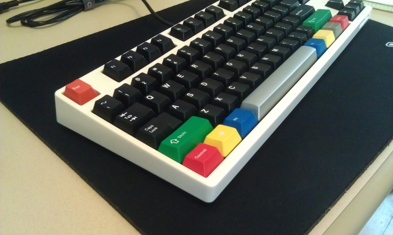

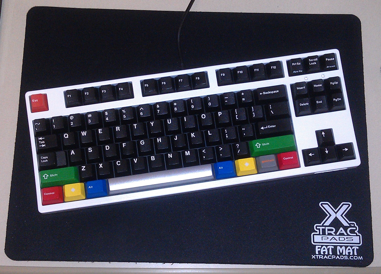

These are Cherry keycaps from Inlikeflynn's pile of MY boards, Feng aluminum space bar, Cherry red esc from EK, a Hashbaz RGBY kit, a geekhack key from the recent fund raiser, and one of !3oiler's center/stepped caps locks.
10683-7
10685-8
It is very white, which is what I wanted.  None of this beige business.  I wanted it to really bring out the white legends.
10687-9
10689-10
My camera isn't good enough to show the imperfections, but there are a few.  I'm still very happy with the results.
10691-11
I like this shot because it shows the myriad of imperfections.  I'm such a noob.
