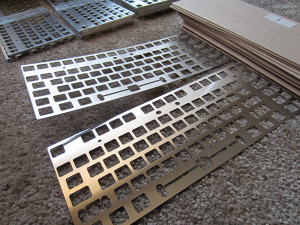

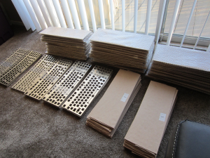

Here are all the plates before I started shipping. All plates sourced from me were individually wrapped by the company, all plates from beast will come bare.

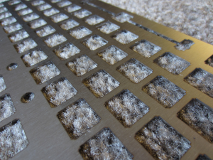

Here's the noticeable bend in plates from Beast. Again, you must straighten it out before installing. Plates from my source are already flat, ready to install.

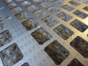

They don't have the same surface finishes, so here's just a comparison. My source is line-grained going vertical and more smooth and reflective. Beast's source have the brushed finish going horizontal, look a tad whiter and less reflective. Beast's plate will also be some scratches, so I'm just letting you know these blemishes in advance.
22829-2 22831-3

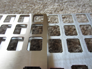

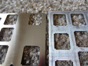

The bottom on Beast's plates have some track marks from the time saver machine. They also have blow-out marks from the molten steel during the cutting. These are on almost every hole, so just be careful you don't cut yourself on these marks. You can peel/pry them off if you'd like. Plates from my source have a very small burn outline on the bottom. No other marks.
22833-4 22835-5

It would be extremely hard to break a plate bending it straight. You simply place the edge on a table and gently apply pressure to the middle of the plate until it sits flat on a table
This didn't work for my Poker plate. I even put the plate between two flat wood boards and put approx. 30kg weight on it. Left it for 2 weeks. Still looked the same. I angrily bent it by hand in mid air. I roared like Bagger 288 while doing so.
To be honest, I'm glad I got my plate from WFD's cutting shop, I just hope it won't bend during transit.
Re: Phantom PLATES (shipping)
« Reply #406 on: Wed, 22 May 2013, 18:50:55 »
Yes I don't see how laying it flat could possibly straighten it.  Steel is way too springy for that.  You have to bend it in the opposite direction (carefully)
Exactly this, you need to push it the opposite way of the bend to make it flat
It's not hard, doesn't require a lot of force and can be done in 5 minutes max
