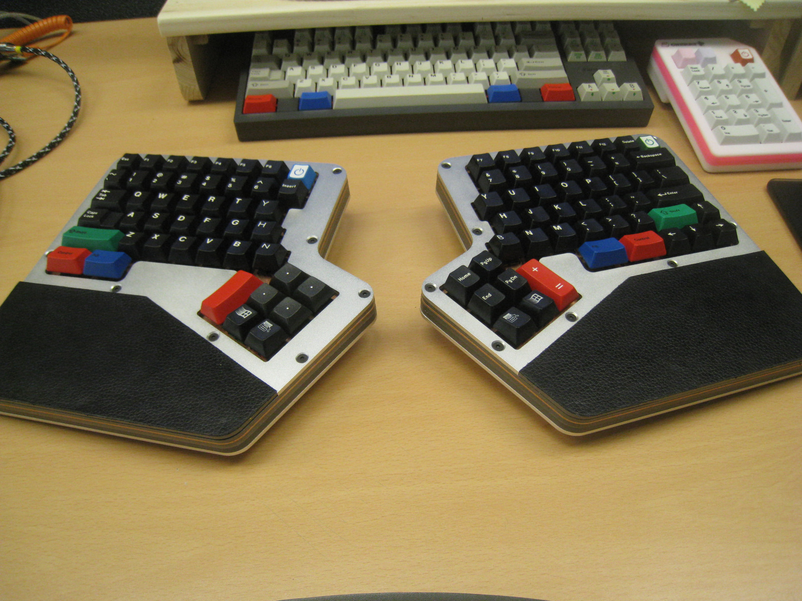

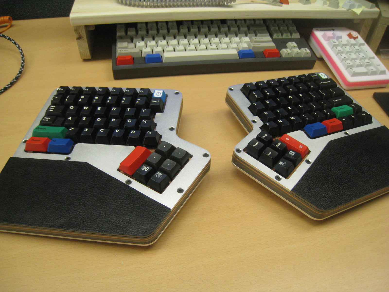

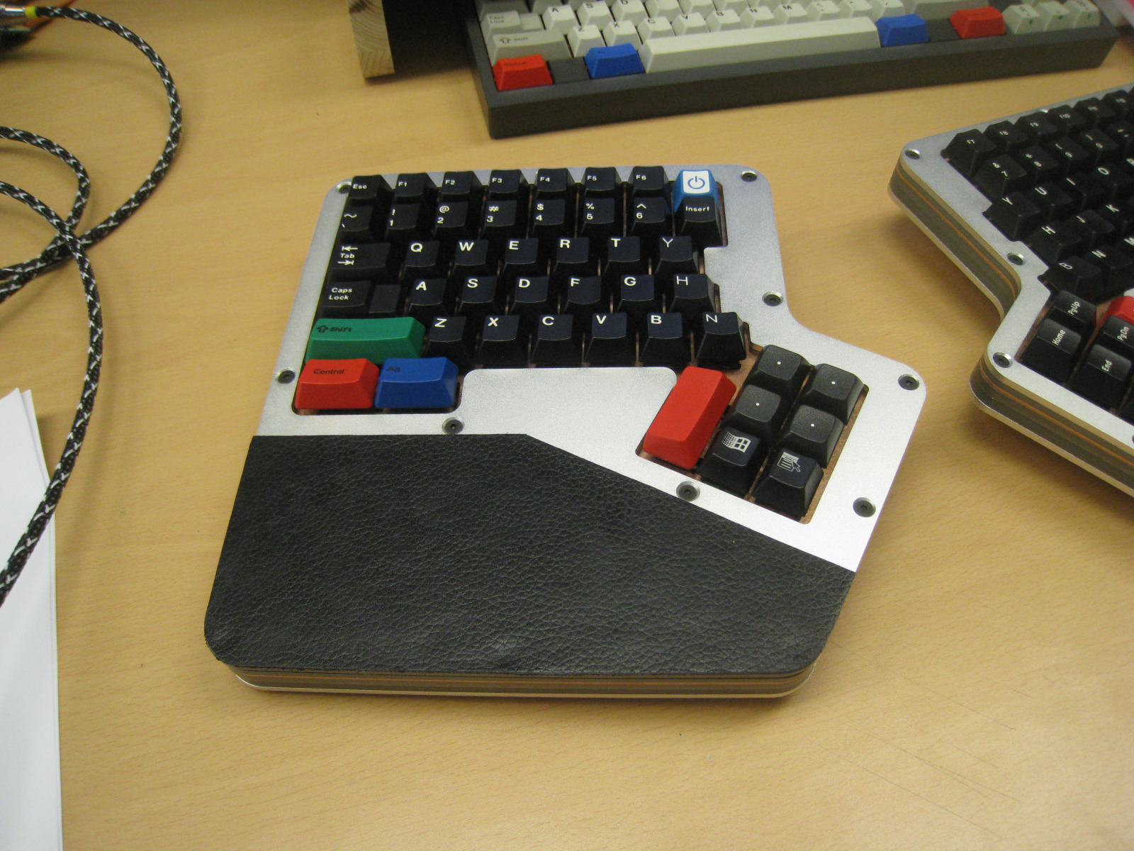

This is my own ergonomic keyboards. Yes, it resembles Ergodox :(
Actually these are two of half-size keyboard but this works just as one single keyboards perfectly thanks to Logitech's Unifying tech.
It can pair 6 of devices at once.
Here is the spec.
Logitech k230 controller x 2

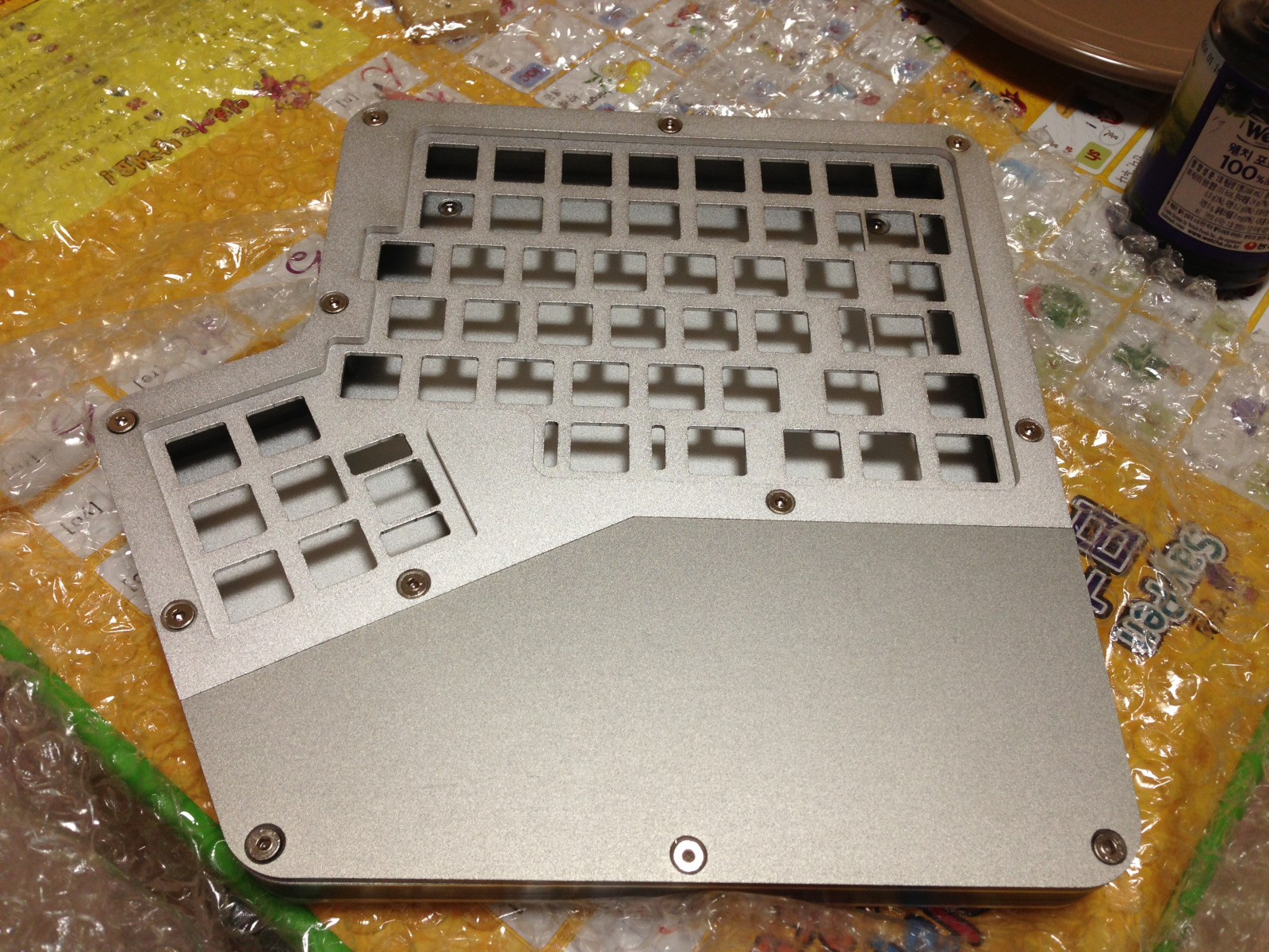

Vintage Black switch
Layered Aluminium housing
Cooper Plate
Leather palm rest
14896-0
14898-1
14900-2

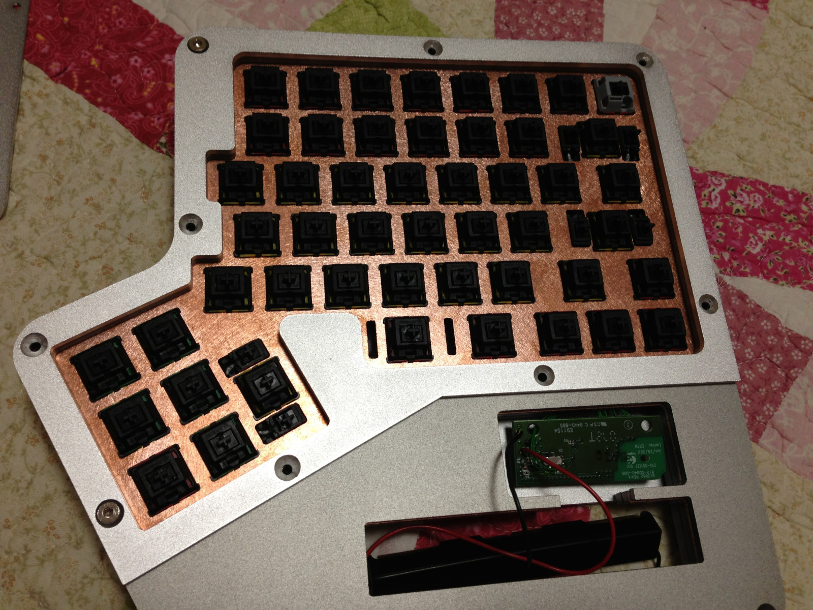

===================  More details  ===================

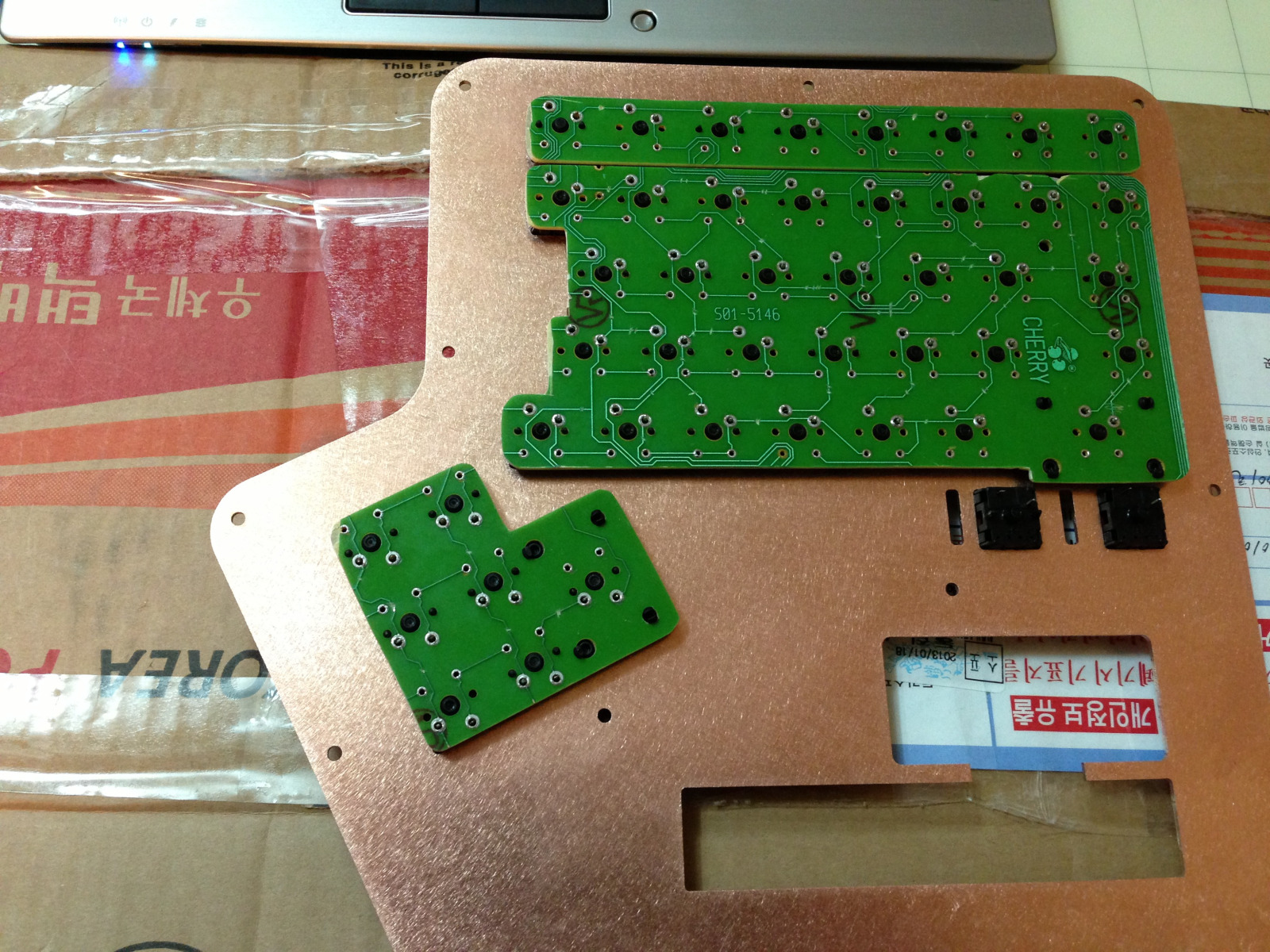

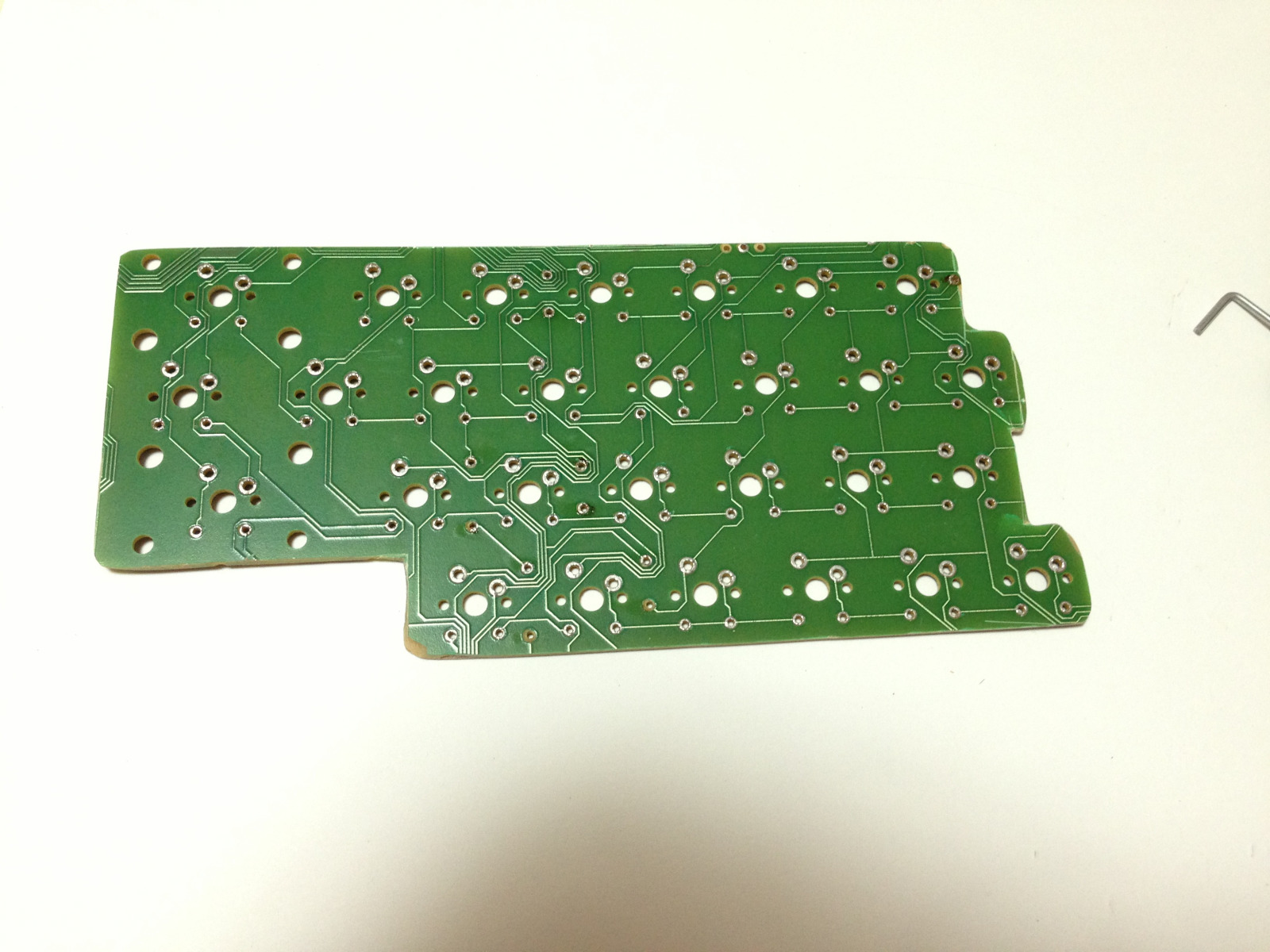

Sliced anonymous PCB
15037-3

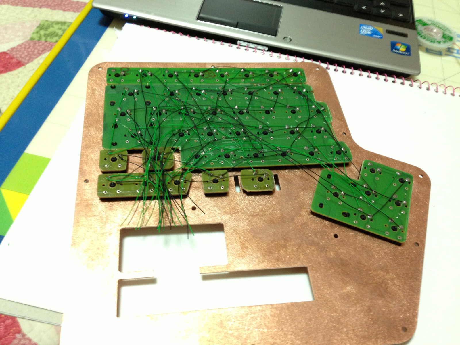

Soldering switches
15039-4
Do some dirty wire job :(
15041-5
Here comes the K230's controller and battery
 - It lasts 3 years according to Logitech, I guess it last more than 1.5 years at least.
15043-6
Rare housing
15045-7

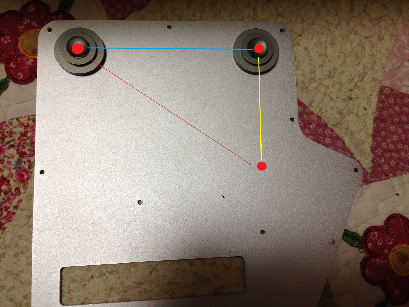

There are three holes for Bumpon
 - It makes three different angle of (Top\Bottom, Left\Right, Top-Center\Bottom-Side)
15047-8
Like this.
15049-9
In cost point of view
Alu housing and cooper plate : 180$ (I did alone and it make the price incredibly high :( )
                                                 maybe 5~60$ If I did with acrylic plastic
PCB                                         : 0$
Controller                                : 0.9$ x 2 (This is the market price of K230 keyboards)
Switch                                     : 50$ approximately
Key caps                                 : 40$ approximately
Leather                                   : 2$
Hardness
Yes wire-ing was hard as you can see the hell. But others were piece of cake.

this is honestly really good. did you design and build it yourself?

Thanks for sharing. I can see the appeal of keeping the staggered layout as well as all the modifiers similar to that of a normal keyboard. I can imagine it doesn't take much effort to dive in and use the keyboard straight away. The fact that its totally wireless is pretty awesome.
But I do think from an ergonomic perspective, the layout isn't optimized. Modifiers still require the use of pinkies, and that thumb cluster seems a little awkward to use, especially the middle button. It seems to places more strain on the thumb than a normal keyboard does.
Keeping the modifiers at the same positions is good and bad at the same time. Good because the user doesn't need time to adjust to a  new layout, but bad because it doesn't alleviate strain from the pinkies.
How does it fare in terms of actual usage?
| Ergodox #1 | Ergodox #2 |

yes, this is split wireless keyboards rather than optimal ergonomic.
Here is why,
#1 wanna use anonymous PCB simply. Re-arrange layout needs lots of effort.
#2 wanna use normal keyboards altanately.
      - this is main reason :)
      - optimized ergo layout may chang a lot fot typing memory.
Pros.
#Fits anybody's should and comfortable thanks to spliting and wireless design.
#This has angle like cherry 5000 series. Which means center-upper side is high and left/right-bottom corner is lower.
   It makes wrist comfortable as well.
Con.
#As Lanx and Larken commented, Pinkie fills oddity cause it has "V" shape consiquently.
Keys for pinkie are slightly far from nutral position.
For thumb composition, these keys are rarely used except space bar. Spacebar is on perfect position so it keeps wrist angle nutral. Others? I don'care it is just cosmetic reason.  :D
As you can see on liked page, thum composition uses PCBs on number pad of any key cherry keyboards.

I want to, sorry but I did not take a photo of it.  The PCB is from anonymous cherry keyboards and cut as the plate's shape then fully wired.

Very nice craftsmanship leeku.  Thank you for showing us how to make your keyboard.
I have been looking for a keyboard like this.  I like the design and want to build one.
I appreciate it if someone could answer these build questions:
1) What is the advantage of using the PCB compared to using just a mount plate and soldering wires directly to the switches?
2) What is the advantage of a making the mount plate out of Cooper?
3) Can you hit all the thumb keys individually without moving your hand backward and forward?
Thank you.
« Last Edit: Sun, 24 March 2013, 07:40:31 by wolfv »
Offline leeku
  • Posts: 164
Re: my own wireless split ergonomics keyboards.
« Reply #28 on: Wed, 27 March 2013, 08:01:40 »
Thank you.
1. It makes soldering wire easier, in my case at least. And it is risky to pull out the keycaps without PCB. The wire inside might be cut off.
2. No. It is just a sort of taste. It weights more that Aluminium though.
3. No. Only space bar is reachable at neutral hands, but others are not comfort actually. :(
As I mentioned above. This is a wireless split keyboards rather than real ergonomic keyboards.
I compromised at this point because of my other classic keyboards.
ps. I have a plan to build a PCB which has matrix pattern for K230 controller inside.
