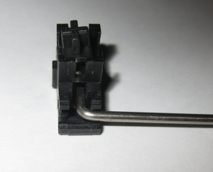

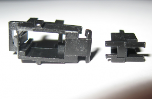

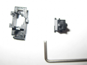

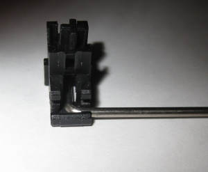

Ok, the light is pretty low here, but hopefully these may help some (click on them to enlarge):
36346-0
36348-1
Ok, these 2 pics should be the same orientation as your picture. The wire should eventually go into the lower of the 2 gaps, the one that  isn't a full square hole.
36350-2
This is from the back, this is the side you shouldn't be trying to feed the wire into.

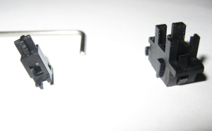

36352-3
Underneath, you should be able to see a little square inset, which ties into the thinner leg on the + piece. Thats why it will only go in one way.
36354-4
This is with the + piece inside the main piece. You can see the wire could in theory go into both holes but really it should only go into the lower one.

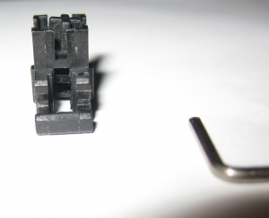

36356-5
This is with the wire inserted. The wire should clip into the bottom, but not until it is pushed into the hole.

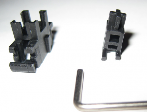

36358-6
And this is with the wire clipped back into place. Finished.
Hope its some help, and not simply made it more confusing :)
