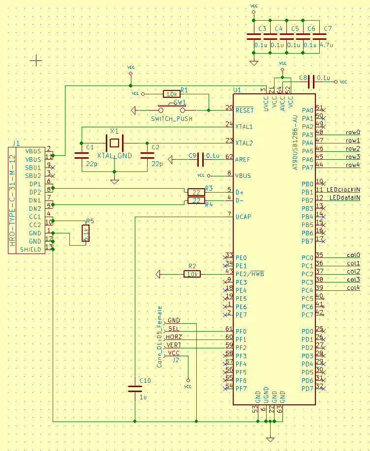

Offline rickylago2
Re: The Living PCB Design Thread
« Reply #807 on: Wed, 20 February 2019, 15:42:16 »
I've just stumbled on this thread via google search, and I've got to say reading through it has been massively helpful. Lots of good information here!
I'd like to get some verification from anyone who might be more knowlegable than myself. I've got a lot of experience in hardware modification, but as far as designing my own goes, this is basically my first project. My main goal here is to make a 25 key macro keyboard with an analog joystick on the thumb and per-key RGB lighting using APA102-2020 mounted under RGB cherry switches all connected via Type-C. I've pieced together information from about a million sources online, and I think (or hope  :p) I've set everything up correctly in my schematic. A few specific questions I have about my design so far though:
1) Am I correct in assuming that to use analog signal with the AT90USB1286 I need to have a capacitor on both the AVCC and AREF pins? The datasheet seems to have said this, I mainly just want to make sure I understood it correctly.
2) I know that power over USB can be a concern with the addressable LED like I've chosen. It looks like each runs at 20mA at full brightness, which would max out the 500mA available over USB. If I simply run them at half brightness or so, would this cause power issues still?
3) I've set up my decoupling separate from the chip, similarly to how it is done in the github tutorial that a lot of people reference. I've seen this done a few different ways in this thread and other projects. Should I be setting this up differently to make things easier?
4) In my Type-C wiring, I've connected the CC1 and CC2 pins via 5.1k resistor to ground. I've seen it done this way and with both pins having their own resistors. Is how I currently have it set up sufficient? 213365-0
Thanks in advance for any help. like I said, I have some experience physically modifying existing things, and I have plenty of CAD experience, but PCB design is still pretty fresh to me.

« Reply #810 on: Wed, 10 April 2019, 15:48:57 »
1. I think you need to read up on how the analog stuff works. I've never used the ADC functionality myself, but you still need to supply AVCC with power, just more decoupled than VCC in general. Also AREF needs to be connected to some reference for the analog signal in some way, decoupled with a capacitor (at least) probably.
3. The schematic doesn't really care where you put them. What's important is where you put them in the actual layout. Close to the supply pins (very low impedance) and solidly (low impedance) connected to your power source.
Edit: Apparently (reading the datasheet) you can use wither AVCC or an internal 2.56V reference as Aref, and then use only an external capacitor to GND like in your schematic to make it more noise immune. Or you can use an external reference (also decoupled to GND). But AVCC should always be at VCC+-0.3V maximum.
« Last Edit: Wed, 10 April 2019, 15:56:17 by bpiphany »

I made a simple pcb as a project to work with qmk and rotary encoders. The pcb uses an ATMEGA32u4-AU MCU. I modeled the schematic after the pro micro, and followed ruqimao's tutorial. I have the ability to prototype pcbs fairly quickly, so I can make a new version easily.
When I plug the usb into the computer, I get the error Device Not Found.
Things I have tried:
Grounding HWB pin
Pulling down HWB with 10kresistor
not connecting HWB pin
I have poured many many hours into this project and am losing my mind. When I plug a pro micro in, it shows up as an atmega32u4.
Any help would be greatly appreciated
236187-0
Love yall

does the mcu come with a bootloader?(usually do) remember you can't flash them like a dev board, you need to use the appropriate software for atmel-flip.
dfu-programmer atmega32u4 erase --force
dfu-programmer atmega32u4 flash <file.hex>

it should upload fine over usb. isp is really only a last resort, or for a device which doesn't use usb.

I believe you have uCap wired up incorrectly. For a "bus powered device" it should connect only to GND through a 1µF capacitor.
section 21.3.1
http://ww1.microchip.com/downloads/en/devicedoc/atmel-7766-8-bit-avr-atmega16u4-32u4_datasheet.pdf

Thanks all for chiming in. Going to tinker with this on the weekend, gonna have to jump a pin through a cap to try it. Will report back
Love yall
