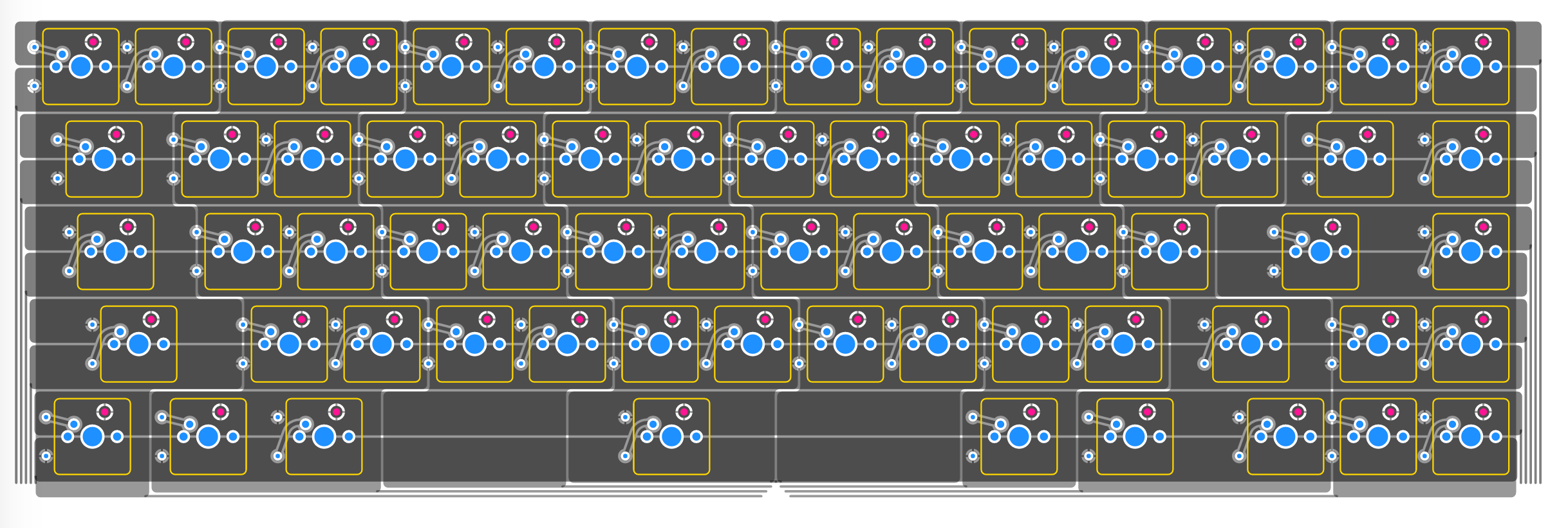

Hey all.  I am new to this thread. I have not touched anything on the electrical side of building keyboards, and have only built boards based on PCBs designed by others.
I am the developer behind http://builder.swillkb.com.  Ironically, I started it because I was not confident in my cad skills and thought I should automate the plate layout.  Now it does quite a bit more than I was expecting when I started, but I have always had the pipe dream of being able to produce a PCB that goes with the layout specified.
The biggest hurdle I think I am going to have with this is the auto routing for the pcb.  I am only just starting to look into what I would need to do to even get something primitive built.
So my question is. What algorithms should I be researching, and what auto routing systems are best suited to designing keyboards. I know the following exist, but not much beyond that.
Maze router,
Line probe router,
Channel router,
Area routers,
Switchbox routing
Given my current skill level, I will probably have to spend a couple months just learning stuff. I would not expect to actually have anything written for about 6 months and really, who knows at that point.
If anyone has resources you can share that you think would be required reading for me, please share a link. If you have ideas or suggestions, please let me know as well.
Thanks for the help everyone. Happy new year. If you have not checked out the builder recently, you guys may be interested in the new custom polygon features I finally finished adding to the builder over the holidays.

For my project, the keyboard controller is not going to be on the same board as the key switch matrix, so that simplifies things quite a bit for me.  Also, I have no interest in LEDs, which also simplifies my problem.  I am trying to avoid the general trace routing problem altogether by sticking to a simple design with columns on the front and rows on the back.  Right now I am basically cloning the TrueFox layout.  It's not exactly the layout I want, but it is close, and I can get the keycaps for it, so it's a good start.  The obvious matrix would be 16 columns by 5 rows, but that is an inefficient use of 21 GPIO.  So the most interesting thing that I think I am doing is using an 8x10 matrix where the columns are sort of folded in half and there are two matrix rows per physical row of keys.  Also, I am using copper pours for the rows and columns, which makes it easier to embed a key module without worrying about routing traces.
I have a long way to go, but maybe this image of my work in progress can help explain where I am going with it.
156665-0
Sorry if that is hard to read.  My code is a broken refactoring mess right now and that is the only image I have around to share.  This is my first post and I'm a noob with forum software, so I hope the image shows up...
-JR

ok so what are you going to use as a controller diodes and other components?
do you have pcb models for different switch types?
led holes?
So right now I don't have anything, but I do have an idea of the things I will need.  I don't have modules built yet for switch and led layouts.  I will likely do SMD diodes and resistors (for LEDs, when I support them).  Ideally, I would build a standard footprint I use for every switch and use it everywhere.  That will make things easier from the dev side.  I have not talked to MOZ or Melvang about this yet, but I basically want to use something like a simplified Enabler PCB as the base switch component.  I know through hole is less daunting for builders, but I think most people are capable of soldering SMD (I was without much practice).  I think it is probably important to support SMD because it makes it easier to automate pick and place of components.  If people end up running small group buys based on the output, I think it gets us one step closer to a fully automated process.
The controller is a bit of a different story.  I would ideally like to give people options, but I have to start somewhere.  The ones that are on my radar would be something like; the SMD footprint for an ATMEGA32U4 (or similar), through hole pin set for the teensy (or similar).
My goal is to help enable builders and people with ideas to make it happen, so I am trying to solve the lowest common denominator with the most value to start with.  Then we go from there...
To me, the auto routing is the biggest blind spot for me.  I know it is possible, but I also know it is non-trivial, so I have to get comfortable with how I am going to solve that before I get to deep into the weeds on some of the other pieces.  With the builder right now, I have the capability to draw vector files (svg+) and I already have the location of all the switches.  It would not be hard for me to start with a drill hole output, or even draw essentially the enabler at every switch location and just not route it.  Obviously not an end game solution, but it is a start.  It gets me to the point of being able to produce something of value.  With that as a starting point, I may be able to output as KiCad and people could manually route the pcb.
Anyway, this is longer than I was planning to write.  There is a lot of ground I have to cover before I get to an end game solution, but I think there is probably a lot of value in some of the baby steps.  :)
ok how many layers are you wanting to use?
i would make the switch with diodes and everything a module for the switch
the issue i see is the matrix and getting a schematic from the layout and making sure that they are wired correctly in a schematic
kbparadise v60 blues

Yes. I have to have a way to verify the wiring works as expected.
Right now I am planning to use 2 layers.

ok what cad software are you using for this?
Right now, I am not. I have basically built my own cad engine from scratch in Golang because everything I found was bloated and not friendly to be automated.
For the electrical stuff I will probably have to find an engine I can work with. Ideally open source, or at least free, which I can package with my deployments. Do you have suggestions on this front?

Hi swill and everybody.  I'm new to this thread too, and to geekhack and to the mechanical keyboard scene.  I'm pretty blown away by all the great stuff going on here.  I am working on my own keyboard project and, like you, I have ended up working on software to generate drawings instead of using CAD tools.  Your plate builder was definitely an inspiration to me!
I spent some time trying to learn KiCad, but it drove me crazy with its terrible interface.  And so much of the layout of a keyboard PCB is just begging for automation, I decided just to learn about the Gerber format and develop some code to generate my PCB artwork directly from keyboard-layout-editor data.  I was also inspired by the work at http://pcbmode.com.
-JR
Cool. That looks like a fun project. What language are you developing in?  How have you found the Gerber format to work with? I was also planning to export a Gerber file.  Are you building everything from scratch, or are you using some sort of engine for designing the components and exporting the final files?
I am working in Python and I'm writing everything from scratch.  I don't know of any libraries for building circuits with code, other than the scripting interfaces for things like Eagle and KiCad, and I decided I didn't want to get tangled up with those.  After I get the key switch PCB finished, I will have to decide what to do about my controller board.  Will my code be functional enough to use for that?  I plan to prototype a controller on a breadboard first, so maybe I will try Fritzing for that board.
Gerber has been enjoyable.  I am not writing any Gerber output yet, but I am building all of my internal data structures based on the Gerber file structure, so I expect the final output to be a simple process.  The format has some entertaining terminology quirks because of its history as a CAM format for old photo plotters, but basically it is a simple vector graphics drawing format.  The documentation is very good I think.
I did the original builder (https://github.com/swill/kb_builder) in Python (and FreeCAD), and I got sick of dealing with the crap of a cad software, so I just started from scratch in Golang.
I was chatting with some guys on the kicad IRC, and they basically recommended that I just output to whatever file format I want and skip kicad all together if I want to automate anything.  I had a look at the kicad "api" and its not really an API. It is basically a swig wrapper around the C++ code, so that's not really a good option for me. I could embed the C++ code directly into golang, but I think I am probably going to start by just building from scratch.
My code already works natively with the svg format and I have a pretty good set of polygon features now too. I think I will start by doing svg to Gerber. I see that pcbmode already has that feature, so I can probably understand the conversion from that. Thanks for the link.
This is going to be an interesting project.
BTW, I like your idea for the 8x10 matrix, that's a good idea. Not doing a controller on the board is smart to start with to reduce complexity. Are you just going to do something like a teensy header pin layout in through hole?
I like your project and approach. I think our projects have a lot in common. :)
If you can output the center point of each switch that would make placing the switches and other components a lot easier as kicads placement allows for direct input of the XY location value of each component. I always do it the harder way and get a spreadsheet going and math and 19.05+19.05 and 19.05/4 ugh brain hurts just thinking about it.
Haha, yeah it sounds like both of us would rather spend six months writing our own software than six weeks learning to use ugly software.  No offense to any KiCad fans out there, but, ugh.
My project isn't actually a PC keyboard.  I am making an all-in-one style computer around Raspberry Pi.  So under the keyboard, I'll have the RasPi "motherboard" plus a secondary interface board that will have the keyboard controller as well as some additional interface circuitry, like joystick connectors and maybe a secondary SD card slot.  I'm going for an old school home computer type unit of the 80's.  So the keyboard PCB itself will just have a header connector for connecting to the interface board.  I am making everything through-hole for easy soldering and because I want it to be something you can open up and look at and understand and tinker with.  So, kinda retro.  I think I will be able to use a 28 pin DIP ATmega328P for the controller.  Basically an Arduino.  It will talk to the RaspPi over I2C or SPI.

Offline 27.9.2016
  • Posts: 18
Re: The Living PCB Design Thread
« Reply #477 on: Thu, 12 January 2017, 16:25:24 »
My DIY project
What do you thing does it look good? I am planning on etching this PCB by myself with UV process  ;D

Offline bpiphany
  • Posts: 1033
  • Location: Stockholm, Sweden
« Reply #478 on: Fri, 13 January 2017, 15:09:00 »
It looks alright, it looks auto-routed.. You could clean up a few wacky vias around the Teensy. With a little bit of effort you could probably straighten a few more things out by re-arranging some more. But on the other hand it will surely work, and time can be spent better =) If you etch at home you may want to increase the trace widths to add some extra margin.
If you're not etching a double sided board you may also want to try to move more of the traces to the same side. I would put all traces around the Teensy on the bottom. Otherwise it will be hard to solder (on a single sided board). The long straight horizontal traces would be easily made from jumper wires, if on the back.. I can't say straight that it's feasible to "reverse" the layers like this, that would take some more experimenting. Silly me, jumpers can of course be placed anywhere =P Also drilling PCB laminates is a b****, and you need to be very accurate for the switches to sit straight. And you need really good alignment if you're doing a double sided board. But hey you'll be really pleased with yourself once you finish =D
To save etchant you can also add copper fills, just make sure they are connected to something (GND preferably) and not floating free. That probably wouldn't impede functionality much in this case, but it's considered bad practice..

If I want to use a Teensy 2.0 instead of a SMD, how would I connect a mini USB on my PCB to a Teensy 2.0?
Predispose a USB connector and a header with 5 pads on your PCB, cut a USB mini cable on the type-A end and solder it to the header, finally connect the Mini-B end to the Teensy.
The picture below should give you the idea.
