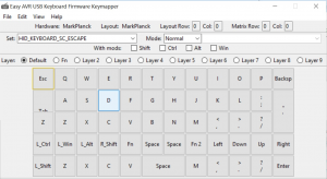

I'm finding it really difficult to understand the LED mapping stuff.
Here's a picture of what I'm trying to achieve with the LED mapping http://hrltz.co/13iHQ+
Should there be more options in these dropdowns?

Offline a-c
  • Posts: 196
Re: Easy AVR USB Keyboard Firmware and Keymapper
« Reply #1984 on: Sun, 16 October 2016, 11:08:34 »
Code: [Select]
avrdude -c usbasp -p m32u4 -U efuse:w:0xf3:m -P /dev/USBasp
avrdude: verification error, first mismatch at byte 0x0000
         0xc3 != 0xf3
avrdude: verification error; content mismatch
avrdude: safemode: efuse changed! Was f3, and is now c3
Would you like this fuse to be changed back? [y/n]
Pressing yes results in it hanging, no leaves it as c3.
Any help would be much appreciated :thumb:
That's normal. Just pick No. The efuse does not use all the bits and avrdude gets confused when reading it back. http://www.avrfreaks.net/comment/1195856#comment-1195856
You will have a problem with the Arduino Micro. The HWB pin is pulled low which affects how the bootloader is triggered. Boards running the Atmel DFU bootloader have HWB pulled high.
Offline mark.wood_uk
  • Posts: 34
  • Location: Aberdeenshire, UK
« Reply #1985 on: Sun, 16 October 2016, 11:20:54 »
The problem is you're in the wrong file - you need to change the .py file in the boards directory.  The .cfg file is used to make adjustments so you can hide keys (as you've discovered :))) but you can't add new ones.
I'll say no more as you want to learn...
yep, lol. I had kinda clocked on that the .cfg was only to 'adjust' what is visible in the gui...
Whilst i was waiting on Python to download i was having a mooch round the directories and found tucked away in 'Libraries.zip/easykeymapper/boards/'  Planck.pyc  but as far as i can figure .pyc is compiled and according to the google box its not yet possible to de-compile above 2.5 as yet?
However it has just this moment occurred that i'm trying to mess around with a file that has not yet been extracted (which generally screws things up anyway *slaps head*)
So i'll get those files extracted now and try some more fiddling about!
Ps. I kinda gave up on the Teensy 3.2 route and ordered a couple of 2.0's instead, so don't worry i'm fully aware this is for AVR and not ARM chips!
So i have 1 unused 3.2 and one that's just been de-soldered if anyone is interested!
Edit:
Un-edit
« Last Edit: Sun, 16 October 2016, 11:35:34 by mark.wood_uk »
  • Posts: 4771
« Reply #1986 on: Sun, 16 October 2016, 11:32:08 »
Ah, windows binary version!
You'll need to get the .py from here, rename it, and save it in c:\users\[your username]\EasyAVR\boards then open it in notepad and change the name at the top.
  • Posts: 34
« Reply #1987 on: Sun, 16 October 2016, 11:38:02 »
Ahhh, Thanks  :thumb:
Sorry, forgot to mention ive gone back ti Win with this... i was having problems getting keymapper to compile in Ubuntu!
I'm fairly noob with Terminal and nearly a non starter in C
Edit:
Mostly sorted!
150563-0
When i remove the labeled line from the .py it seems to move everything 1 step to the left on the 2nd row... is that now what i should use the the .cfg to rectify?
 ((4, 8), (1, 11), 'HID_KEYBOARD_SC_APOSTROPHE_AND_QUOTE')],
    [((4, 4), (2, 0), 'HID_KEYBOARD_SC_Z'), ### --THIS LINE-- ###
     ((4, 4), (2, 1), 'HID_KEYBOARD_SC_Z'),
     ((4, 4), (2, 2), 'HID_KEYBOARD_SC_X'),
     ((4, 4), (2, 3), 'HID_KEYBOARD_SC_C'),
     ((4, 4), (2, 4), 'HID_KEYBOARD_SC_V'),
     ((4, 4), (2, 5), 'HID_KEYBOARD_SC_B'),
     ((4, 4), (2, 6), 'HID_KEYBOARD_SC_N'),
     ((4, 4), (2, 7), 'HID_KEYBOARD_SC_M'),
     ((4, 4), (2, 8), 'HID_KEYBOARD_SC_COMMA_AND_LESS_THAN_SIGN'),
     ((4, 4), (2, 9), 'HID_KEYBOARD_SC_DOT_AND_GREATER_THAN_SIGN'),
     ((4, 4), (2, 10), 'HID_KEYBOARD_SC_SLASH_AND_QUESTION_MARK')],
Also, I altered a few bits at the beginning of the .py (which seemed to make sense to me) was i correct to do this?
description = "MarkPlanck"     ##Changed-default layout name in the keymapper##
unique_id = "PLANCK_002"    ##Changed from PLANCK_001##
cfg_name = "planck2"           ##Changed from planck - which now points to planck2.cfg to modify the key layout ##
teensy = False
hw_boot_key = False
display_height = int(4*4)
display_width = int(12*5) ##Changed from 12*4 to 12*5##
num_rows = 5  ##Changed from 4 ##
num_cols = 12
although i'm not sure if i need to alter the
'Matrix_hardware'
'Matrix_strobe' and
'Matrix_sense'
lines to accommodate the new row or does that just work its own magic now?

  • Posts: 4771
« Reply #1988 on: Sun, 16 October 2016, 14:15:31 »
You need a (4, none, '0') instead of the extra Z to make a space behind the tall key.
display_width should stay 12*4 - this means 12 switches at 4 quarter widths wide.  You have added a row so display_height is the one to change.
You will need to add an extra pin for the extra row but if you can work that out you're doing well - there's a friendlier way of doing it in newer files such as the GH60 which you can swap in.
  • Posts: 34
« Reply #1993 on: Mon, 17 October 2016, 14:51:51 »
I Put the (4, None, '0') in place of that extra line, but it still displays a 'blank' patch over the lower half of the double height key, but i think that it's only affecting the visual layout now?
I just returned the tab to a 1x1 in the .py (i know how its meant to be! getting the keyboard to work right is the important bit)
I did cotton onto the display_height/display_width after a little while and had already fixed that bit by the time i read the post (thanks for clarifying that i was right though  :D)
I think i need to change: 'teensey = false' to 'teensy = true'  :-\
But not sure as it lists 'ATmega32U4_16MHz_SIXTY as firmware' already at the top! (thats a little confusing )
Err, yea lol!
Cant make heads or tails of the hex part, ive ran it through a hex converter to see if i could figure it out that way but still looks like random numbers to me, can't see a pattern! (well not one i could guestimate at any rate)
As far as i can figure it looks to strobe on 5 rows and sense on 12 columns (which seems right without modifying aqnything, although i thought it should strobe on the columns and sense on the rows, but that could just be because diodes are the opposite way round on a real planck?)
When you say i can just swap in from the 'GH60.py (Supports backlight)' is that everything from Line 19-75 then edit line 42/43 to my proposed pins? (as well as the lines i have already changed in this copied .py)
rows=[C7, C6, D3, D2, D1],
cols=[F0, F1, F4, F5, F6, F7, B6, B5, B4, D7, D4, D5]
I believe those pins are all good to use and leaves me 6 usable pins (D0, B7, B3, B2, B1, B0) possibly allowing me to add RGB back lighting in the future since there looks to be backlighting support with that section of the gh60? (was thinking x4 or x6 WS2812B addressable LEDs, nothing fancy just on/off and manual colour change)
And I would also like to say thank you SO much for your help so far, it is greatly appreciated  :thumb:  :thumb:
I have got further in the last couple of days with this and your advice than i have in the last few weeks with the 3.2!
