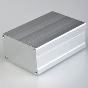

« Reply #23 on: Mon, 30 December 2013, 23:29:40 »
no worries, I actually just found a cheap little aluminum one on ebay that I bid on.

Would a box like this work?
It would, but of course you'd have to work out how to mount the parts inside still, and make sure they didn't short out on the metal!
