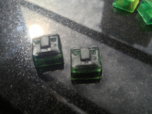

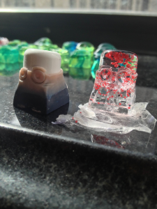

Tonight I toyed around with 2 layer molds, came out pretty well despite a couple of flaws.
The resin I'm using seems to allow light to pass through it when it's back lit, but only when it hasn't been pigmented (it cures white). I thought I might try to "mask" these two keys to see if I could get ONLY the eyes of them to pass light through. In short, this seems like proof of theory with these two designs that this would indeed work:
55561-055559-1
Hopefully this week I can start pouring some translucent & ice resins and see where the potential behind this goes. I'm also thinking it's about time I looked around for some new pigments- these all seem to give me pastel toned colors once cured.

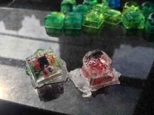

Thank you all for the positive words! Very exciting to hear that you guys like them. Just a quick update with one of my more recent casts that I'm particularly happy with:
56850-0
For some reason, it's very glossy- I have the suspicion that I may have screwed up my ratio a tiny bit on this one, it was also cast without any added catalyst, which might also have something to do with it. Because of the gloss it's hard to tell in the photo, but it's translucent green with vibrant orange flecks near the surface. I wouldn't say I'm thrilled with the quality of the actual cast, but I really like the effect I got on it.
Last but not least, I made my first go at a cast using a pressure pot. I need a solid day to really experiment with this here, I'm still unsure where in the process I should be degassing, I tried degassing once the mold was filled and closed and it basically just went to complete hell- so some experimentation is in order. Any advice here from the more experienced casters would be tremendously appreciated.
Now that I have the degassing tools up and running though, I hope I'll have some really cool stuff to show you all very soon, and probably a few caps to give out too.
« Last Edit: Sat, 08 March 2014, 12:48:52 by Dodgy »

Re: Going to give making caps a shot. Interest check and preview.
« Reply #21 on: Sat, 08 March 2014, 12:58:39 »
if you are doing pour casting with two part molds you want to degas your urethane before you pour.  After pouring you can put the mold back into the vac chamber but you really want to have a more rigid mold, large sprues, and a huge reservoir space.
The rule is generally that mixed urethane and silicone can hold up to 6x its volume with oxygen if the O2 and silicone/urethane were compared in a vacuum.  At normal pressure the air mixed into the urethane/silicone is not the same volume as in a vacuum.  Make sure your mixing cup is full 1/6 with your urethane/silicone mixture and then pull vacuum.  You'll see the mixture quickly bubble up and then settle back down again.  Once it settles it is ready to pour.  Pouring can introduce air back into the mold which is why you would vacuum it again, but remember the mold will need to be semi-rigid and held shut by some sort of restraint.  You will also need sprues of decent size.  A small hole can collapse in a vacuum as air is removed from the tank, and that will stop the process of degasing entirely.  It will also cause a violent reaction inside the mold as the air moves about to escape.
If this sounds like a lot of effort that is because it really is hard to cast and then vacuum.  This method is used in the automotive industry but they have $50,000 worth machines and materials at the low end to make sure it works flawlessly.
Most model makers and myself included use pressure to cast and vacuum degasing prior to pouring.  This does not mean you can't refine the method, and vacuum results are technically the most pure type of cast free of even microscopic voids.  Food for thought. :)

Last night was a pretty exciting day of experimentation. I've been working on a new design, and just done my first cast of version 1. The design is definitely going to be redone once I really make my mind up about some design choices but I really wanted to see how the first sculpt would cast out. I also got some new materials to cast with, which were originally planned to be used specifically with this design.
57328-0
The concept was a robot like the old 70's robots that had those glass tanks which contained their brains on their heads. It kind of looks like some of the enemies from the Mega Man games, now that I think about it though. This was my first attempt floating these little pearls inside of the cast, I didn't wait long enough for my resin to set so they didn't stay suspended, and kinda went all over the place. I think it's cool, and has potential, but I'll be refining this idea as I go on. While I was at it, I went ahead and tried these out on my other designs.
57330-1
Again, I can see some potential for some really cool effects, once I get the whole process figured out and can keep these things from just settling to the bottom of the mold, without having to constantly rotate until the resin cures.
I have these things in lots of different colors, so I'm pretty stoked to keep playing around with these.
You can also see in the background that I've been keeping busy making more of these... "Aurora Borealis" pigmented keys.
Last, I have just a new color. This one I really, really like. The top layer is transparent, below it is a very deep green olive oil type of color, but when the light hits it at certain angles, you can see this really deep beautiful rose red color shine out from inside of it. I can't seem to capture that effect with my lackluster phone camera, so I have a photographer friend who's going to give it a shot today with her DSLR. I'm not sure if I could make more of these with the same results, I'm going to try, but these might be a lucky anomaly.
57332-2
That's all for now then, two new designs are getting molds tonight, so hopefully I'll have something new to show in a day or two. In the meantime, I'm going to keep messing with these little pearls.

The yellow looks kind of like root beer candy?
I like how the yellow kind of looks like it has thread running throughout it.
