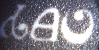

It's my work. Microscope image:
The problem is, it's hard to dye all sides. Not impossible, but costs much. I'm now seeking a good way.

Yes it's possible... but the downside is the QA for that process to do all the sides seamless isn't quite there yet. It's very easy for misprint to occur. If people wouldn't mind to pay 3x or more per cap for 'perfect prints' or accept that it may not be quite right and be OK to pay full price for defect print I might be able to work something out to try some for next time. Doing some more 'experimental' kind of stuff is something I have been pressing for but there seem to not be so enthusiastic about it.
Doing only the top wouldn't be much problem though as those 'hacker' Japan keys did come out fairly well.
