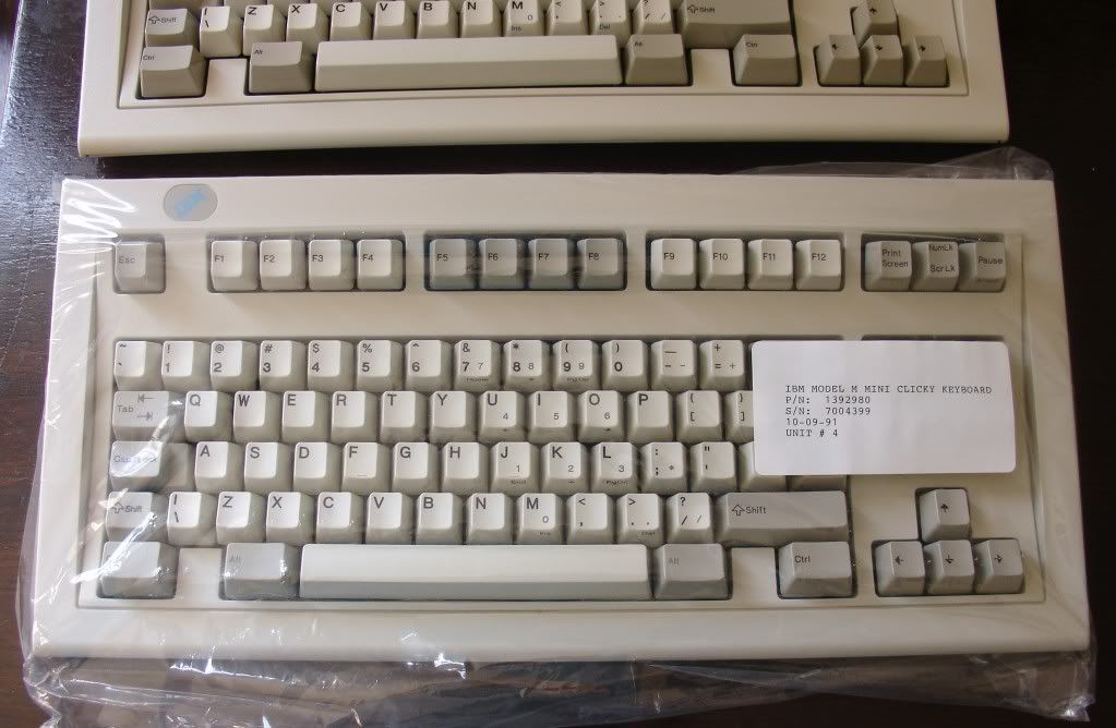

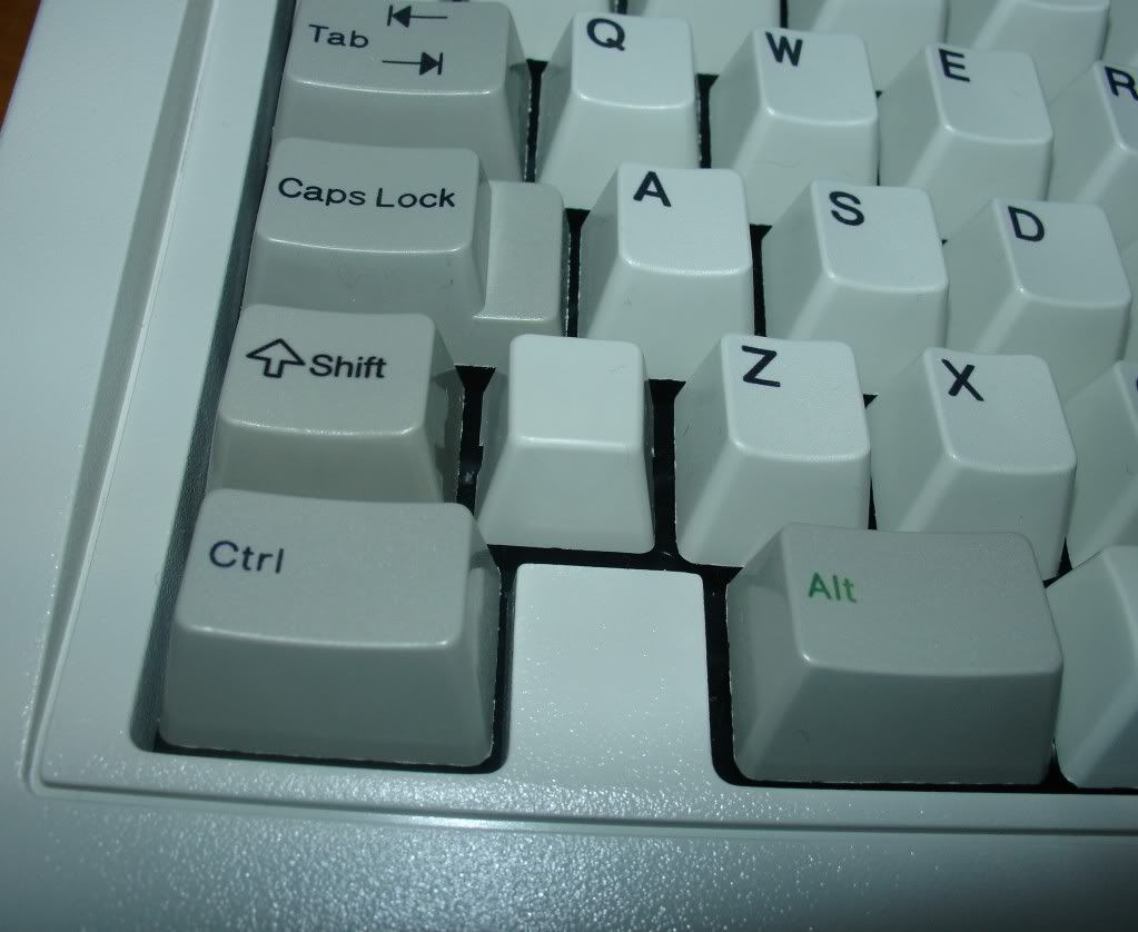

This is the model M mini from the lot of 3 sold on ebay recently.
I went for this one as it has the UK layout and looked to be in good condition.

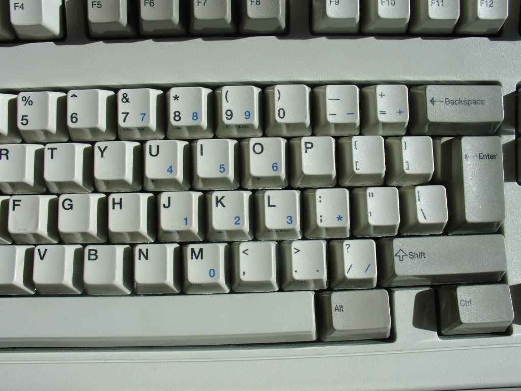

Well it is!
The keys have not been touched as far as I can see. They are so ruff they look like new. There is no sign of wear at all. Also the mechanism is so crisp and stiff it feels like a new keyboard.
It is displaying a few issues I will ask the seller about though.
I have had a few keys input more than once when they are only pressed the once. Not sure what could cause this but I'm sure one of you will.
Also a couple would not input at all but then would a lot.

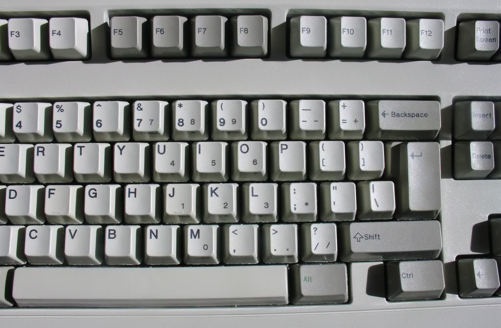

Here are some pictures with my other Mini for comparison.
The caps are single piece and dont have the blue of the 2 piece caps on my other one.

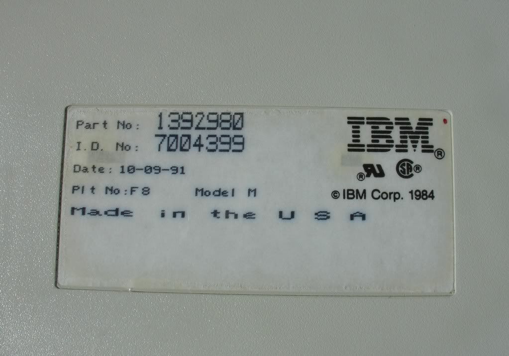

The label on the bottom is covered in plastic and does not look quite right. Has anyone seen a label like this before.

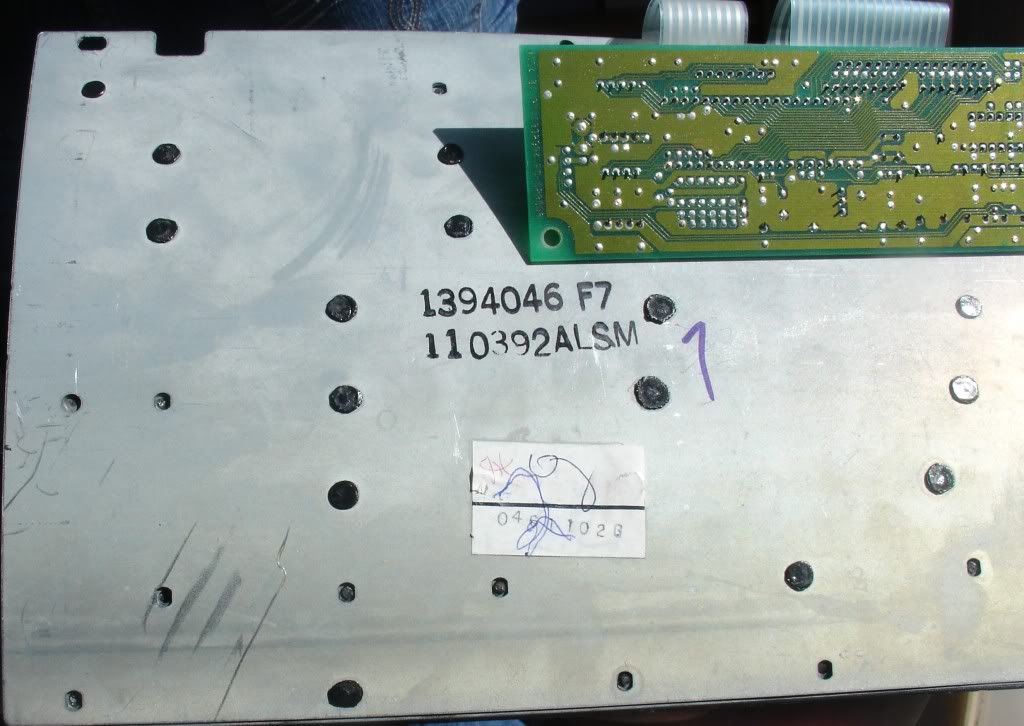

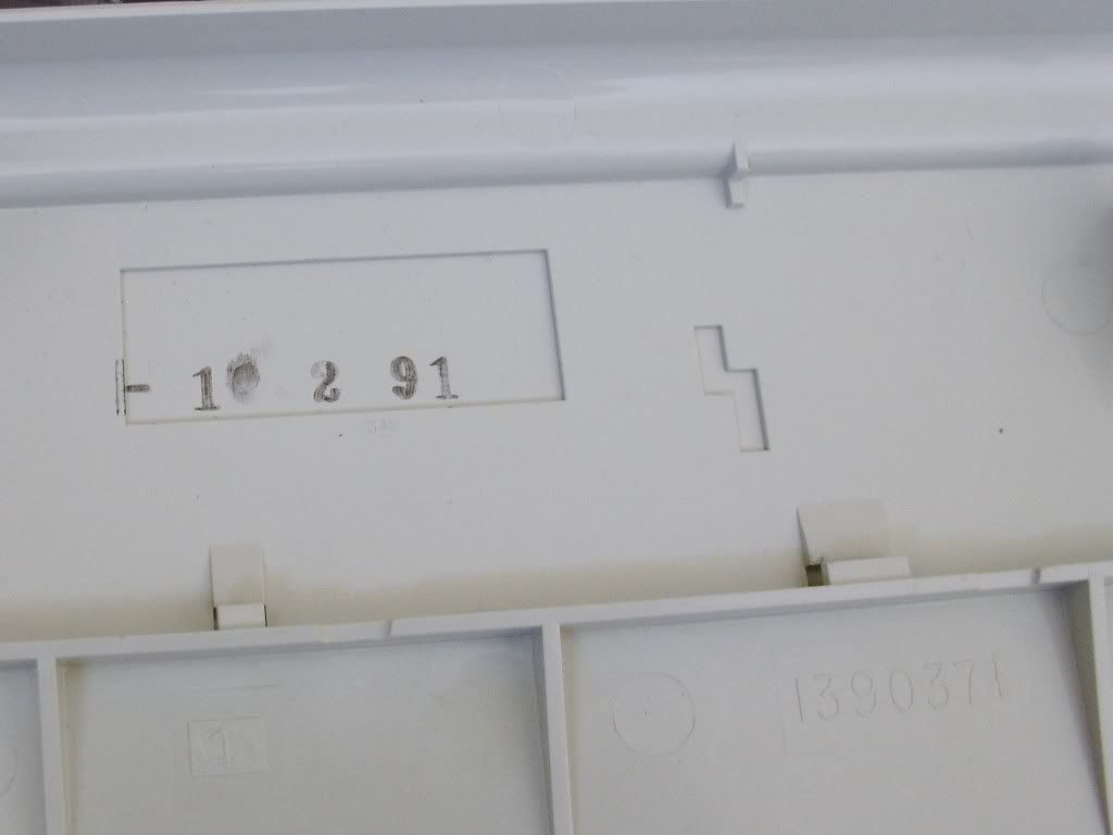

The serial inside is 1394046. I can find no reference to this serial.
On the bottom is 1392980. Which seems to be a terminal board number.

Older IBM-made keyboards have a full sized label that is protected by a plastic overlay. That looks legit. From what I've experienced the serials printed on the bottom of the baseplate are some sort of number for internal use only and don't come up on any searches.

Looks great!  I would guess those numbers aren't IBM, as Mercen_505 said.

Just like to add that this one does not have any drainage channels and my other one does.
I didnt think IBM made an ISO mini? This could be a very rare board if its a true IBM ISO space saver.

1392980 seems to be 84 key with RJ45 connector, so maybe the internals are from another keyboard. The serial on the metal plate is one digit different from Unicomp UNI04C6, 85 key 1394047.

Yup that's the one I found. It seems to be the only place the serial from the bottom is found. The Unicomp there is the other board I have. Wonder what the last digit difference could mean?

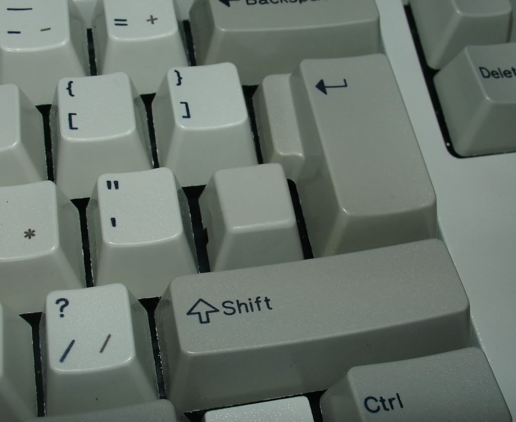

Just noticed that both of the |\ keys are 2 piece!
What does it all mean?

Does your Unicomp also have the same number on the metal plate? Here is another 1392980, with grey logo: http://www.flickr.com/photos/slashclee/2604487881/

Just had a look Chloe and it does. The plate in the Unicomp has exactly the same number.

I think it can only be the lower case from a 1392980 as the top part seems to have the grey logo on them. This one has the blue logo on the top panel.

I think the part # on the key assembly is the part # of just the key assembly. A german and a UK board might have the same key assembly but different keycaps result in different boards which would reflect on the number on the bottom.

Just noticed that f and j are two piece as well! strange board this one :)

Mine is like that too.
