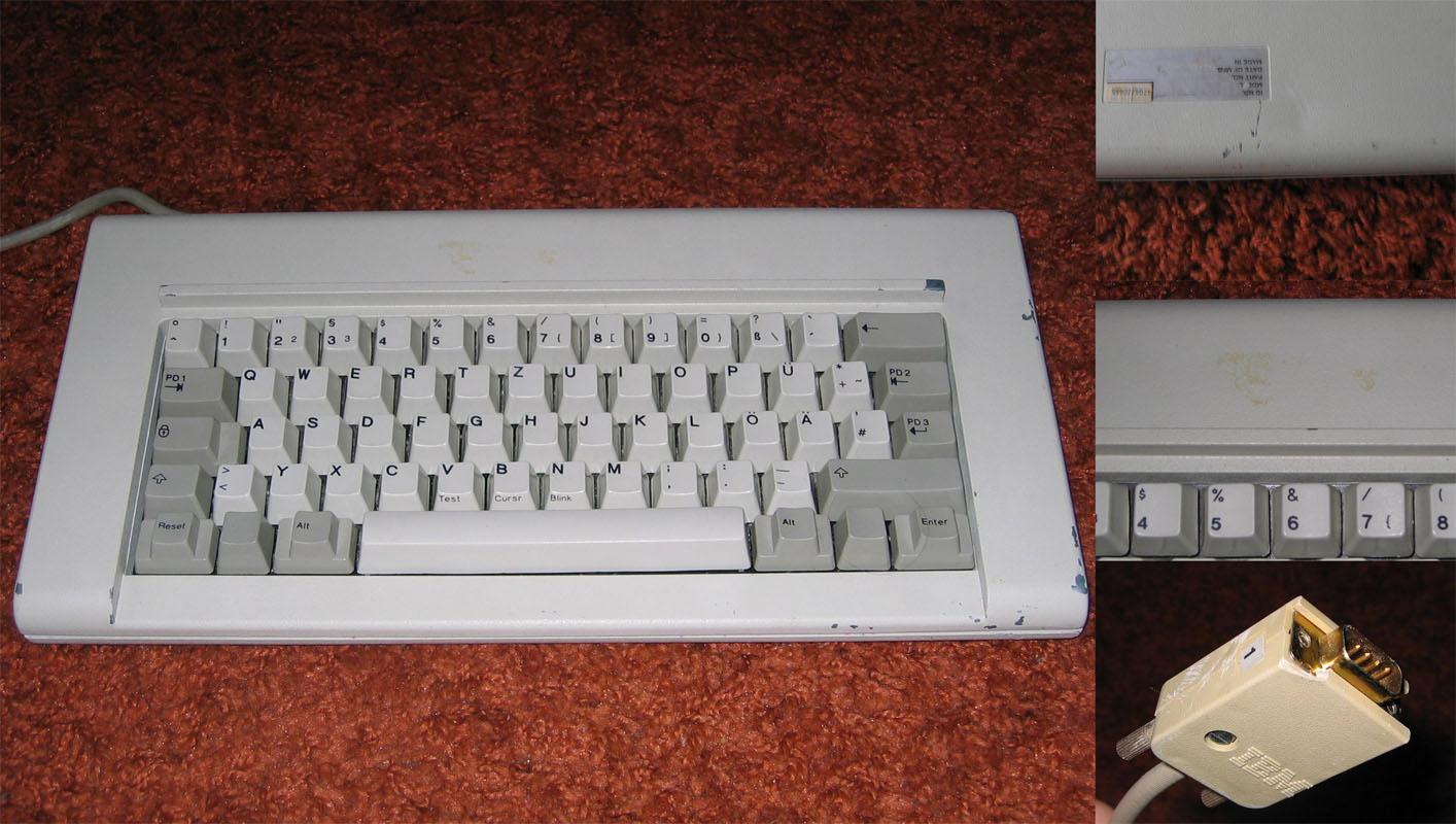

This will be my first attempt to refurbish a Keyboard and i want to document my approach (i hope this is the right board), not least to call for help anytime i will get stuck  :-[.
This is my starting point:
57700-0
I want to restore the Kish almost to original state. Differences will be a modified german QWERTZ layout and a paracord USB cable (replaceable with the original cable) but with original (USB-modded) connector (if i will be able to get one that is not splintered ... if you want to get rid of yours, PM me :) ).

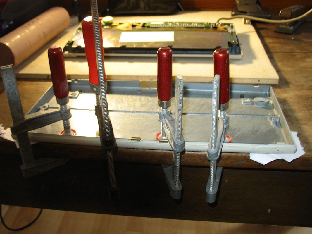

My Kish has a not so small dent in the backplate and the whole plate was pushed inwards. Deepest point was 3 mm from normal. So i did this over night without hoping for much success:
57702-1
But it worked very well! It is now nearly as it should be and the deepest point is around half a mm. That is very good news because i maybe do not have to do any filling (that would make powdercoating at least more complex).
