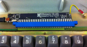

Beamspring-USB-Rev4
64349-0
This supports the standard Beamspring boards, such as the 5251, 3278, 3727 etc., which have a 23x4 matrix. It will not work on a Beamspring Displaywriter despite the identical 30-pin connector, as these have a 12x8 matrix—see below for that controller.
This can be paired with the solenoid driver board (see below) for Extra Loud Click, if your Beamspring is fitted with a solenoid (the 3727 is the only one I'm aware of that isn't).
USB connects via an on-board mini-USB socket.

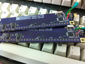

Model-F-USB-Rev1
64353-2
(photo shows Rev1 boards)
Rev2 PCB below (black lines show the actual board cutout):
This should work with all Model F keyboards (including the Kishsaver) which have separate controllers. Unfortunately this excludes the XT and a couple of other terminal boards, which have a controller-on-board which can't be removed (except maybe with a hacksaw).
Some Model F keyboards have less than 16 columns; columns can be set to `skip' using the GUI util.
These do unfortunately require soldering; IBM used a soldered-on ribbon cable for the Model F controllers, that first needs to be removed from the old controller, then attached to this one.
In the Rev2 board (unlike the Rev1 in the photo below, which has a flying lead), a USB micro (not mini!) is socket is used. This is to reduce board size a bit and these days USB micro sockets are much more common.
PCB at OSHPark: http://oshpark.com/shared_projects/eTR858GJ

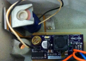

Beamspring-USB-Solenoid-Driver-Rev2
64355-3
(photo shows prototype, not Rev2)
This is drive the solenoid fitted to most beamspring keyboads. It runs off the USB voltage supply to the main controller, and uses a current-limited switch-mode power supply to boost up to 9V. This is then used to fire the solenoid when a key is pressed for Extra Loud Click coupled with Small Blinking Light.

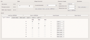

This is a Qt application which runs on Linux, Windows and Mac OS X. Its main purpose is to allow you to set which key location corresponds to which scancode:

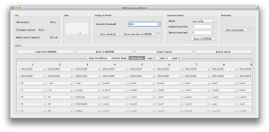

64359-5
...but also allows tweaking expansion port settings, like whether to run in LED mode for Caps/Num/Scroll Lock indicators, or whether to fire a solenoid (and adjust timings of it etc.).
This also is handy for diagnostic output to show which keys are being sensed as up or down.

Quick question for you xwhatsit.  Is there any special reason for the plastic sheet in my PC-AT?  I don't remember my XT having one, and I accidentally damaged mine in my garage.  The wind caught it and blew it on the floor and I didn't see it.  It got stepped on and there is a few dents and dings.  I am not really worried about the damage, but I was thinking about using something else that I don't have to be quite so gentle with.
Again, I just want to say thanks for answering my questions I have been bugging you about in PM's on DT.  In case you are wondering I got the controller mount figured out including completing the ground plane between the plate and the controller given the controller location.
http://i.imgur.com/7aqokLb.jpg

You know what I don't know... in fact I can't recall where the plastic sheet fits now. It's between the pad card and the bottom plate isn't it?
It's probably just there for insulation, although I would have thought the soldermask would have been enough for that. I don't think there are any vias which break through the soldermask.
I don't think you'll hurt anything by leaving it out, other than having to reassemble everything again if it doesn't :)

You are right, the plastic sheet goes between the pcb card and the back plate.  Instead of the plastic sheet I am going to spray the front of the back plate with rattle can plastidip.  It is basically a spray on thin rubber type coating.  If it doesn't work out, it just peels right off.  The back of the back plate and both sides of the top plate are getting this, along with the new foam, and my floss mod, it has a very unique sound, while still retaining probably 90% of the feel.
This is my floss mod video from my AT.
Also, I somewhere I scratch the solder mask on the bottom of the PCB, exposing some of the trace of the ground plane.  Should I put something on the scratch to prevent corrosion of the copper?  I would think a quick bit of clear fingernail polish would work great here.

So I got my Kish working with one exception regarding the buzzer.   It works as expected but when I set a key to "toggle exp" the buzzer fires and doesn't shut off.  Do I have the buzzer wired up wrong?
140250-0
I know it's a crappy pic and I can get a better pic posted tonight, black is gnd green is driver and red is vcc.

The boards have shipped from DirtyPCBs and should be here Friday.
Here's the DirtyPCBs rendering:
And where I plan on cutting traces on the XT controller

Short version: In the IBM Capsense USB Util version 0.9.0, where is the Base Layer  (or any layer) "Store in EEPROM" button?
Longer version: I downloaded the latest software, 0.9.0, from http://downloads.cornall.co/ibm-capsense-usb/, and also doc installation_model_f.pdf.  I followed the instructions in that doc, and am now typing successfully on the newly-xwhatsit-ified keyboard. (Well, except for super-stiff spacebar.)
However, that doc shows a UI somewhat different from the actual 0.9.0. Perhaps, the doc is for an earlier version. Not much of a problem, except that section 6.2.3 says to use the "Store in EEPROM" button to save the keyboard configuration to EEPROM, and the screenshot shows such a button just above the row of tabs.  In the actual program, there are no buttons above those tabs. just two panels: "State" and "Control" (with the latter containing only a huge "Emergency halt" button).
So how do we get the keyboard layout (assignment of matrix position to PC scan code) to store into the EEPROM?
Thanks. -- Graham

Any change in the layers should be stored automatically.
Offline gwideman
Re: xwhatsit's Grand Unified IBM Capsense USB controller thread
« Reply #40 on: Sun, 26 November 2017, 01:50:10 »
Thanks for your reply, but I'm unsure what you mean.
Are you saying that you think that the current software stores layer changes into the EEPROM automatically? Or are you advocating that the software do that, but currently it does not?
If the former, then what is/was the function of the "Store in EEPROM" button? Or perhaps you have some info that older versions needed that button, but later versions made storage automatic?
