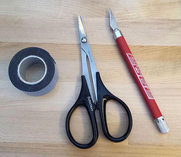

So this is a simple, cheap solution that uses double sided foam tape that does a perfect job. It will work on mice that have a gap under the primary buttons.   In the RC world, we call this tape "servo tape".  Here is my favorite brand since it sticks the best.
Here's what you'll need:
Double sided foam (not gel) tape
scissors
X-acto blade (hobby knife)

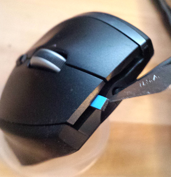

This foam is inserted under the button.  Some mice have a big gap (like this g502) and may need the foam tape to be doubled up.

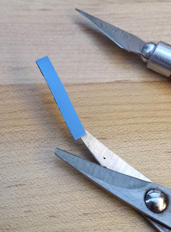

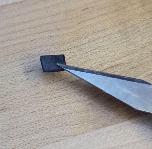

1. If the gap is large, double up the foam.  Cut 2 tiny strips (1/8" or so) and stick them together to double up the thickness.   (It's important to put these 2 sides together so the oils in your hand that get transferred to the tape wont be an issue for this step.)
2.  Leave one of the non-stick backing on, and stick the other to the blade.
3. Insert under the button. (If needed, lift up on the button to give you more clearance.)
If the button pressure isn't perfect, just use the blade and remove the tape, then repeat the above with a different sized piece of tape.
This foam tape doesn't deteriorate or change it's resistance.  One application will last for years.
