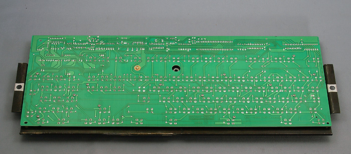

« Reply #14 on: Sat, 16 August 2014, 19:10:26 »
Here is an overview of the ANSI-layout NMB Hi-Tek that I got. There has been some discussion elsewhere so I thought that this might be the best place.
The keyboard came with white (linear) Space Invaders and I transplanted black (clicky) ones into it. I harvested them from an old board and several of them do not feel "right" so I plan to replace about a dozen.
They seem heavier and scratchier so I figure they probably have dust or grit inside. The switches are so insanely complicated that I don't want to mess with trying to take them apart for a good clean and lube.
My real problem now is that I am an old man and I seriously cannot read the legends in less than perfect lighting without taking an effort to focus. I am a near-touch-typist and all that, but I do not touch type all the ancillary keys. Also, I often work in very dim lighting.

Re: NMB Hi-Tek Space Invaders discussion topic
« Reply #16 on: Sun, 17 August 2014, 10:15:44 »
Thanks. In real life use, the legends are far worse to read than they look in the photos.
It took some work to clean it up, and I painted the plate my trademark green.
The keyboard itself is almost exactly the size, weight, and configuration of the Apple Extended Keyboard.
How could you search for this since it just looks like "RT101"? I have had dozens of keyboards of all types from many manufacturers with that number.

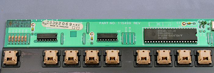

« Reply #17 on: Sun, 17 August 2014, 14:14:15 »
sadly this is the only other reference to that part number (910007) I could find:
http://geekhack.org/index.php?topic=8643.0
Based on the description, it appears to be the same KB.
memory4less may or may not have one http://www.memory4less.com/m4l_itemdetail.aspx?itemid=1456954556
They're pretty bad at pictures.
The "NMB number" doesn't want to return anything useful.
Searching for '0600002 keyboard,' it seems Code micro might have one as well: http://www.codemicro.com/store/product/ncd-0600002-refurbished so might these guys in NJ.
Sadly, refurbished parts vendors are the only results often. Some people think it was made by NCD (whoever they are)
« Last Edit: Sun, 17 August 2014, 14:19:30 by dorkvader »
« Reply #19 on: Sun, 17 August 2014, 15:51:04 »
I will be opening it up do do some more work sometime soon.
This may help a bit.
Sadly I don't think so:
from here
The NMB 115499 part number on the PCB was also used for the normal fatass enter key RT101 we all know and love.
Looking at the back, it seems they used the same PCB for both. There's an unused switch location where the \| key is on yours.
Typical NMB, they have thought ahead
« Last Edit: Sun, 17 August 2014, 16:02:05 by dorkvader »
« Reply #21 on: Sun, 17 August 2014, 16:33:42 »
What! Wow! Really?
Now I have to look at my other board - if I could mod a bigass Enter / small Backspace to get an ANSI board, I would be delighted!
- Oliver Willis 2026-08-01
« Reply #22 on: Sun, 17 August 2014, 18:47:22 »
What! Wow! Really?
You'll have to mod the plate to add a hole for the \| key (the enter key switch location appears to be in the same spot regardless) but check out this picture:
It's not a big pic, but there's a clear space above enter. It also looks like you can play games with the backspace.

cleaned it up, so here you go
it has no label, but looks like a Phillips 2812
linear white space invaders (hi-tek)
the caps lock was cemented down, stuck so i took apart, cleaned and voila!
they are very smooth...........more so than reds
Luga G80-1865/MX Reds + Dolch G80-1813/MX Blues + G80-3700HQAUS + DK9008G2 Pro/MX Browns Thick PBT + DK9008G2 Pro/MX Clears Thick PBT +  QFR TKL/Ghetto Greens + Cherry G80-1800/MX Blues + IBM Model M SSK Bolt Modded + IBM Model M + IBM Model F + IBM AT F + Cherry G80-1000 (HAD)/MX Vintage Blacks + Razer BWU/MX Blues + Leading Edge DC2214/Blue Alps + Compaq MX11800/Browns + Chicony 5181/Monterey Blues + Chicony 5161/MX Black Cherry Clone + Focus 2001/White Alps + Chicony 5191/White Futabas + Olivetti ANK27-101 + Dell (Old Logo) AT101/Black Alps + NMB RT8255C+/Black Space Invaders + Unitek K260/Green Alps + Apple M0116/Orange Alps + AEK II M3501/Cream Alps + AEK M0115/Orange Alps + NEC  APC412/Blue Sliders + NEC APC410/Blue Sliders + Omnikey /White Alps + Wang/Yellow Alps (Omrons) + Laser/White SMK + Fame/Blue Aruz + AEK II M3501/Salmon Alps + Zenith ZKB-2R/Green Alps + Wang 724/Orange Alps + DK1087/Green Alps + Zenith ZKB-2/Yellow Alps + Dell Old Logo AT101/Salmon-Pink Alps + Leading Edge AK1012/White SMK's + Magitronic SK-1030/White (Linear) Futaba's + Packard Bell/White (Clicky) Futaba's + Datacomp DFK101/White  Alps + SGI AT101/Dampened White Alps + NMB AQ6RT-72511/Grey Space Invaders (Hi-Tek) + Datacomp/Blue Alps + Phillips 2812/White Space Invaders (Linear) + Dah Yang K251/Vintage MX Blues + Chicony 5161/DS Caps/Vintage MX Blue + Archie-NMB AQ659ZRT-725/Black Space Invader (Tactile) + IBM Model M 71G4644 (RD) Bolt Modded with Soarers Converter + IBM Model M Silver Label 1390131 + Cherry G80-1501/Vintage MX Clears + Focus FK8000/Linear Futabas + Gateway 2000 Anykey Programmable/Maxi-Switch + Dell GY13PVAT101/Dye Sub Caps/Salmon Alps + Chicony 5161/White Alps + AST K0B101/Slider over RD + Qtronix QX-32H + Everex/NMB RT8255CW+ Black Space Invaders-Split Erase + Tandon/NMB AQ659ZRT-101A/Beige Space Invaders + Cherry G80-11903 MNRUS/MX Blacks + Apple IIGS A9M0330/SMK Whites + WYSE PCE/MX Blacks + Chicony 5160AXT/Clicky Futaba + Cherry G80-0528/Vintage MX Blacks + Dell AT101/Linear (Modded) Black Alps+Topre 55g

dorkvader............don't you have one with the beige switches?
I just have this one: https://www.flickr.com/photos/dork_vader/sets/72157642928081893/
Switches are like this:
dude............that thing is clean!
Yeah it's awesome. Extremely linear, sweet layout, lots of keys. It appears to be unused and everything has been lightly oiled. I forget if I got it from fohat.digs or eBay. I would dearly love to get it working on USB.
I also really want to try a tactile one for a length of time to see how it's like.
