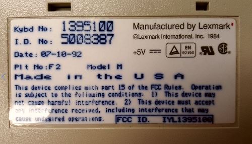

I've scoured the web, and the only real answer seems to indicate that this keyboard:
is some sort of 84-key variant of a Model M. The pictures from the seller seem to indicate a 102 (101?) key variant instead.
Is the the real thing, or is it just fantasy?
Re: Model M identification
« Reply #1 on: Thu, 17 July 2014, 08:51:53 »
Ask the seller for more pictures then.  If the picture and the label don't match, no one can say whether the label or the picture is correct.
« Reply #2 on: Thu, 17 July 2014, 13:09:09 »
Agreed. 1395100 is the part number for an 84 key model M, but your seller could have gotten some pictures confused or something.

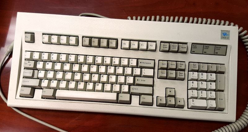

« Reply #4 on: Mon, 27 June 2016, 05:42:47 »
I know this thread's from 2014; I just thought I'd add this info in case anyone searches GH for this part number.
IBM (in 1991) and Lexmark (in 1992) used this p/n for SSKs. Also in 1992, Lexmark oddly used the same p/n for the standard 101-key Model M's they made for court reporting systems made by an OEM called Reply:
140818-0
One of these recently sold on eBay, hence the photos. Interestingly, the OEM logo appears in a square in the upper right corner—the same size, shape and location where the silver IBM logo appears on 1st-generation IBM Model Ms... Were any other later M's like this?
This also begs the question: How on earth could court reporters use buckling spring keyboards without distracting the heck out of everyone present? (I'm guessing the OEM wasn't around long, for that reason...?)
« Reply #5 on: Mon, 27 June 2016, 08:11:27 »
My guess is that the actual court reporters probably used chording keyboards and that this was for transcribing tapes in the office after the fact.
« Reply #8 on: Tue, 28 June 2016, 09:48:27 »
yeah, court reporters may take shorthand in court then do the full write up - or if court scribes, as above.
« Reply #10 on: Sat, 02 July 2016, 08:59:08 »
sticker in first photo looks fake, like there was a sticker there that's been removed, and now has a smaller sticker
SENT FROM MY TRKA-100-ULTRA-PRO-1R WITH FLASHY MULTI-COLOURED LEDS FOR MEGA ULTRA COOLNESS
(please like me)
« Reply #11 on: Sat, 02 July 2016, 09:54:36 »
For all of IBM's attention to detail and quality control, I have seen lots of ugly and poorly-placed stickers on Model Ms.
