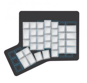

Offline steve.v
  • Posts: 171
fixing the ergodox thumb section
« Reply #112 on: Sat, 01 November 2014, 23:39:03 »
Have you considered making the pinky column a few cm(s) lower to compensate for its shorter length? I understand that each hand/fingers sizes are different among people; however I believe our pinkies are shorter than the other fingers and may benefit with a slightly lowered pinky column keys.

Offline jacobolus
  • Posts: 3670
  • Location: San Francisco, CA
Re: fixing the ergodox thumb section
« Reply #113 on: Sun, 02 November 2014, 00:34:23 »
Have you considered making the pinky column a few cm(s) lower [...] For me the two biggest changes that I would make to my ergodox is, have a closer thumb cluster of buttons, which you've implemented; and second, have a lowered pinky column cluster than the ring fingers.
This prototype had a very aggressively shifted pinky column, which I quite liked, but got feedback from 3 other people who tried it that the pinky column was shifted too much:

Offline steve.v
  • Posts: 171
« Reply #114 on: Sun, 02 November 2014, 00:45:57 »
Looking at your mockups I noticed the columns next to the index fingers are of same stagger positions, such as the T G B keys on the left hand; do you think a very small adjustment to have it lowered might be beneficial? I think that due to the natural lateral movements of the index fingers to reach other keys outside of its column it should be slightly lowered.

Offline jacobolus
  • Posts: 3670
« Reply #115 on: Sun, 02 November 2014, 01:17:44 »
Personally I find reaching diagonally sideways-and-upward to be a much easier motion than diagonally sideways-and-downward. Note that with the more aggressive stagger for the middle finger and pinky columns (compared to the ergodox), the hand will naturally fit at a straighter angle relative to the columns, making the direction of index finger motion a bit different than it would be on the ergodox.
It would probably be possible to guarantee every key was ideally reachable with a layout that drops some keys, like this, but then it would be basically impossible to put a QWERTY (or Dvorak, Colemak, etc.) layout on it:

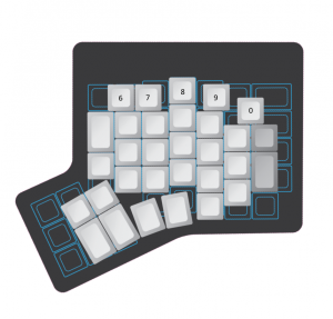

Offline Zustiur
  • Posts: 235
« Reply #121 on: Tue, 25 November 2014, 00:14:28 »
I have to say that of jacobolus's sketches in the OP, the last of these is the most immediately appealing to me.
I'm still trying to digest the rest of the thread images because change in the bottom row for arrow keys doesn't sit well with me (my arrows are on layer 2, not on the bottom row)
I also have to echo the suggestion to increase the tilt of the thumb cluster relative to the matrix. On my Ergodox, I can only just reach inwards enough (with out leaving home row obviously) to brush the bottom-inward most 1x1 key. The other 1x1s in the thumb cluster are useless to me when touch typing, but I can reach further back towards my stomach quite comfortably.
I would also be in favour of the additional top row for F# keys, but that's a lesser concern, and something I should really fix with my layers.
Perhaps, for my hand and body size, the solution should be to remove the inner most column of the thumb clusters (the 1x1s) and add in the F# row.
I'm also in favour of a slight increase of the stagger, middle finger up a bit, pinky down a bit. Probably only by .025 in each case.
And a request I have not seen mentioned, I'd like the outer most bottom keys (ctrl on a standard keyboard) to be widened as I still insist on pressing these with my palm/knuckle rather than any fingers.

What do you think of this layout. This adds a space for a directional keypad, with the loss of only one non alphanumeric key. If you type in QWERTY, this would be the right hand "/ ?", if you type in Dvorak it would the left hand "; :". If you didn't want to add directional, it would still work without it. I wasn't a big fan of the staggered number keys, so I straightened those out. The thumb section is perfect with your new layout. The two 1.5U left most thumb bars, could be 2U (The 2U felt slightly more comfortable against my thumb), with the two 1.5U bars to the left of the home row moved up to make room for the 1U on top of the thumb bars. The pinky 1.5U bars are replaced with 1U, but they would probably be just as good with 1.5, as  before. If it is possible, the teensy/ microcontroller could be moved from the top, to a vertical position in the top left corner. Then, the PCB could be made smaller, and a potential to plug the USB cable directly into the teensy. Comments?
I like this very much. Considering building this from scratch.
Let’s directly compare and note changes you made:
- Made the top left index finger key further to reach. I’m -1 on that
- Reduced the column stagger on the pinky column. I’m -1 on that
- Shifted the far pinky column up quite a bit. Now the top two pinky keys in that column are very hard to reach IMO. I’m -1 on that.
- Added dedicated arrows. Personally I don’t have need for dedicated arrows, so I’m +0 on that.
- Switched the corner pinky key from 1.5u to 1u. I’m -0 on that. I think the previous one is pretty good for a shift or other modifier key.
- Put the number row into alignment with the columns. Personally I think this is worse functionally, but possibly better aesthetically (though there are so many gaps and funny shapes on this keyboard that I don’t think it’s a big deal. I’m -0.5 on that change.
I’m guessing I personally would prefer my version, but I haven’t physically tried yours, so it’s hard to be sure.
I personally think the best way to best meet the needs/preferences of different folks is to have one very compact version without dedicated arrows, and one larger version with an extra pinky column, an extra thumb column, a number row that doesn’t have gaps in it, dedicated arrows, and possibly F keys. On that one, it should be possible to basically copy most of the layout over from an existing TKL board.
Anyway though, don’t take my criticism personally: I’m just telling you my own personal preferences, and a lot of this is pretty subjective. Thanks very much for proposing something, and I hope you and other folks keep tweaking and offering alternative suggestions.

Thank you for your through comparison, between these layouts. I printed out a paper version of your layout and tried it out. I used DSA keycaps, as that is all I have. I'm not sure what percentage of Ergodox users use DSA, but due to the fact they were easier to obtain, cheaper in cost, and ability to freely customize their locations, that is what I have. Note,  I have medium/small hands. This is what I found,
I agree with you here, I think reach in your original version, outweighs having bulkier keys.
I also agree here, the pinky column stagger was ok, and put noticeably less strain on my pinky overall throughout hand movements.
Arrow keys definitely arn't for everyone. From your previous designs, it looks like you tried to incorporate a directional pad similiar to the one on the Truly Ergonomic Keyboard. I think that style of directional pad is too close to where the wrist sits, and could be uncomfortable for some users. My version was there to be optional (as it used one of the primary pink keys), but integrated enough, so it would be out of the way of the wrist.
I agree, bring back the 1.5U, in fact bring back a whole row of 1.5U. Going back to the original ergodox design, one part I really like is the chunky 1.5U rightmost keys (especially on my left hand, for ctrl, shift, and escape). Although, they are not as easy to reach due to them being in pinky range, they are large enough to side palm, and I like to move my entire hand and take my index or middle finger and hold them down for some shortcuts. This is a personal preference, and though these keys could be mapped to the thumb area. I really enjoy them. I would like to see how otherwise view this row of keys.
Here is a picture of the columns in the staggered layout, as you have them now.
83894-0
Testing each key for comfort, 7, 8 and 9 all felt quite comfortable. Looking at the natural curve of my hand, I instantly could tell why. As my fingers extend they naturally spread apart, and land almost perfectly with the the locations of the 7, 8 and 9 staggered keys. However, when it came to the 6 and 0, each was somewhat painful (The 6 more than the 0). The 7 key is in a perfect spot for the extension of the index finger, but the 6 key is a stretch. In a non-staggered layout, my fingers were more cramped in the middle keys, but do not have to stretch as far for the outer numbers. Personally, I like the numbers, non staggered, as close to home row as possible. I urge everyone in this forum to try it for themselves, and report their hand size as well to see how they like it.
I am sure that staggered layout is good for some people, so I made a few changes to your original layout to come up with this,
83896-1
Since I prefer the non staggered layout, I just alligned the number keys and came up with this (adding right side 1.5U keys, with a 1U for delete,
83898-2
To fill it out, I added an additional top left 1U key and extended the 1U top right to a 1.5U. These buttons are not easily pressed, but makes it look nice, and allow sparingly used keys, that are annoying when you can't find them, like ~.
Thank you, and let me know what you think.
