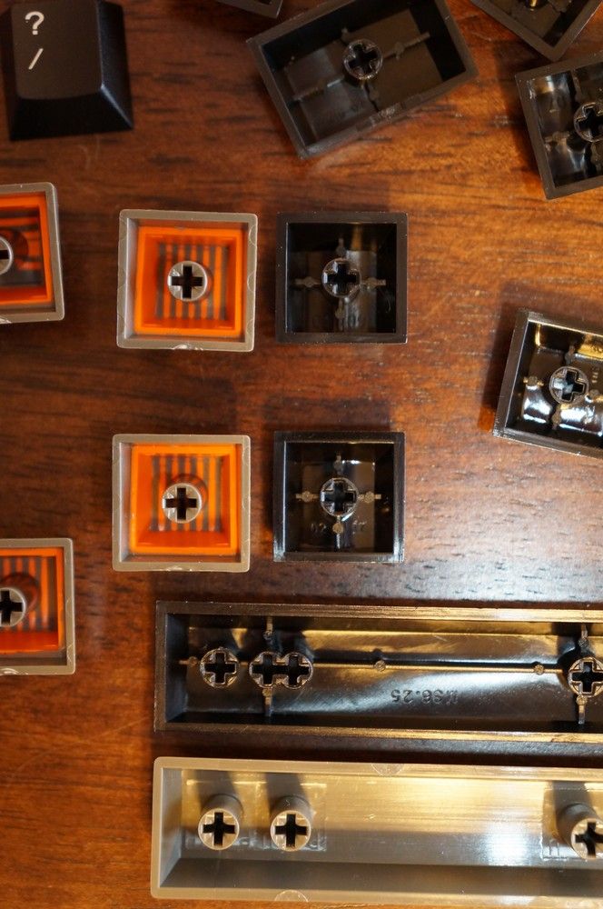

i knew that i'm never happy with stock keycaps anyway, so why not go for the bells and whistles?
but the stock caps are actually not that bad, here is a photo of the back of them next to some of the hacked by geeks caps:

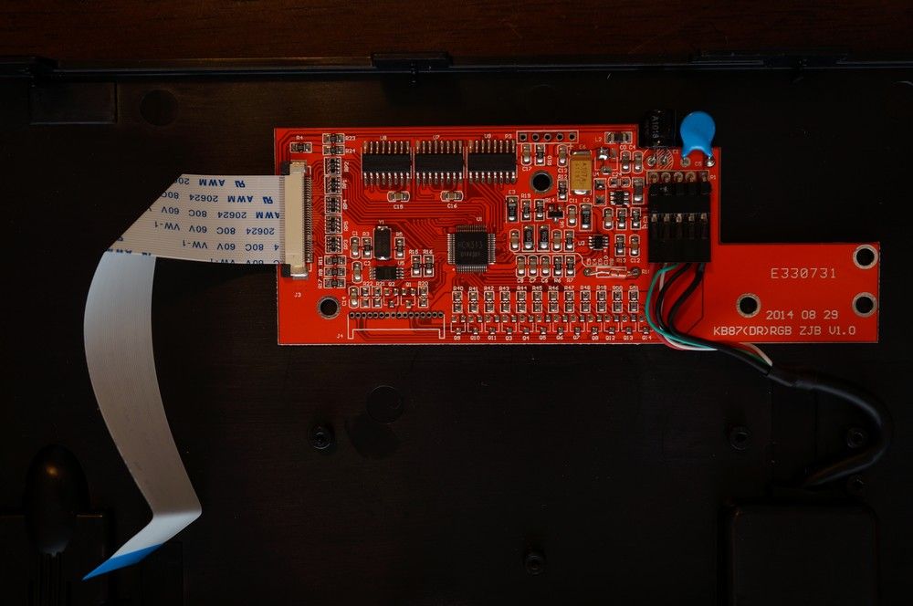

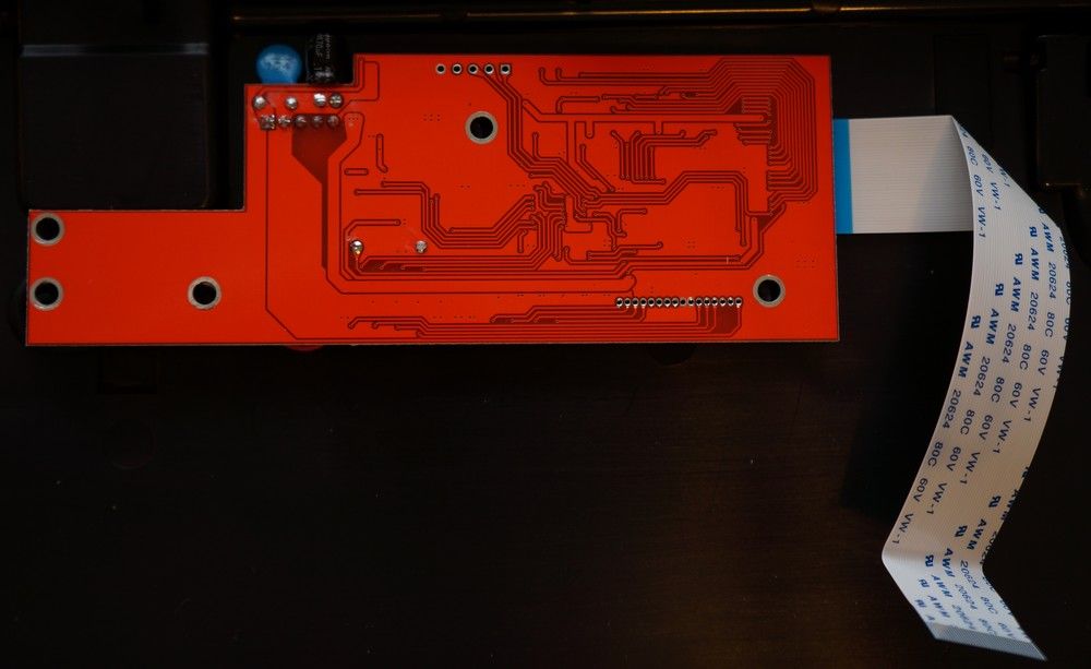

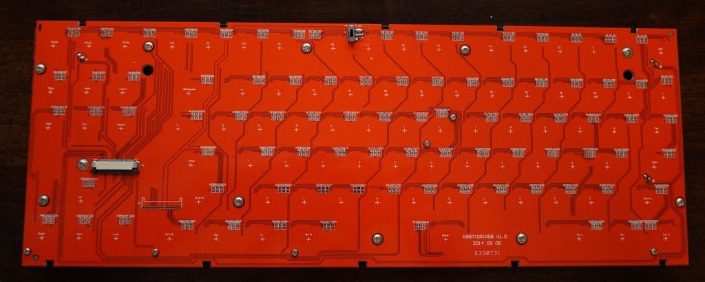

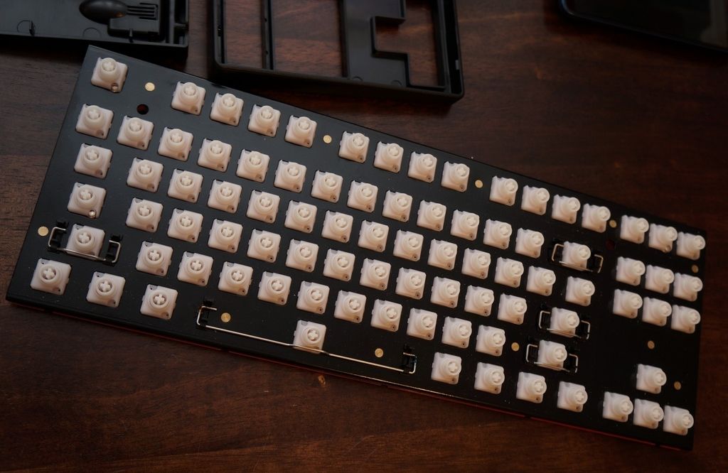

And I actually got curious and took apart my RK without the backlighting to see how different it is.  It looks like it would be way more work to add backlighting after the fact than the cost differential if you are thinking about adding it later.  There are 3 SMD resistors per LED that are not populated, the RGB LEDs, based on the pads I saw are probably little 4 pad SMD LEDs, something like this.  The controller parts for controlling the LEDs are also depopped (12 transistors and resistors RGB x 4 backlight zones), and the connector for the additional cable is not there either.  I took some photos for the hell of it since I don't feel I will be opening it again (the 3 indicator LEDs are through hole and go through the rubber membrane, so it cant be removed from the PCB unless you desolder them first, which I didn't feel like doing)..
