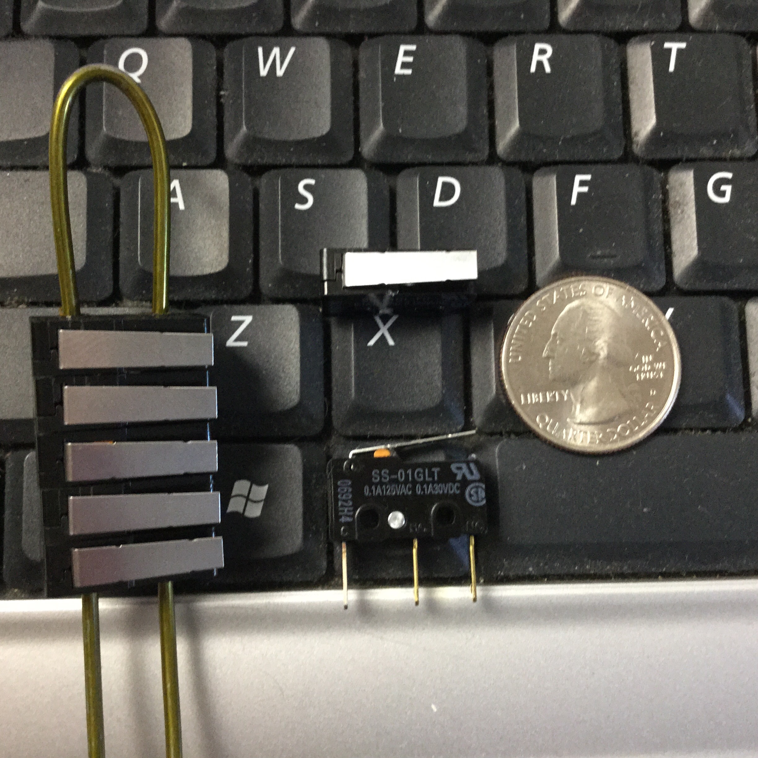

96785-0
This is one of most important parts.  Our fingers receive a tremendous amount of work (abuse?) from hammering these tiny nails into the keyboard over vast distances, probably the equivalent of thousands of miles of running over a decade.   I'll be using super low force subminiature microswitches, that have 1/8th the force at 8g of typical 65g+ force keystroke activation, and have it modelled after my hand and range of finger travel.
 I have done significant research on keys before selecting micro-switches (inspired by Tim Tyler's experiments http://mykeyboard.co.uk/microswitch/ though we differ in approaches).
 About a decade ago having my first flareup of tendonitis that didn't go away after a weekend, I tried every keyboard at every computer stores in the area, before I decided on the BTC which was accessible at Fry's electronics.   Prior to that, I used an exotic Fingerworks Touchstream for years, which although is 'zero force' but like hitting the flat screen of an ipad, it really isn't ergonomic, particularly on the back of the hand having to keep the hand above the surface from touching it accidentally, as well they are finicky, break and now can't be repaired.  I have played with light keyboards (laser, lightio), virtual keyboards on ipad/android tablets, my fingers hurt using them for any prolonged use as well as the lack of feedback are deal killers.  4th generation haptics will eventually improve this, but there needs to be a full feedback loop of finger hitting the switch but not activating it, intital resistance pressing to start activation, a breakaway as it's activated with a progressive break to avoid hard bottoming out, and ideally a restorative force (like a trampoline or piano hammer weighted key) This isn't really possible without a physical mechanism.

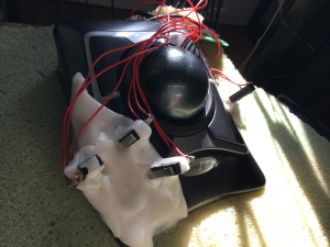

Next I rotated through them hacking into a Kensiginton 4 button trackball,
96777-1
primary goal replacement of my left and right mouse button, to figure out what worked the best, as the built trackball clicking is very heavy like 90g+ force, and that is one of the biggest pain points I have, the right thumb, click, double click, click to hold and drag, select constantly throughout the day, which sometimes wakes me up at night from the pain. This 1 minute tour * capturedvideo.MOV (6035.1 kB - downloaded 257 times.) shows the layout, all four buttons ended up being used, 3 on thumb (click, double click, middle click), one on pinky ( right).
That revealled I liked the 8g-16g Omron most, and found 20g too hard for ideal, and the 8g so far are working the best for me in the trackball in a side clicking manner, even though it's most prone to accidental clicks placing the hand in it.  The optic proximity sensor worked but had the issue with you can't rest your finger near it, creating a different form of work being done, and there is no feedback loop as to where/when you are/click.

this is a shot of the zero gravity chair workstation that accompanies this project, the trackball on the right ...lol pic upside down for reasons i don't know
i've tried at least 4 different wrist forearm alignment molds,  to keep wrist angle neutral, made from plastic to foam, my conclusion is that you really need a adjustable one that changes throughout the day, so thinking of a ball joint, or heavy velcro/ magnet
as well i've tweaked the buttons on the trackball a couple times, by using a heat gun to move a millimeter and few degrees, that helps tweak far easier than if it was on a pcb board, which supports my theory that scultping thermoplastic is a better choice than 3d printing for first passes, when going so unconventional like this.
so far after a few weeks of use, the new microswitches and positioning, my mousing hand has substantially less stress on the thumb, its not waking me up at night from pain yay!

96791-0
so looks like using coat hangers and stringing on the switches like beads will be a viable approach. This is nice as the coat hanger wire is reasonable stiff, cheap, accessible, easy to bend to make the curve, easy to reposition the keys on it, add or remove them quickly nondestructively.
Conventional keyboards have 5 primary rows, 6 with function keys, 7 if you have multimedia buttons.
this could easily do 9 (2 more rows which would already be substantial more keys to press) to 12, depending on what goal is being aimed for density vs less likely to hit accidentally.

113373-0 It's been awhile, so busy haven't had time. But getting back into it on weekends.
 This time working with clay to build arm trays, when temp is in 70F's standard art store plastilina clay is on par with rubber with hardness, when 100F you can easily press into it, for body impressions even molds.
This existing keyboard and trackball is the 'control' I'll be using to contrast the Conchi and related experimental work. My first pass will be trying to replicate the size of that keyboard layour but split to keep the learning curve as low as possible.
I spent the last week using this clay foundation for fulltime work, ( covered with paper towels as clay is greasy) in middle of a work release and very clear benefits markedly less stress on trapezoids, and wrist flex tenons, and tendons on back hand, the ability to lift up the keyboard to keep the wrist neutral is awesome, and the elbow bumper and forearm wells act as a gentle reminder, when one is out optimal alignment, it doesn't feel right.   That said there are things I'll change, but has given me enough confidence to try a thermoplastic casting of it as clay does eventually bend (which is one reason it looks ugly, had to repair a few times).  Not shown in similar work with chair.
The massiveness and form fitting of the clay allows the body to relax, some internal cue of the brain is hyper-aware of "falling" so lighter weight supports (e.g. tv tray, art drawing board) so at least my brain tends to tense and hold muscles, leading to knots and tendonitus.  I first noticed this on my sit stand workstation when I switched out the surface from steel wire to a massive butcher block countertop from IKEA.  Massive surfaces, dull the vibrations during typing almost completely.
The malleability is also helpful, particularly on left side i found dents handy for my elbow when supporting my chin ( prone to have this position when thinking) and right side for the double duty of keyboard and trackball, and similar elbow dent

trying to figure out if microswitches should go verticle or horizontal, they are slightly bigger than the keys I've been usijng in the long axis113385-0

i've been hacking the microswitches, the addition of a cut silicone tube as a ligament between the steel lever and orange plastic microswitch, GREATLY improves feel and responsivity, by eliminating play in every direction,  making it super responsive and feel stable, normally the metal lever is pretty loose, so jiggles, making fingers, and can even get caught on edges and lift up.120208-0
Offline intrio
  • Posts: 57
  • Location: Los Angeles, CA
    • Intrio - helping bridge the gap between the humans and the machines
Re: Conchi build log: 8g microswitch ergo keyboard and trackball
« Reply #25 on: Tue, 15 December 2015, 18:18:27 »
 here exploring again the microswitch orientation, and using the same silicone tubing as the key cap, both which i really like.
the verticle orientation makes the key column very thin, and potentially fan like expandible, useful for puttin in a travel bag
Normal membrane switches keyboards have a rubbery dome or layer, whose give, help absorb impact ( unlike an hard iPad screen).   so using the silicone in any fashion helps make a more comfortable keypress.
the connecting surface to the finger also matters, both as a cushion and tactile feedback so muslce memory can auto hone in.   so here by various cutting of the small silicone tube, making a few points to match a subtle arc of finger tip pad, thinking the spiky version good for home row, the end bubble for normal keys.  it has the other benefits that it extends the length making the pressable area bigger, and space between keys smaller, and more grippy, its almost impossible now to not hit a key.
« Last Edit: Tue, 15 December 2015, 18:47:26 by intrio »

packing foam is easier to cut than cardboard, taped to connect, still using wire for holding the curves and here's though it's still fiddly getting all the parts to work together with the hand constantly, moving a bit here and there
« Last Edit: Wed, 30 December 2015, 23:13:32 by intrio »
« Reply #48 on: Thu, 31 December 2015, 00:33:05 »
foam and wire worked well as scaffolding for the thermo plastic, and doesn't care about getting wet, which is useful to set parts in place.   I first created the palm rest, and beginnins of finger wells, then did one finger at a tome match the previous foam pattern, solidified it under cold water except for the end, which was still gooey then rested whole thing overhanging a table edge, and adjusted position till it felt right.  my goal is to have fingers move minimally (avoiding wrist bending and raising forearm, necessary for longer finger travel) as keys will be raised, each top surface of the support should barely be touchable.
there will be additional rows for the first, thumb and right finger, but gotta start somewhere.
 i'm gonna have to play with it a bit using a heat gun and flat blade sculpting tool (aka screwdriver) before adding the switches
next challenge is to figure best way to attach the switches this way, the thermoplastic can be tapped and I could use screws, or using the super hot thermoplastic a small dab on the switch and
« Reply #49 on: Fri, 01 January 2016, 14:12:25 »
right hand middle, ring and pinkie mostly done and in right position, its really interesting the fingers create almost helical patterns, like a 45 degree diagonal.
i'll probably redo the plastic again, having learned a few tricks getting keys on in right place, and a few alignment issues not easy to fix with keys on, the hot air gun creates a nice soft patch to glue these in, which a screwdriver can help create flanges to keep it in place
