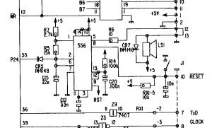

One of the keyboards I loved in the past was the ABC77 from the Luxor ABC806 and ABC802 computers. A certain feature was the key click effect built into the keyboard. It's that sound I'd like to have in my keyboard, as an option to enable. Preferrably on all keys but the modifiers.
It sounded like this: https://youtu.be/JgZ5yfSE584?t=30s
The original sound circuit was based on the 555 timer (or rather half a 556) and looked like this:
96694-0
To begin with, I'm setting this up on a breadboard to see if I can get the sound right.
Then this will, depending on results, be replicated as closely as possibly with pwm in the teensy or with the 555 circuit connected and activated by a teensy data pin.

I'm not an expert at 555 timers, I usually just adapt other people's circuits.
For this, I'd probably adapt the circuit from Le Dominoux:
It's essentially what you need - a trigger pulse driving a fixed duration output pulse.
Though honestly, I wouldn't even bother with the 555 and go straight to coding the ATmega to do what I want.

Yeah, what I meant was, use one hardware timer on the ATmega to drive one output pin at the desired audio frequency. Set the duty cycle to the desired pulse width (i.e. 50% will get you the square wave typical of "beep" sounds).
I already use a hardware timer/PWM output for brightness control: https://github.com/Wilba6582/tmk_keyboard/blob/master/keyboard/planck/backlight.c
That code can be adapted to become the audio output. You would need to free up PB7 if you are already using it, or adapt the code to use a different pin connected to that timer, or a different timer/pin combination. In your case, I think resoldering one wire is probably easier than getting your head around the ATmega timer register  ;D
I think I'll just hunt in my parts bin for a piezo and try to get beeping going on my Planck and then link you to the TMK code.
