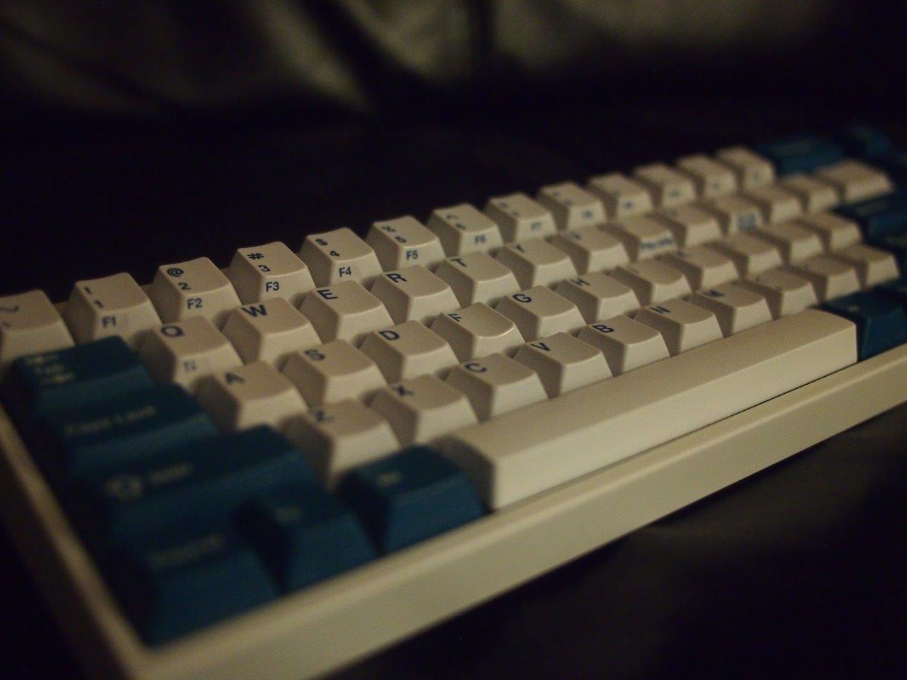

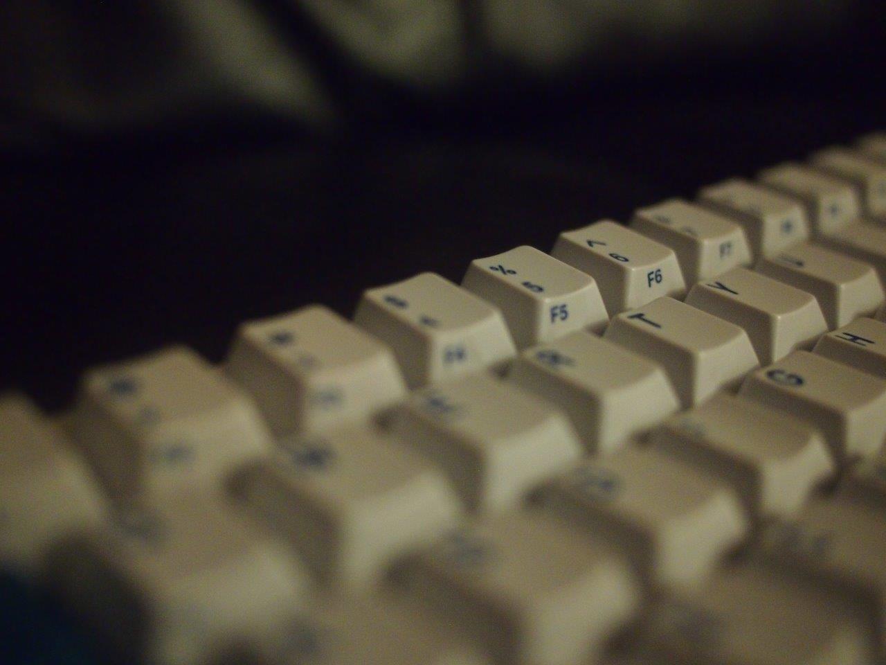

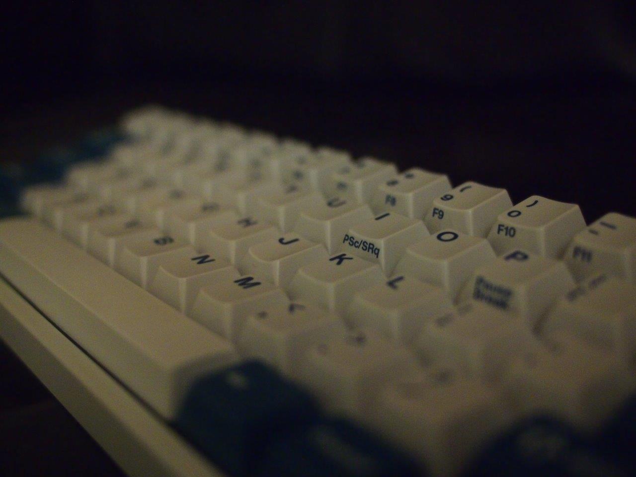

So I got the Dry Rub (sounds like barbecue!) transfer paper and the Water Slide transfer paper and had a go.
The dry rub turned out to be a bust, because there are so many layers and backings that you need to peel off each decal, and it's REALLY hard to do with something as small as a keycap legend.
The water slide transfers are working pretty well tho. I'm still experimenting with font sizes and positioning and whatnot, but I'll post some photos once I've got it done to my liking.
Offline zombimuncha
  • Posts: 331
Re: DIY front-printed legends?
« Reply #13 on: Sun, 20 September 2015, 13:54:32 »

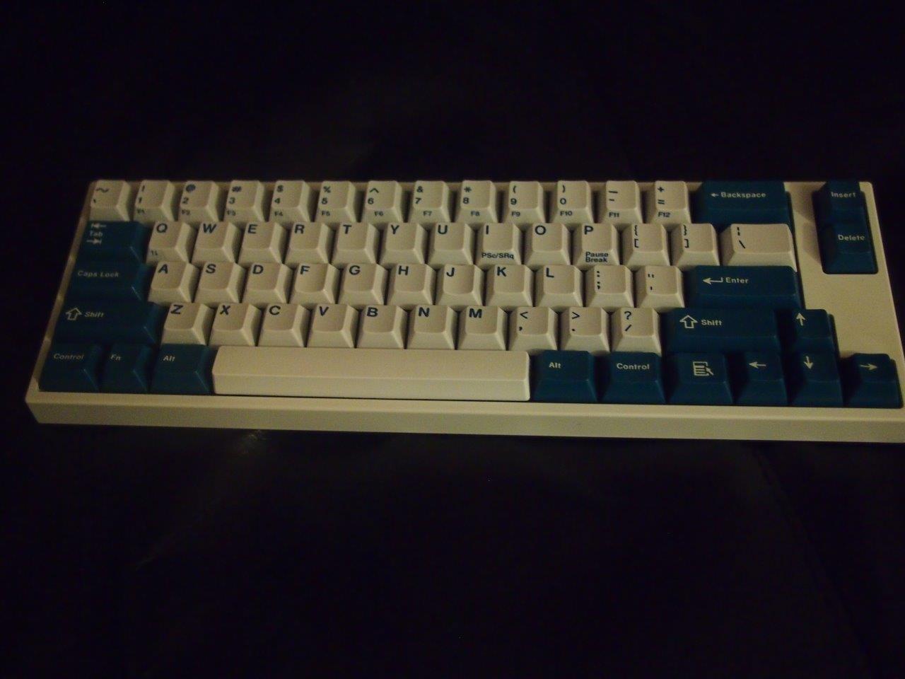

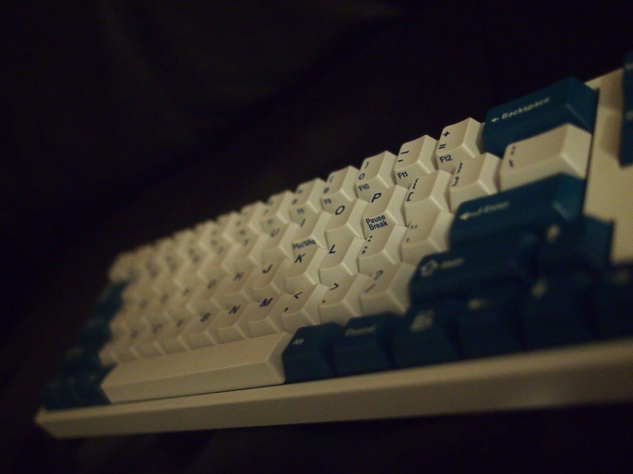

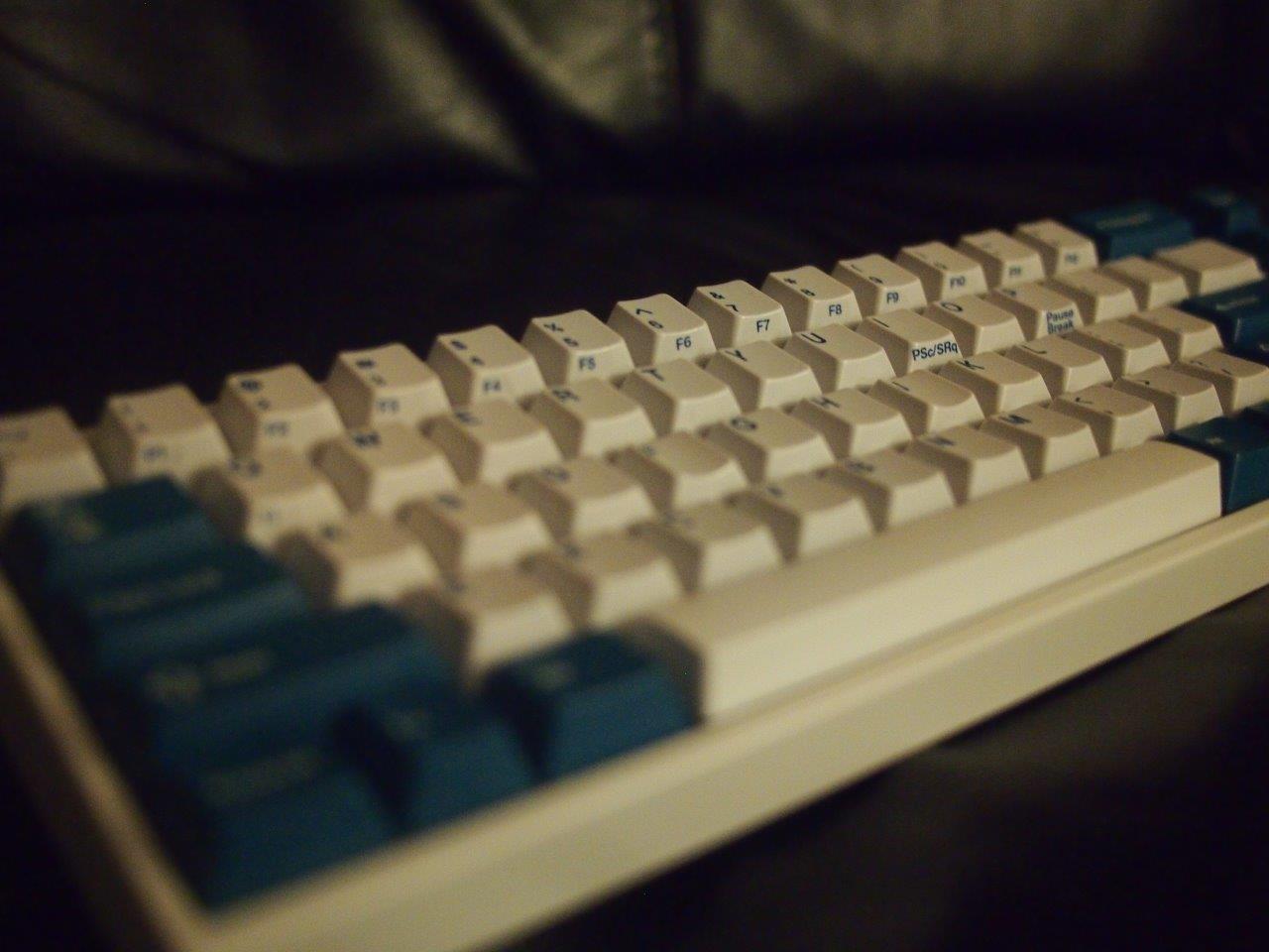

Here's the story so far...
Basically I think it looks great. I'm still faffing about with font weights and positioning. Obviously the PSc/SRq is too wide / too bold, and if I change the font there I'll need to change it for everything else too. Currently using Helvetica Rounded, which apparently only exists in Bold. I guess I'll need to get the font more like on the text mods instead of the alphas, which is a bit lighter but still rounded. It's hard to find the right font!
I kinda almost like the double line look shown here on Pause/Break, but I'm probably going to go with Pus/Brk or Ps/Bk anyway.
I'm also in two minds about the alignment on F-Row. Originally I liked the left-aligned, but now I'm leaning more towards centered. I'll probably change my mind a couple more times after "narrowing" the font.
The front legends on the mods are going to be more difficult if not impossible. You need to either have your printer print the exact colour of the legend, and normal printers don't do white, or use white transfer paper and cut out exactly around each letter - not gonna happen!
Here are some pics. Tell me what you think. Especially regarding the font choice and the alignment!

Still looking for feedback on the positioning and font choice.
Does anybody think:
Pause
Break
...is a good idea instead of Pus/Bk ? Does it look cluttered?

I like your stack top & bottom
Pause
Break
If Pus/Bk my brain needs time to think.. what is Bk? ... I like glance and spam :D
