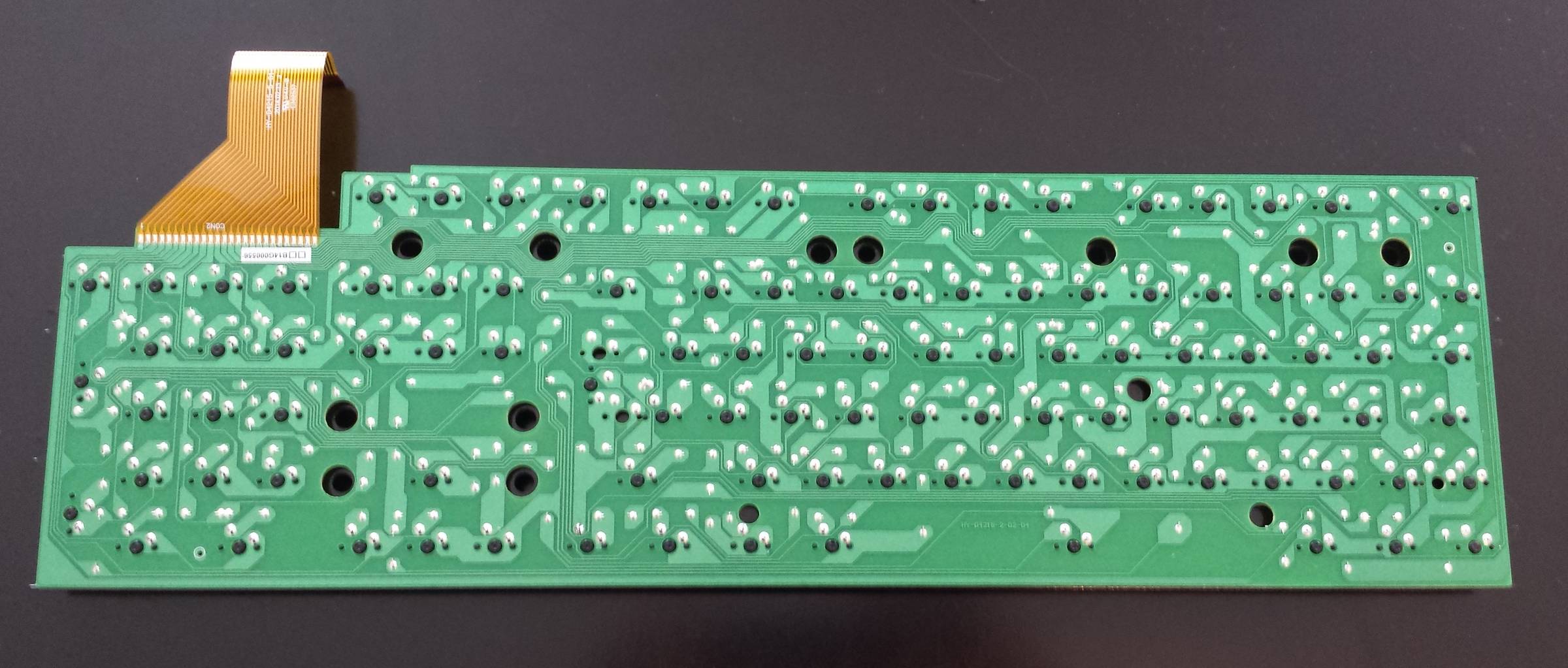

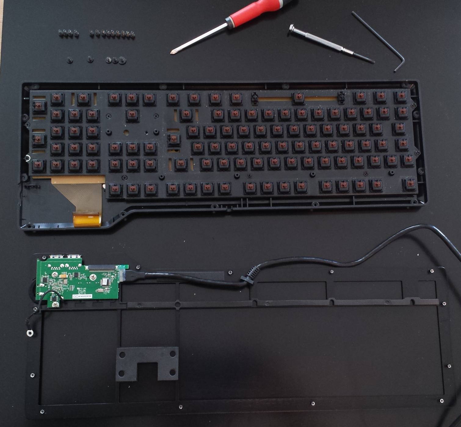

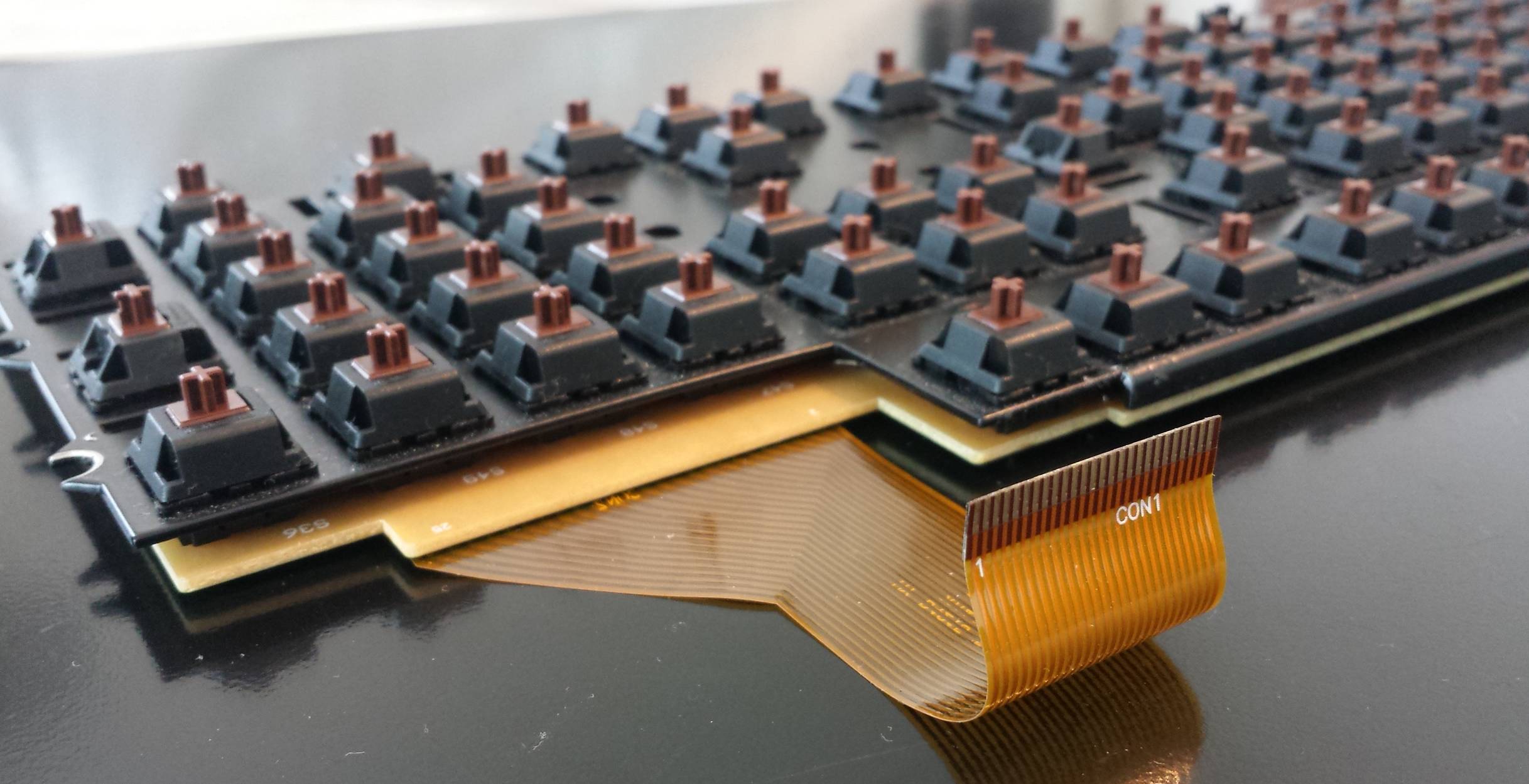

I started to tear apart my Das Keyboard, here are some photos :
The PCB is simple sided, shouldn't be too complicated to reverse engineer :
First caveat, I will have to unsolder all switches in order to get the space stabilizer, the small bar is between the plate and the PCB :
Second issue, I need to find a FFC cable with 26 wire to connect to the controller board as I don't want to destroy the original PCB. This part doesn’t seems to be very common...

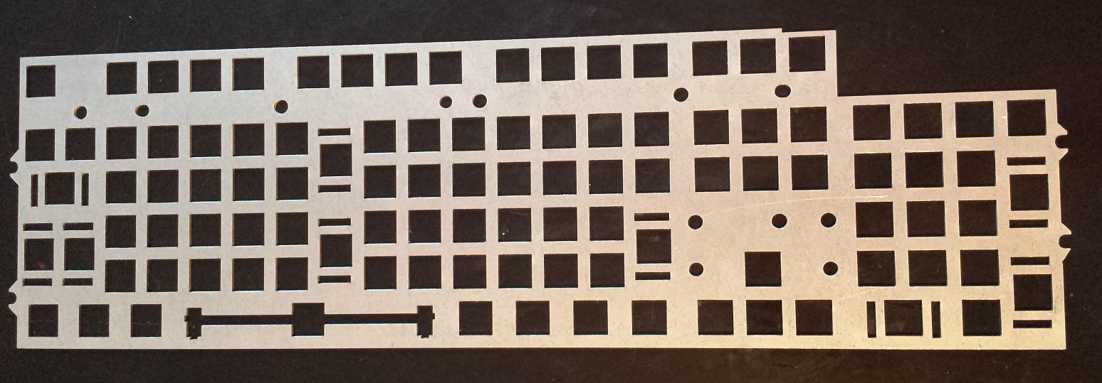

I almost finished the design of the plate, I'm about to ask a quote at Big Blue Saw.
But which material should I choose ? "Stainless Steel T-304" or "Cold Rolled Steel A366" ? The price is approximately the same...
Thanks !

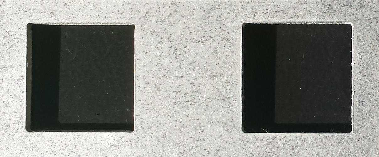

I finally received the plate made by Big Blue Saw :
The overall cutout is good, but there is a small bump on the side of the cut (left photo) that make each hole too small by 0.2mm.
I had to fix this using a file (right photo) so the switches can fit.
Did you have this kind of issue ?

looks nice. When i got plates from bigbluesaw I didn't really have that much of a problem but i did clean up  every switch hole with a file anyways since there was a little more tapper in the cut then I would have liked making them all a little on the tight side but it didn't take that long to do for my plates.
you only need to desolder the space bar switch to get that out.

Thanks for the tips ! Anyway, I had to desordier everything to read both side of the PCB.
I finally received all parts, It's time to build it !
Here is the comparison between the original plate and the new one :
.. and he original PCB with the new one :

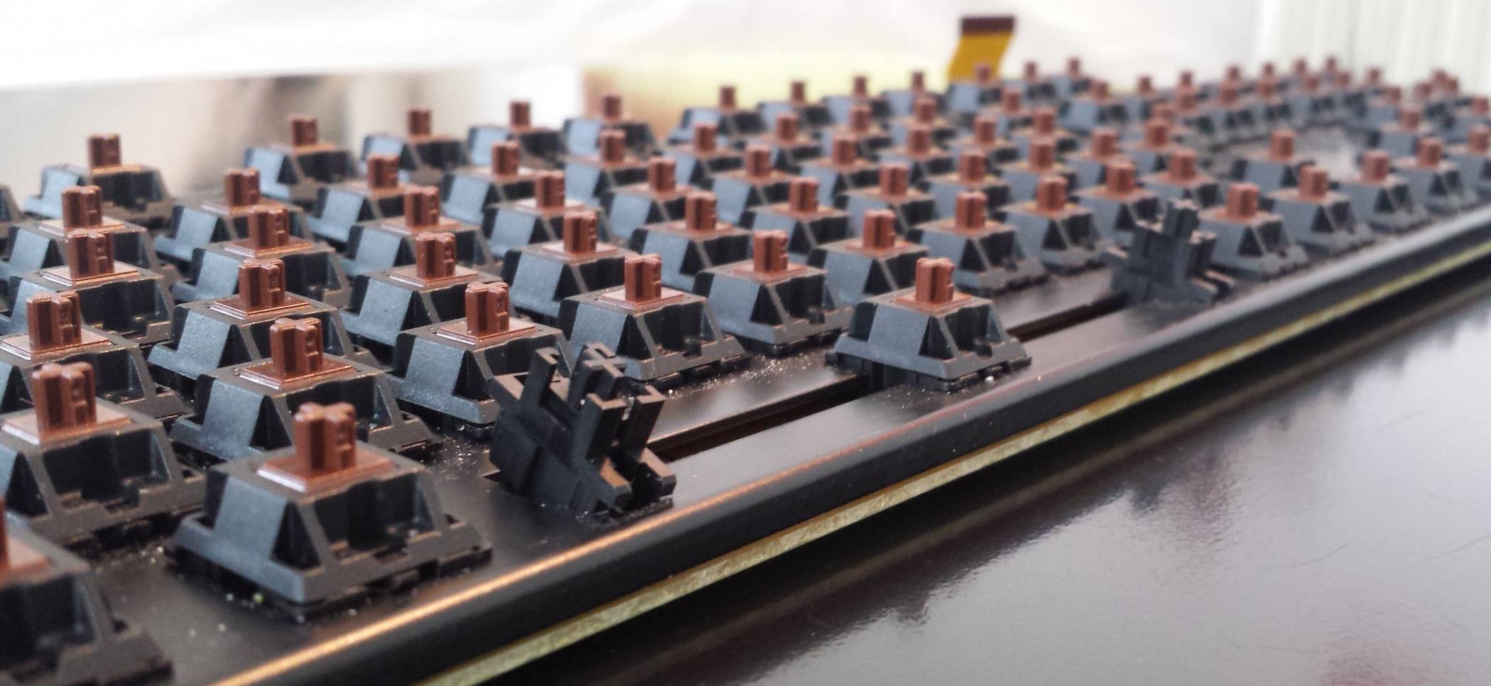

I'm filling it with White MX and some Brown for pinkies. (and 3 Green for fun)
It's working perfectly fine, but the sound is slighly different from the original one, the plate is resonating a little bit when I kick it.
Thanks you all for your help !
